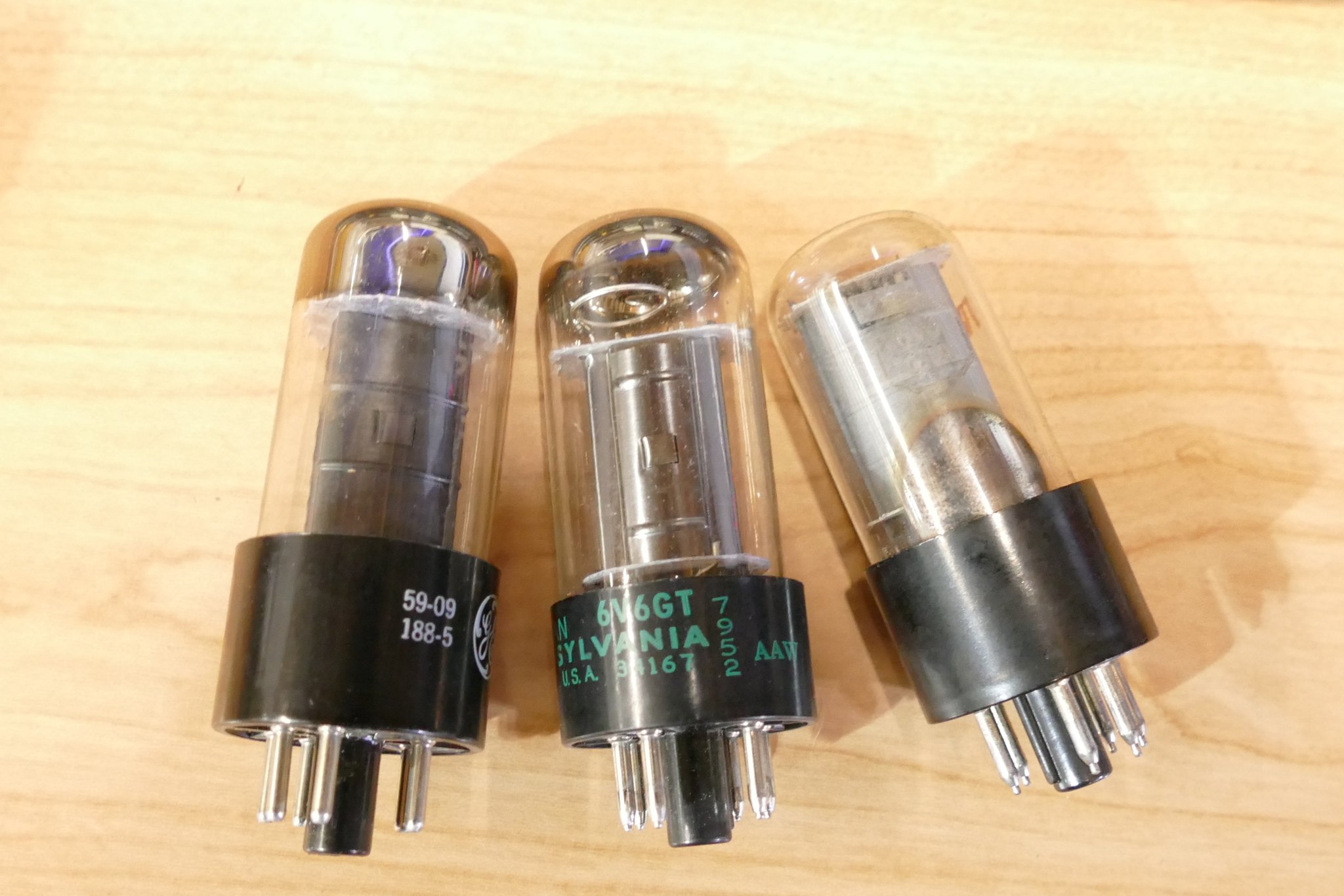

A large in difference in measured temperature is possible in different tubes that are running at exactly the same amount of total dissipation, especially when measuring from the top. You are attempting to measure the IR radiation from an "emissive body through glass of unknown transmissivity with a varying amount of gettering on the inside. I grabbed three random 6V6 types from my tube box selecting three tubes from different sources. All three have different plate structure, size and shape. Two are black and one is grey. The emissivity will vary with plate coating, and thickness.
Let's just assume that you have a large quantity of 7C5's and they are all the same. Are they all built exactly the same inside the plate? The point of highest thermal (IR) radiation is from the center of the broad side of the plate and a perfectly made tube should measure the same on either side. Virtually NONE of them will measure the same temperature even when biased up to identical levels of power dissipation. Few will measure the same from side to side since they were likely hand assembled many years ago and banged around a bit since then. Some of the old RCA tubes with black plates have obvious issues with the coating since there are light and dark spots and even a few silver areas in some tubes.

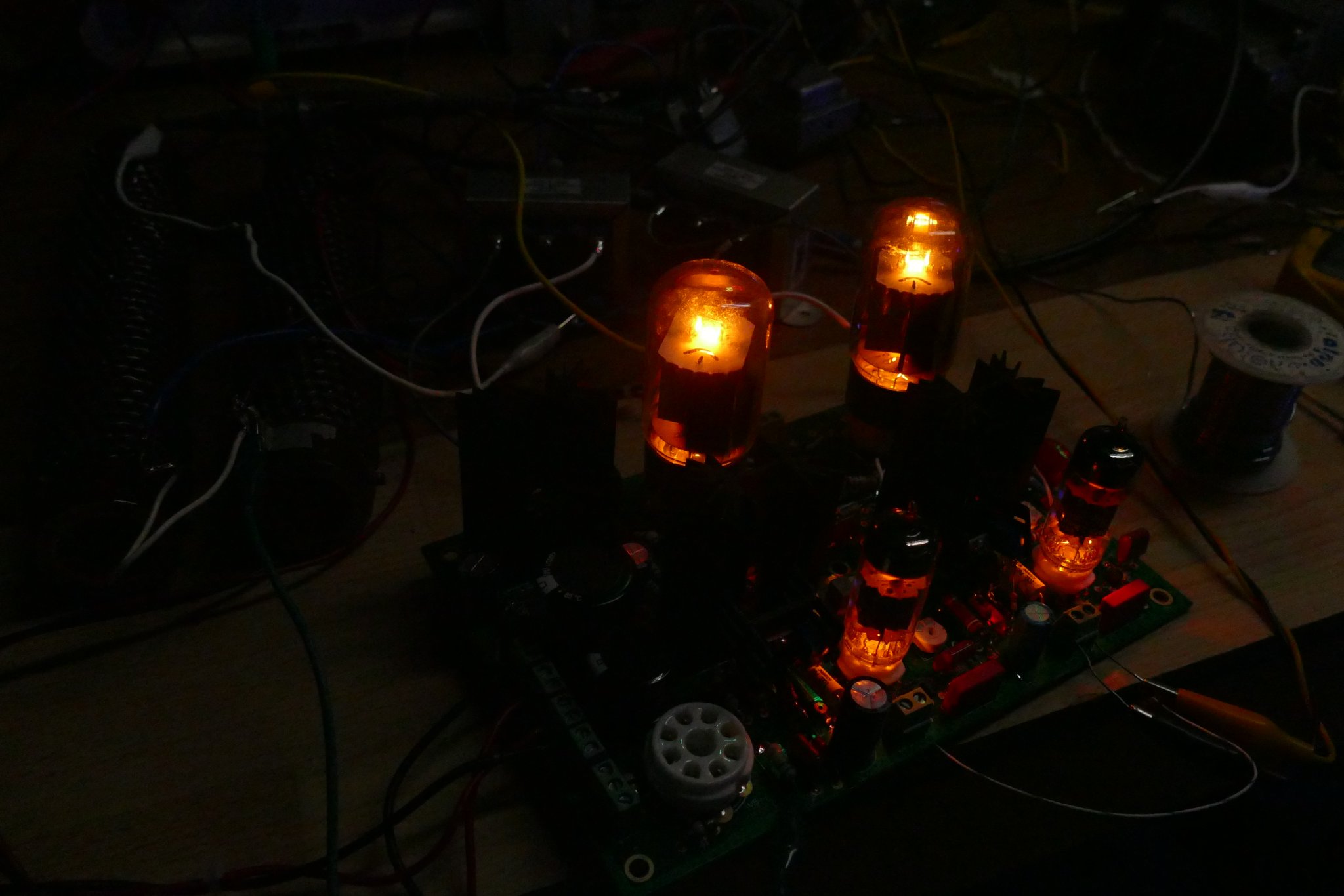

I do not attempt to match tubes by temperature. I use the IR gun, and my eyes in a dark room with the air circulation turned off to find the tubes that do the best job shedding heat WITHOUT developing hot spots on the plate. Concentrically made tubes like the 6AQ5 are the worst. They are rated for 12 watts od plate dissipation though very few can handle 10 watts without some redness on the plate somewhere. Some are so bad that a red spot will appear in the middle of one side at 8 watts or so. the plate is so close to the glass that there is not much power capability between red spot and hole in the glass.

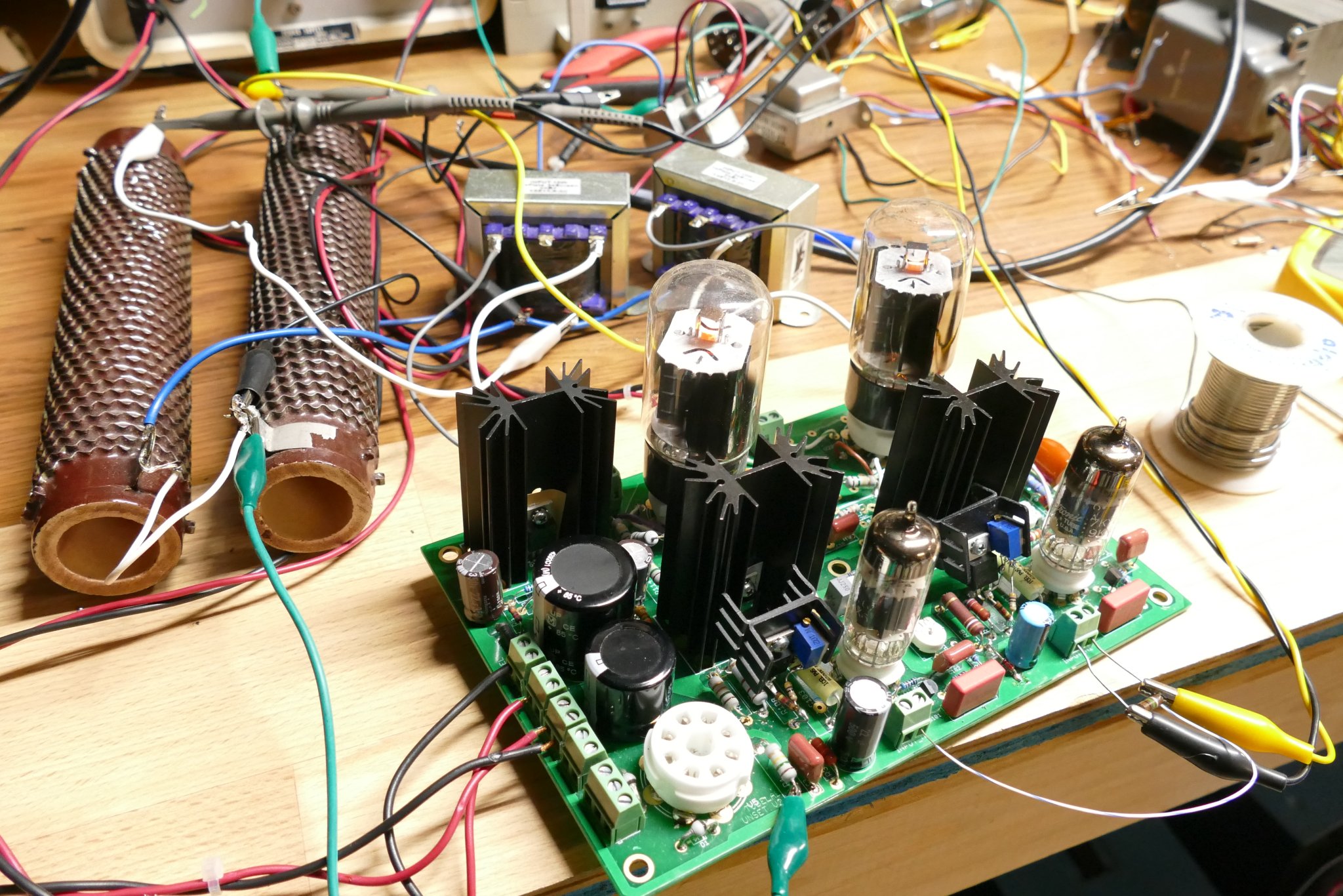

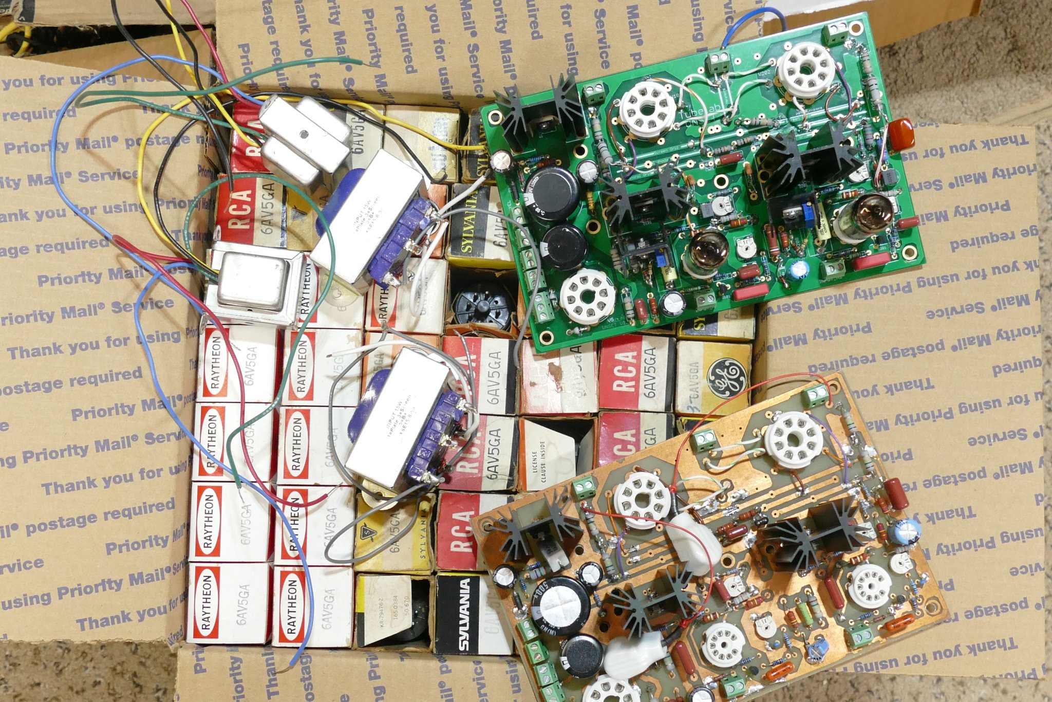

I recently revisited a nearly 20 year old experiment with some 6AV5GA tubes. In order to get consistent results, I got out a box full of tubes and rigged up a test setup with an UNSET board. I then tested a bunch of tubes to pick a few that would dissipate 20+ watts with even heating on both sides and no hot spots. All were tested at identical heater and screen grid voltage. The screen current at 20 watts (spec is 11) of plate dissipation was checked for outliers (I found one tube that sucked too much current compared to the others, so it went into the trash). The grid voltage to achieve 20 watts was recorded for each tube and matched pairs were made by selecting two tubes with identical internal construction with the closest grid voltages. Tubes like the 6AV5GA and the 6V6GT had long production runs with many changes, and the brand name on the tube does NOT indicate who actually made it. Two identical Sylvanias that were actually made by Sylvania were selected and used for audio testing.
