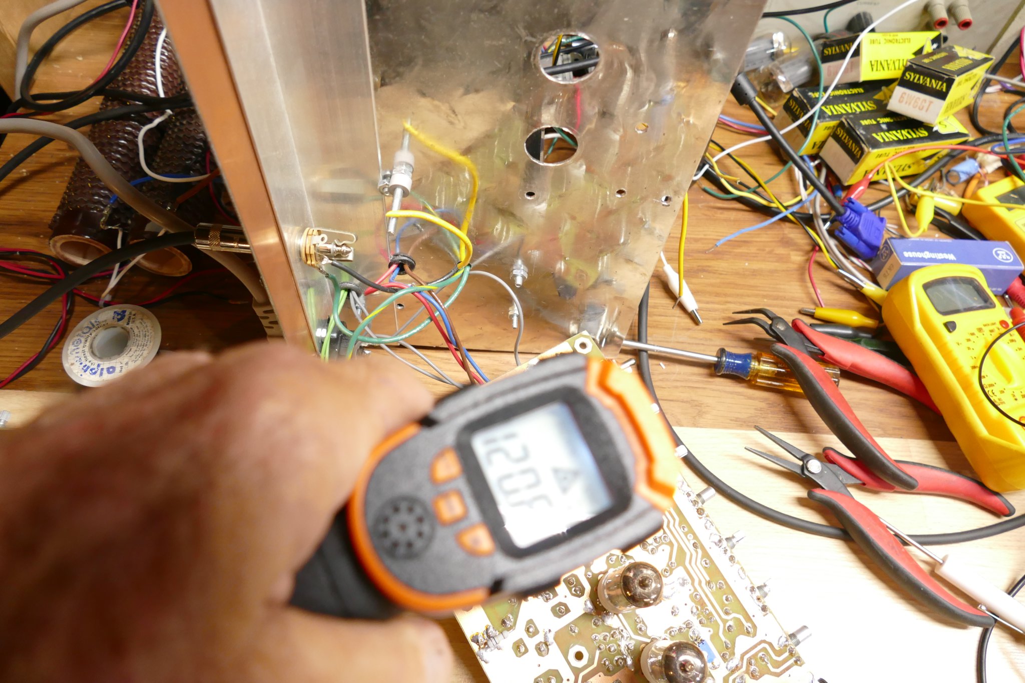

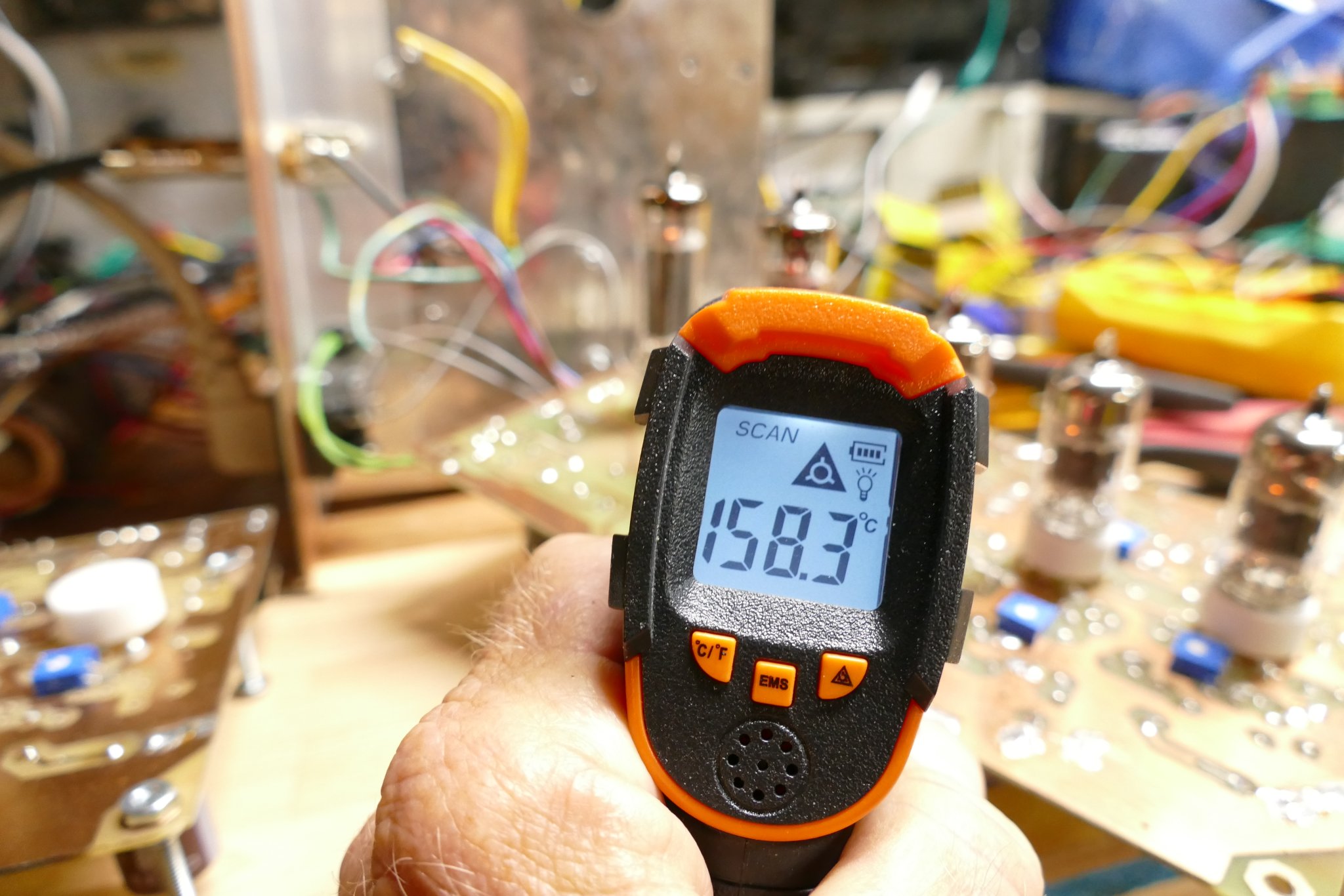

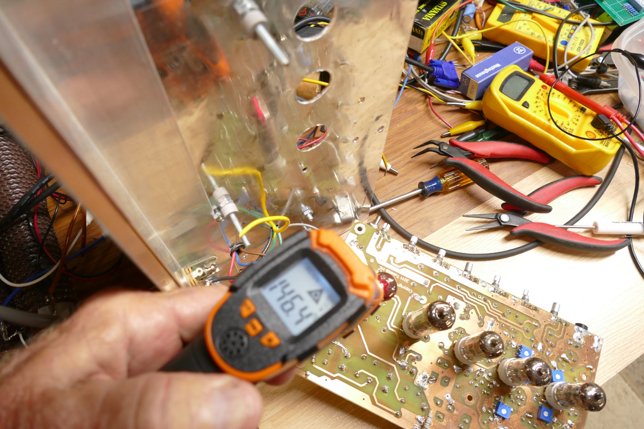

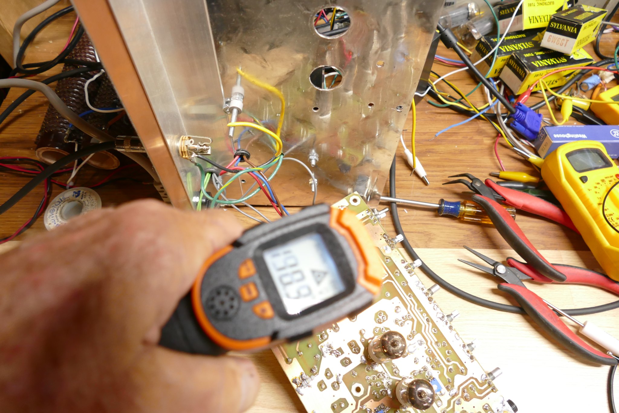

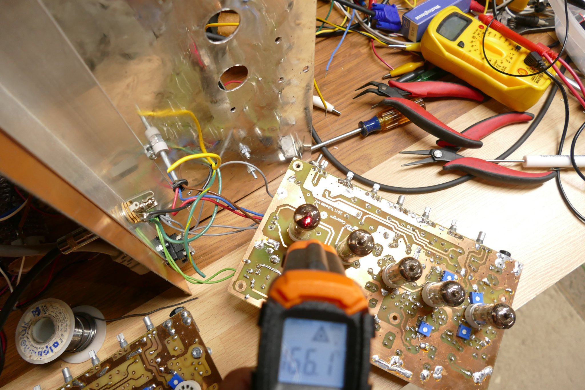

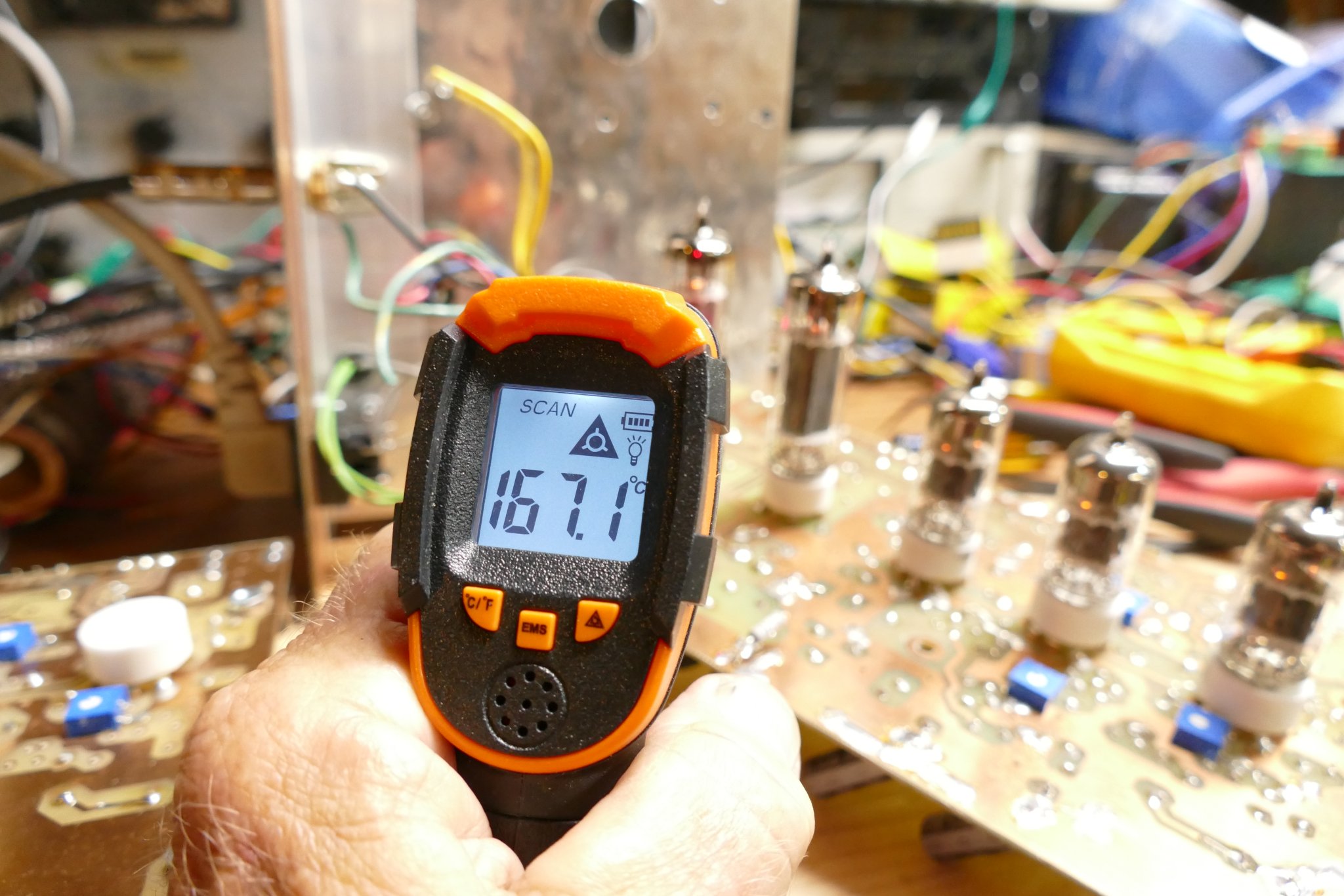

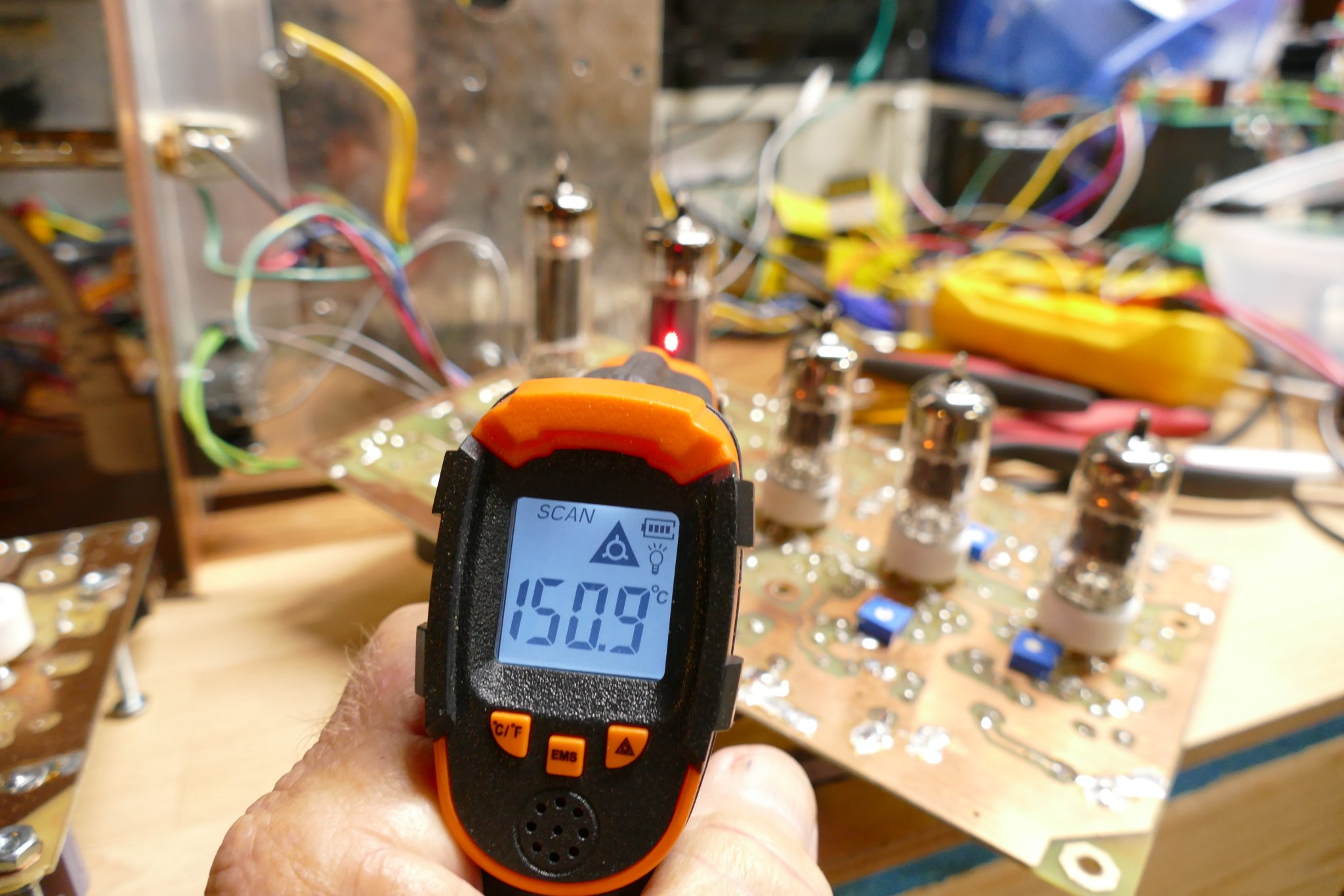

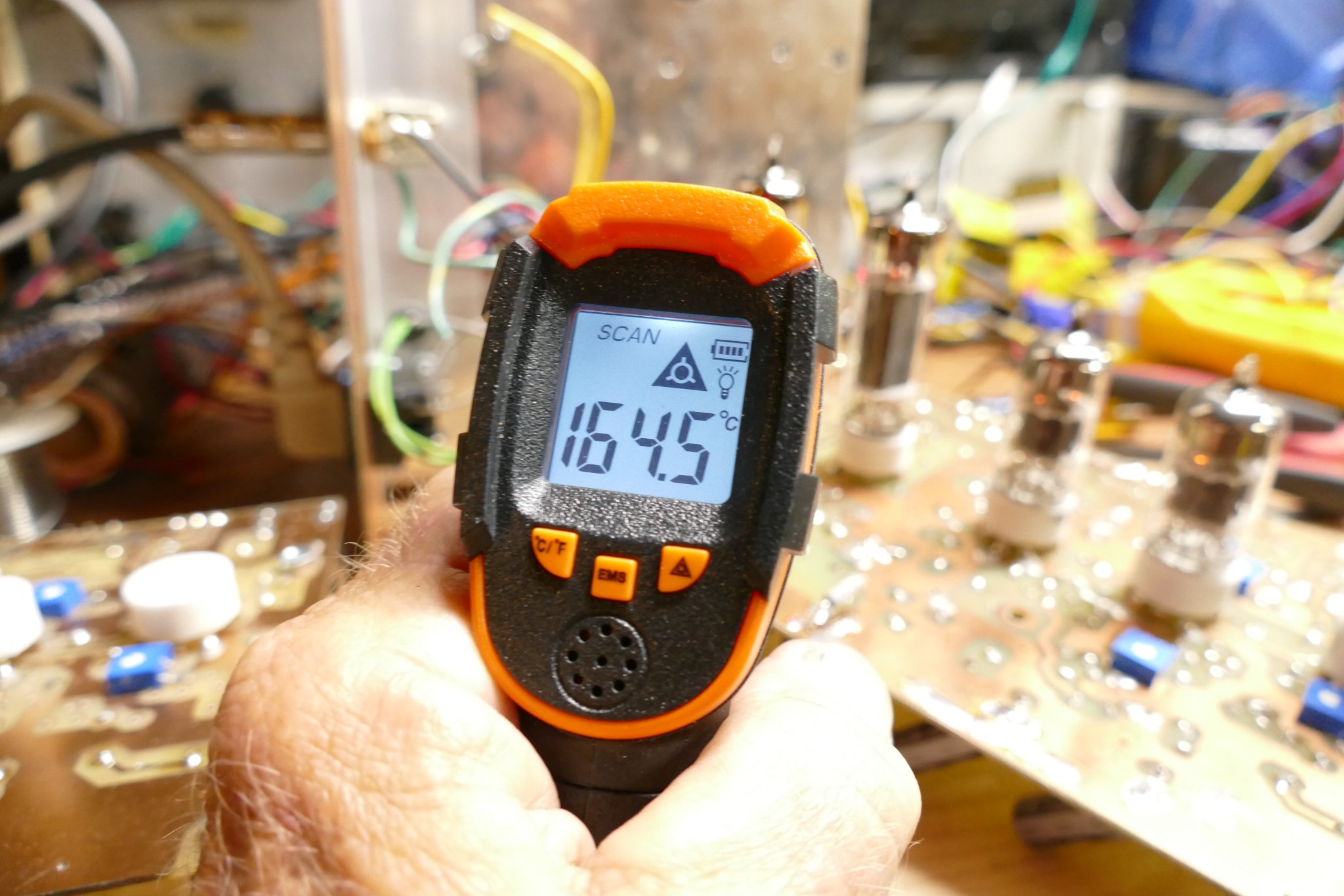

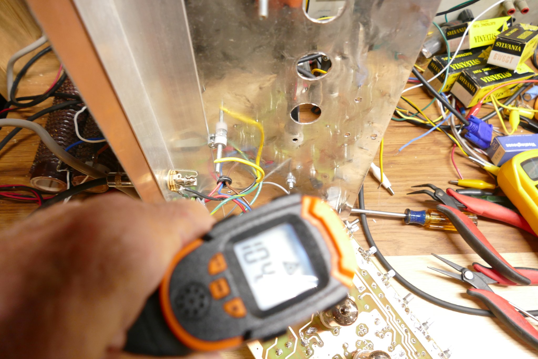

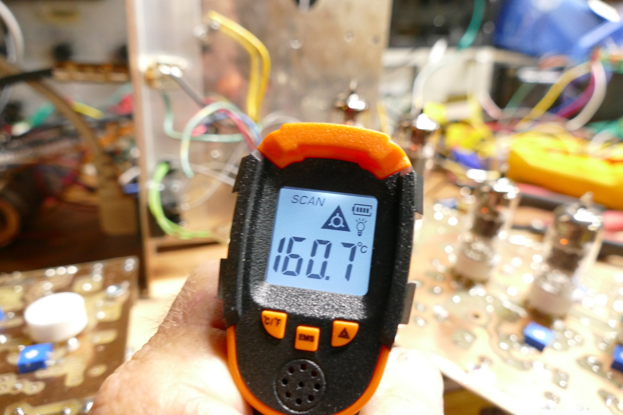

I have a laser guided temp gun. I find it reliable for determining the temperature of a black heat sink and for determining the approximate temp of a large TO247 MOSFET that's bolted to that heat sink. Due to the uncertain emissivity of a tube's plate and the transmissivity of the curved glass the IR must go through, I find it rather useless for most tube measurements. Nevertheless, I have a guitar amp that I made 13 years ago dissected on the bench for repair, so I fired it up and collected a bunch of random numbers.
It would appear that the tube on the right is hotter on the top, but the tube on the left is hotter on the side of the plate, So will the real hot tube identify itself. This amp is cathode biased with a shared resistor, so both tubes get the same VOLTAGES. The actual cathode currents are unknown. The tubes are UL84's / 45B5 which are 6CW5's with a 45 volt 100 mA heater.
Note that the readings from the tops of the tubes are the lowest and most random. This may be different with flatter clear top tubes. I may or may not decide to point the gun at the UNSET board when I get it back on the bench. It currently has some clear top 6AV5GA's in it which are being run at nearly twice the published dissipation ratings.

Since the numbers vary by at least 10 C in repeated trigger pulls while hand holding the gun, it looks like clamping the gun and circuit board such that no movement occurs may improve repeatability. Testing all tubes in the same socket is required, but physical differences from tube to tube will likely still be a major error source.

I've used my IR gun like this for curiosity and find getting repeatable temps from the same tube very difficult. The problem is the absolute distance and area has to be perfect. My thermometer has a 1:8 spot area/distance averaging sensor. If you are holding it by hand you must be very steady and at the exact same distance on every trigger pull. The laser pointer helps but that thing gets reflected and is hard to be certain it's hitting the same spot and then there is a period of computation delay that takes place also. If you are a small difference in distance between trigger pulls you get a larger or smaller target area that gets averaged. So if you want to use the IR gun to weed out obviously over or under dissipation, to find which tube in a common cathode resistor pair or group you have, it could be a tool for that, but you also have to keep in mind that the hot tube may be the good tube that is carrying the load for its weak partners. Then you have to check each grid for leakage, too. And the whole idea of the value of ''matching'' is generally poorly understood by most casual DIYers. Too many have a tunnel vision focus on perfection and uniformity to give a tube a break.
The IR gun attempts to guess the temperature of a solid object by measuring its IR radiation over a certain area of the IR spectrum. The numbers generated in this particular unit ASSUME a 98% emissivity which is close for a black heat sink or a black tube plate. The glass has some obvious absorption since it gets real hot as well as some diffusion.
