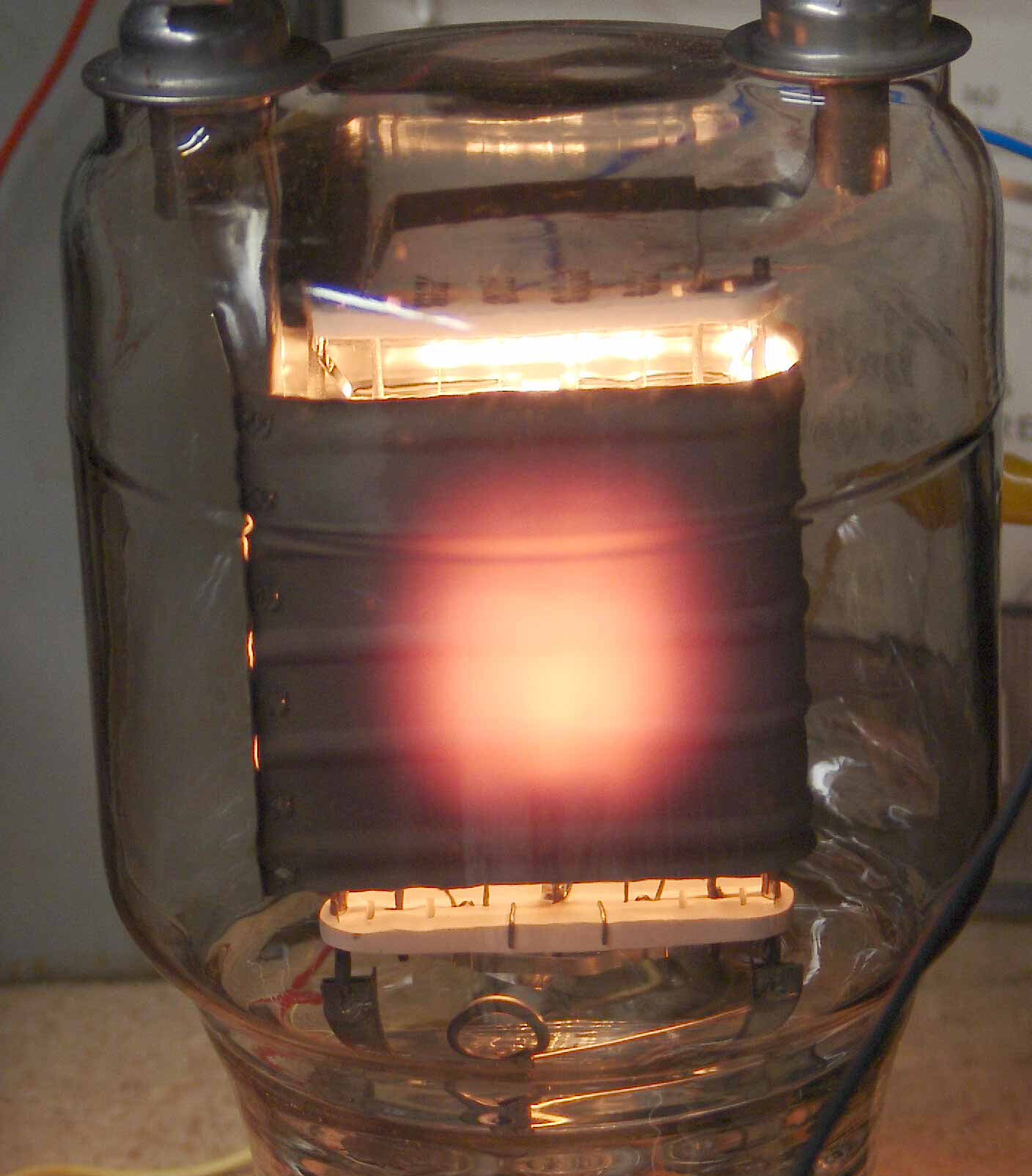

Maybe those who DO use a tube from an AM radio station just choose to broadcast at a lower than intended frequency. Note the glowing 833A in the background behind the Lexan "oops shield."
Thue 833A data sheet does discuss the heat in the metal / glass interface around the pins. That is the area of concern on large glass transmitter tubes. The coated plate is the getter and redness is recommended for proper operation. This tube was dissipating about 400 watts at idle and cools off when the guitar is cranked to way beyond eleven! One can guess the vintage of the photo by the CRT TV and computer monitor. It's from 2003.

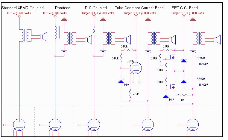

There is an interesting article on diyAudio projects that describes different output configurations. Some may find germane to the topic in this thread.Everybody, Kay Pirinha states power tubes use a plate resistor, even stated internal plate resistor. He does not know the difference in a power tube and preamp tube.

Tubes are normally designed for a specific purpose and the data sheet will mention that. But you, as a designer, can use it any way you want, if you know what you are doing. You can (and many do) use, say, a voltage regulator tube as an amplifier output tube.
Apart from the basic fact that if you don't have any anode impedance you have no signal output so that's a pretty useless circuit.
For an output tube in a headphone amp, an anode resistor might well be a good solution.
In larger power amplifiers you can do better with an inductive load (like in a single ended amp) or an output transformer in a P-P amp.
So, saying that power tubes do not have anode resistors is a very narrowminded view which greatly restricts your options.
A similar situation exists in the solid state world. For phono preamp input stages you normally want a transistor with very low Rbb for very low noise contribution. It just so happens that many power transistors have extremely low Rbb and it is not unusual to see a phone input stage using a large power transistor.
Dogmatism is never a good idea if you want to explore design space. Keep an open mind and venture into the world of audio design!
