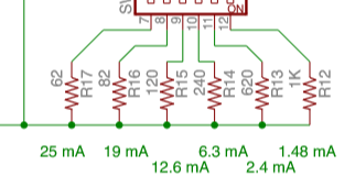

Hi reddish75,
I used 1/2W resistors for the collector and base as I recall. It's more important to get the 0.1% resistors than a high wattage. The current setting resistors were all 1/4W, most 5%.
The capacitors are approximate, you can use whatever you have as long as they fit properly.
The header strips must come from a proper supplier. I tried ones from Ebay and they really don't work. I threw them out due to difficulties with inserting transistor leads.
-Chris
-Chris

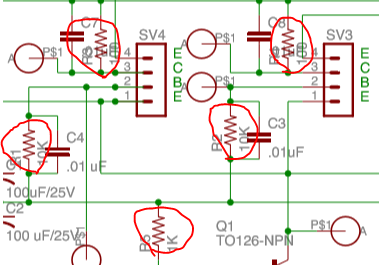

Thanks Chris,
Which values were settled on for the collector and base resistors, from the schematic i noticed 100r for collector and 10k for base but from posted pics i see some examples using different? when you say current setting resistors you mean these (please see pic) These dont have to be 0.1% just the collector and bias resistors (please see pic 2)
Hi reddish75,
Differing resistor values can be used, but consideration to how your instruments will operate at those voltages need to be figured out first. For example, I use HP 34401A meters and could use 1R0 collector loads, but most people wouldn't be able to use the jig effectively. If you have the specs for your meter, figure out the possible error at the voltages you expect to measure. That alone can answer what values to use.
-Chris
I picked the values to have a minimal voltage drop that most meters could show, so 100R0 for the collector resistors. If 1R0 was used, the math would be simpler, but most meters would either be wildly inaccurate or wouldn't show more than 1 decimal place. Same thing, wildly inaccurate. The same thought process was used for the base resistors in case you wanted to measure base current. From that you could figure out transistor beta under those conditions.Which values were settled on for the collector and base resistors, from the schematic i noticed 100r for collector and 10k for base but from posted pics i see some examples using different?
Correct. You could use 1% resistors here if they are cheap enough. Many can be had for $0.15 each. Dale resistors would run about $0.83 each. They wouldn't break the bank. Just whatever you do use, do not use junk parts and carbon film are okay here.when you say current setting resistors you mean these (please see pic) These dont have to be 0.1% just the collector and bias resistors (please see pic 2)
