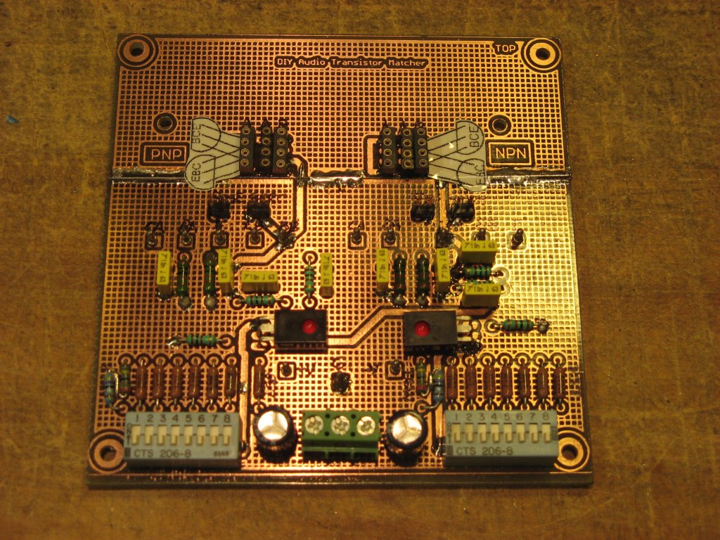

Hi Mike,
Please note that most transistors suited for diff pairs have maximum collector currents of 50 mA to 100 mA. Testing should be done close to the actual current seen in the application. That would mean 1 mA to 2 mA tail current. I've been using 3 mA because the transistors settle faster. It might be instructive to try tail currents of 10 to 20 mA. The stock tester will support those current levels, but I didn't envision anyone would actually run the pairs that high. Keep an eye on the CCS pass transistor temperatures.
I think the "thermal cap" will work well. You might even be able to leave them on the PCB. That would be easier to deal with as there is a minimum of wires and just a pair of component parts, the tester and the heater. Power resistors are made that look like TO-220 transistors, and they would mount with a screw and grease to the aluminium block securely.

You can use this matcher for both. Vbe is not an indicator of a match. It is afterall, a diode. For transistors, you have to match beta, but as I said, this does both.

I have never done the test, but i do wonder about the correlation of Vbe vs hfe matching of devices. I assume as Vbe becomes closer matched, so would hfe?

That might be true for devices on a single wafer, but it ain't so in normal use. I tried, because it is easier / faster. The beta test does work.
In real diff pair circuits, the Vbe will probably be close anyway, but at worst it would causes an offset of a couple mV. When Beta isn't equal, your shifts will be more than an order of magnitude greater.
The use of degeneration resistors allows you to vary the currents in different arms of a multi-element current source, or to force current sharing in diff pairs. They also make the transfer characteristic more linear in a diff pair.
If you build a jig, you can test both as the jig also allows you to measure Vbe too. You can whip one together on perf board in 20 minutes or less, which is how long it took me to design, layout and build the first one on perf board. The only rub is to get tight matches on base and collector resistors. I ordered (and matched more tightly) 0.1% parts for mine. That was to be certain the jig wasn't throwing in errors of its own.
Either that, or you can argue the point endlessly, but building one and trying it for yourself might be easier and faster. I don't intend to debate something I tested for already.

The circuit they describe to drive the heater is pretty cool, but I think one of these cheap e-bay thermostats will do wonderfully. 0.1F resolution.
Yeah, I don't think the exact oven design is applicable, but it confirms what we're finding here. The crystal oven is designed to keep just one device—the crystal—at a certain temperature. The transistor matcher has the additional requirement of keeping two devices at the same temperature. The heat-conductive die, surrounded by insulation seems to be the solution.
That's certainly an interesting looking PCB!
I made adapters that fit into the wider holes for testing SMT's and dual packages. I need to redesign them as they are a pain to use. Keeping contact with surface mount is a real PITA.

Chris, have you considered using a pair of neodymium magnets to sandwich the surface mount transistor with the socket?
Hi Chris,
That is an interesting idea. I was thinking along the line of hold down clamps, but adding a little foam to your idea might really do what I need. Good thinking!
