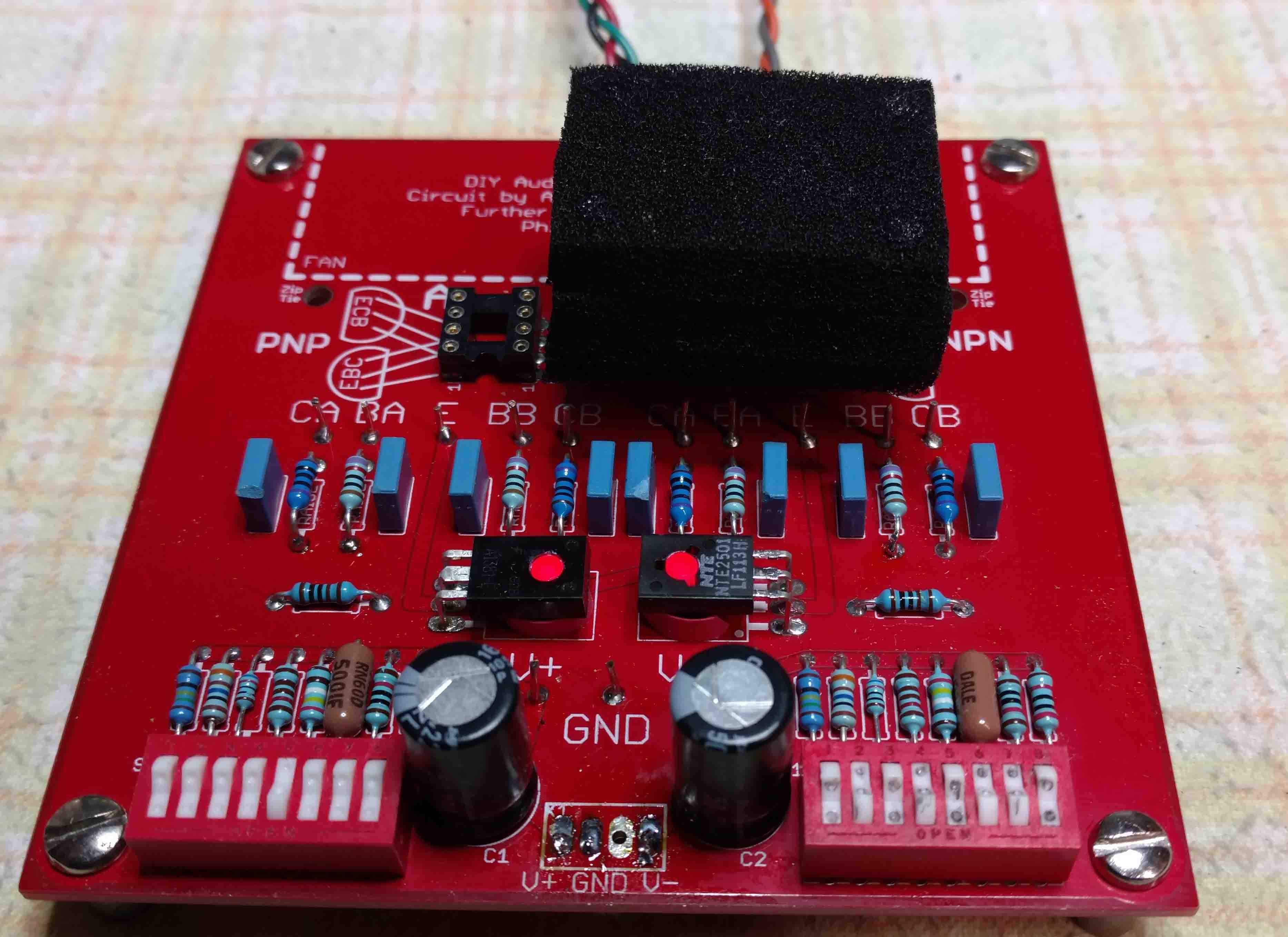

I built a beta matcher rig based on Phloodpants next-to-last board, the one with standard socket spacing, and have been experimenting with it. I have decided that I like Anatech’s approach best, i.e., thermally coupling the two transistors under test and then insulating them. I also like to place a cover over the entire board to eliminate stray breezes across the components on the board. And by the way, I did a lot of experimenting with a 120 vac box fan, overwhelming the rig with convective cooling, and while I still see some benefits, I prefer the “thermal coupling with insulation” approach. One reason is the fan tends to force everything to ambient temperature. I have two issues with this: first, that is not the condition the transistors will operate at in the amp; and second, you are limited to the temperature of your surroundings, which makes it difficult to recreate conditions for experiments done on different occasions.
One of the questions I’ve had all along is how much the transistors self-heat or warm up during testing. I calculated the heat generation at the recommended 3mA test current and came up with about 38 mW. (12.5v x 3.0mA). This is similar to an LED operating with a Vdrop of 2.0 volts and a current of 20 mA or about 40 mW. We don’t think of such an LED as getting particularly warm, but in their small TO-92 cases, the transistors will definitely warm up somewhat. I’ve tried using my Fluke IR gun but the transistors are just too small to get a meaningful temperature reading from. In any case, they will run above ambient and therefore be at least a little closer to their eventual operating temperature inside the amp.
It would be interesting to pursue calculations for heat dissipation for these transistors, because then we might be able to estimate tail currents that would help emulate the actual operating temperature of the transistors in the amp. However, I see two problems with this: first, we don’t generally know the internal amp temperature (and it probably doesn’t hold still for us); and second - and I think more importantly - each beta matcher test rig will be used a little differently in terms of thermal coupling and insulation (or fans, or whatever) , so we probably wouldn’t be able to establish a meaningful relationship between tail current and device temperature.
As I said earlier, I am now a fan of the thermal coupling method (pun intended). Based on this, I came to the conclusion that the two main goals of mounting the transistor pairs in the test rig are:
1) to mechanically and thermally couple them so that they remain at the same temperature; and
2) to shield them from stray air currents to minimize scatter and drift.
A lesser (but I think important) goal would be to protect the board from stray air currents to keep the system as stable as possible. This was accomplished by the use of some of my usual bleeding edge technology: a Tupperware dish covering the rig.

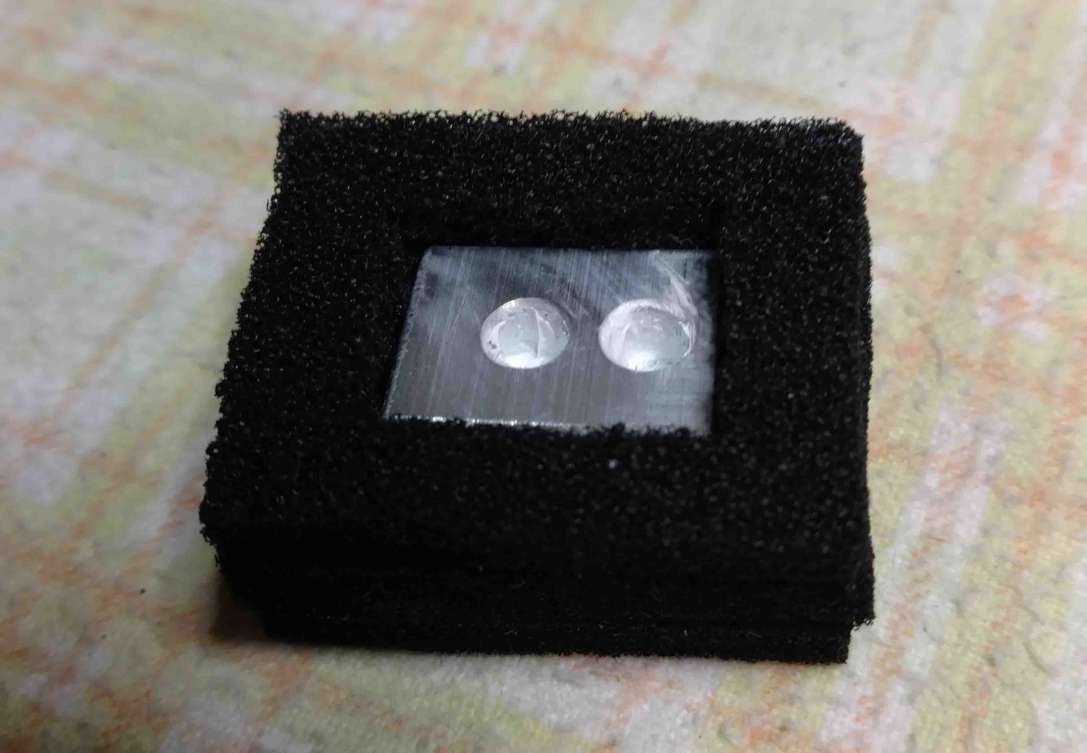

Going back to points 1 and 2 above, I built a simple aluminum cap that mounts onto and surrounds the two transistors and establishes thermal equilibrium between the pair. It’s deceptively simple – I used a very small block of aluminum measuring about ½ by 5/8” by ¼” thick. I drilled two holes through it using #10 bit which has a diameter of 0.193”. These two holes were spaced at 0.295” center to center, which is the distance between the two rows of the sockets. I cut a thin piece of aluminum to the same size and glued it to the first piece so that it serves as a cover. This is important because it provides flat bottoms to the holes and allows the tops of the transistors to sit flush against them. I super-glued only the corners so that I could put some thermal past between the two pieces.
To use this new thermal cap, I put a generous dab of thermal paste (damn, I hate working with that stuff) into each hole and gently pressed the it down onto the transistors. (BTW, I very lightly countersunk each hole to help it slide onto the transistors.) If I use the right amount of paste, I can look underneath and see a little bit squeeze out. This means I have paste filling most or all of the void spaces between the transistors and the cap, and thermal contact should be excellent.
To insulate the thermal cap, I carved out a piece of foam and used this to cover the aluminum cap. This should help to stabilize the temperature of the whole thing.
BTW, some of you are probably thinking, “Wow, I could do this with copper (with about twice the thermal conductivity of aluminum) and it would work even better.” True enough, but mine was a quick and dirty prototype built as sort of a proof of concept. So far it seems to be working well. It was very simple to make and I encourage others to copy what I did and see if they get similar results. Copper may work better and I may give that a try. One thing I plan to try is to mount a small thermocouple in the thermal cap so that I can monitor temperature. This might allow us to investigate temperature effect and permit even closer matching.
Results? Using a pretty well matched pair of 2N5551’s, which come in at just under 1 mV, the rig stabilized within about a minute and sits like a rock. I use a Fluke 87V multimeter in high rez mode for the collector voltage and I can get pretty good accuracy. I will do some more work on this new piece of hardware and like I said earlier, if anyone thinks it might be a good approach, please build your own and report back with your results, along with any improvements you come up with.

I'm rescinding my previous findings regarding temperature tracking. I was NOT getting the two DUTs heated up evenly with method I was using. It's not enough to just thermal past and shrink-wrap.
I did another experiment, and Chris, your point about needing insulation around the transistors is confirmed and point well taken. Diego Mike thanks for your work on this too!
Thermal tracking of beta v temperature is—in fact—much better than my flawed experiment with the lamp showed. I had the transistors thermal-pasted and shrink-wrapped, but that doesn't stop one device from getting warmer than the other. The cases of the transistors are still exposed directly to air. As mentioned, air currents, radiated heat sources, and uneven heat-sinking from PCB traces can all cause imbalances.
So, I took a pair transistors that matched well via the fan method, and put them in this rather ludicrous-looking contraption. The transistors are thermal-pasted and shrink-wrapped along with a K-type thermocouple. I wrapped the DUTs in a few layers of cotton, and fitted a 10mm socket over the whole thing. The idea being that the thermal mass of the socket keeps the heat pretty even all around the DUTs, as the lamp heats the whole thing. The cotton insulation increases the thermal time constant, and provides insulation from physical contact with the socket. A smurf-hat of silicone tape keeps heat from escaping the socket. Now, when I apply the lamp, the thermal conduction of the socket should keep the heat pretty even all around.
Silly looking, but it seems to work! Look at this tracking.
That's going from room temperature, 22C to 60C in 30 minutes. Sorry, no graph of the temperature raise, but it was roughly linear.
They only differ over a 2% range, from room temp to 60C.
Here's the same pair, with the fan method, for 15 minutes.
The results are pretty close. This particular pair appears to be a match with the fan method, averaging just 0.25% positive, but at higher temperatures, they are off by 1.5% on average. The fan method does appear to keep the temperatures even, but the results are off because they are running so much cooler than in real life.
It also seems that there is a broad range of temperatures that are good to test at, but the fan method is too cool. Probably anything above 30C is fine.
It seems that having the insulation around the transistors is crucial. And I think having some kind of conductive metal thermal mass, a cap, all the way around is also a good thing, so that the transistors are surrounded by the same temperature from all directions. DiegoMike's contraption seems to do the trick as well, enforcing a common temperature through conduction.
It also suggests, that in order to keep these carefully matched devices actually matched in operation They should not just be thermal-pasted and shrink-wrapped, but they should at least have a layer of insulation, and perhaps a thermally conductive metal cap around the whole thing. I can easily envision scenarios in any amplifier, where one of a pair of matched transistors, happens to be sitting closer to a source of radiated heat like a heatsink. What my flawed experiment with the thermal-pasted-and-shrink-wrapped transistors actually showed, is that without insulation around the transistors, they will drift like crazy.
Perhaps we should be insulating and capping the transistors in our amps. I think a 3/8" copper pipe end-cap stuffed with some kind of insulation would be perfect.
