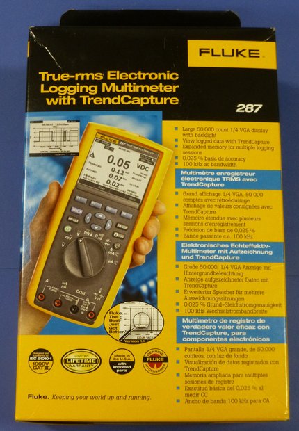

Thanks, yes I am using a Fluke 287 between collectors.
Honest question, what is the concern about VCE? That the beta changes with VCE? With a 100R collector resistor, the VCE is 12.6V, and with the 1K resistor it's 11.6V. Is that 1V enough to throw the beta value off? I can't seem to find any datasheets with a graph for VCE vs. beta.

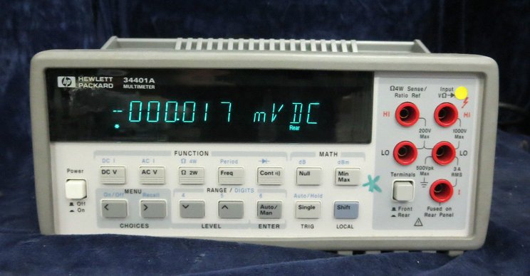

100r when used for 1mA of collector current gives 100.0mVdc
Any DMM set to 199.9mVdc will measure your two voltages with a resolution of 0.1mVdc. You can also measure the differential voltage between the collectors as a final check for matching.
I see nothing wrong, or inadequate, with using 100.0mVdc as the current measuring value.but your meter should be used as a null device. Hang it between the collectors and measure the difference (attribution) from post 52 by Anatech.
I agree that your measuring instruments do need to be better than the matching tolerance you are aiming for.

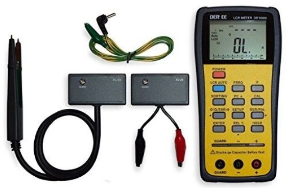

Yes, I matched the resistors as well as my DerEE LCR meter would allow. I'm using Dale RN55C.

Unfortunately, not true. In resistance mode you are using an internal current source that can drift (and they do). The meters I use have a basic DC accuracy of 0.05%. Those are my handheld HP / Agilent / Keysight meters. Resistance accuracy is substantially less and depends on the range and reading. To match these resistors, I typically use my HP 3457A, or my 34401A. They are used in 6 (1/2) digit mode with long averaging and a 3 Hz AC filter engaged. I buy 0.1% resistors and match within that group. I haven't worked out the error budget on those, but I wouldn't want to claim extreme accuracy. The leads are copper, as are the clips. I was in the field of Metrology professionally for a little while.I aim for better than 0.1% (a 2000 count DMM can get you to matching of ~0.05%, a 20000count DMM can get you to better than 0.01%)
You're in for a nasty surprise. Here's a hands on project for you. Look up your meter and using the accuracy specs, work out your error uncertainty. Trust me when I say, it will not be that good. If you check some of the meters out there, the 2 LSD don't mean anything at all.Any DMM set to 199.9mVdc will measure your two voltages with a resolution of 0.1mVdc.

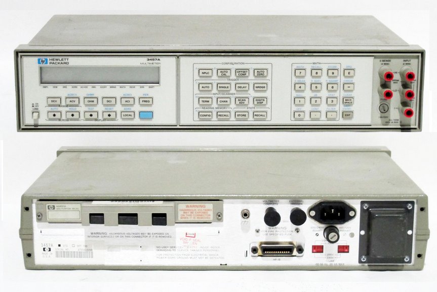

HP 3457A Pic
Hi ya Chris,
Yes folks, I've found Anatech to usually be correct in his assessments.
If I might add the following:
It's better to pick the nits now while your at it.
Later down the road, you'll have to deal with
substantial amounts of lice to pick those nits now.
