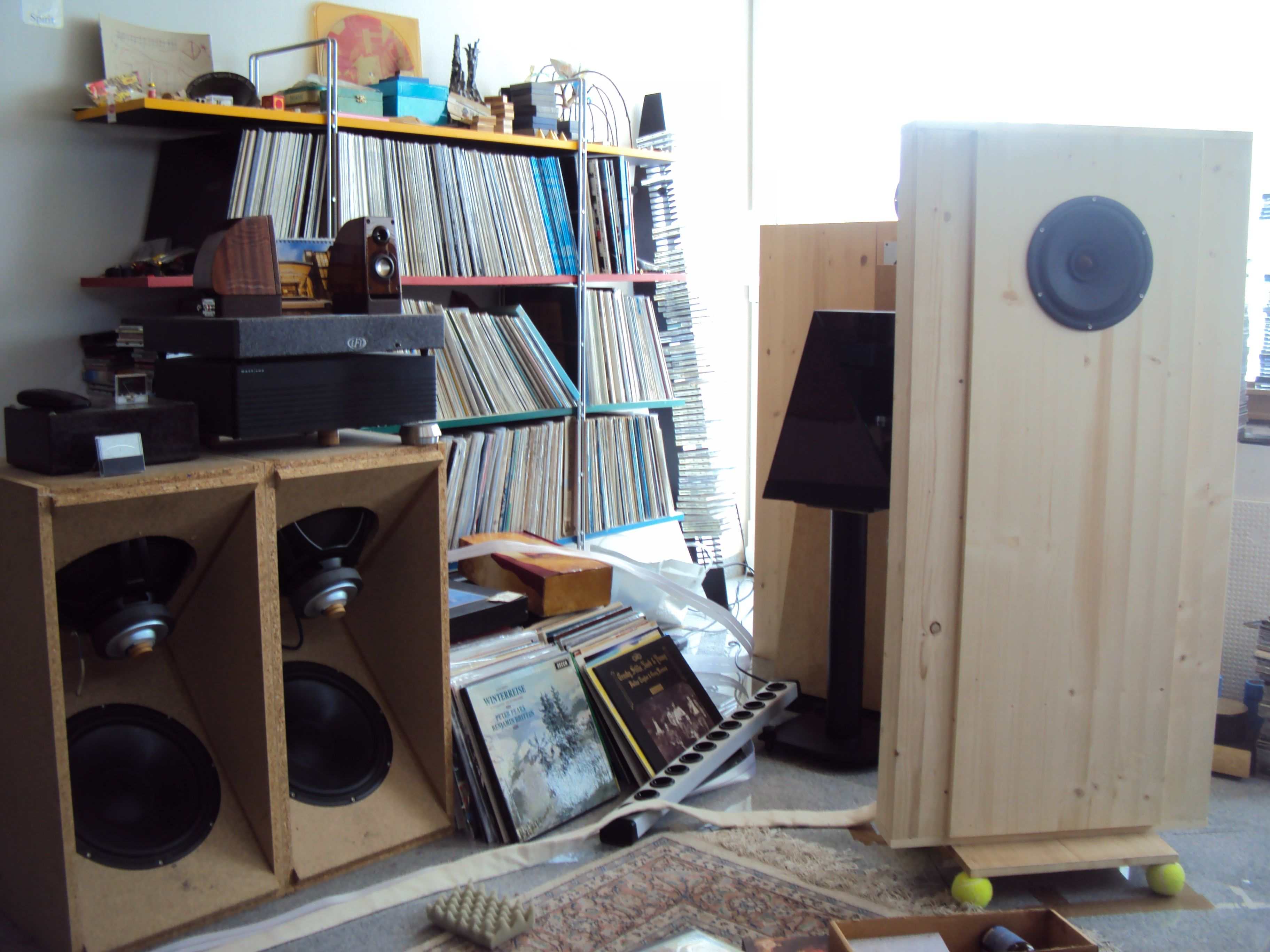

It depends a bit on the loudspeaker you use.
When i use my Enviee, high sensitivity, wide band drivers in a damped baffle my tube phono and tube amplifier combination sounds best
On medium sensitivity speakers ( the ones i have posted here are 89dB, bass active ) i prefer fast solid state.
that's a beautiful speaker! I am not a big fan of mono-band speakers I think they lack of dynamic range and frequency extension, but they surely bring more coherence into the picture that a more ways speaker can't just do because of the crossover cut off!
The Enviee is exceptional.
I get in that baffle plus-minus 2dB from 100Hz to over 20kHz.
Sensitivity is 96dB with more then 8 Ohm.
The bass under 100Hz is active and there is a 6dB line filter before the tube amp that plays the Enviees to suppress the deep bass by ca.12dB at 20Hz.
Dynamics, resolution and soundstaging are in a class of it´s own.
The systems plays so loud ( also in a big room, ask Frans ) with a few watts that i can hurt my ears with ease.

that is pretty impressive!
Then let me ask you this: why would dynamic loudspeakers with 88-92dB sensitivity have a reason to exist if with a wideband speaker you can manage to use a very low power high quality power amp and yet opbtain equivalent sound pressure SPL and frequency range?

Because of aesthetics and history.
The Acoustic Research AR set the pace.
At one time they had 60% market penetration.
Amplifiers got more powerful in the 70th, more compact and cheeper so compact speakers with less sensitivity won the race.
It must say though that before the Enviee came i was not a big fan of wide band ether.
Too colored, nasal and honky.
