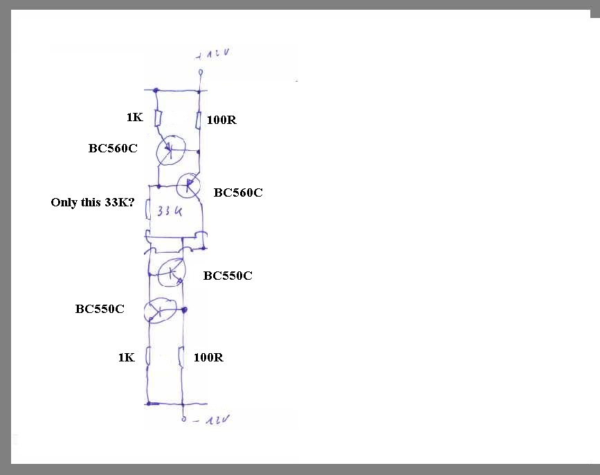

I mean I don't think there is much to that "desing" it is just a tube rectified supply with a zener regulator.
I am wondering if it will be noisier than using battery.
Tonight, if I get a chance I want to compare the battery to a good wall supply with audio transformers, blackgate caps and series regultaro stage followed up by the shunt and see if this betters my "reference" batteries. :xfingers:

Perhaps you are right and the comparisons I saw were of a regulator vs standalone battery.
it always is and this is a completely flawed comparison, should we compare the batteries to the raw unsmoothed bridge output? the fact that batteries, perhaps with basic passive filter afterwards can do so well without regulation, particularly on more constant current loads, says a lot. batteries necessarily result in fairly long, inductive connections, so for more dynamic loads its really not a far comparison.
Joined 2005
I know at least one person who tried supplying the Paradise using batteries (that means, 26V battery voltage as input for the CCS-fed shunts), and he mentioned an improvement - not big, but audible.
Perhaps grid-fed power supplies merit further analysis for both noise isolation as well as dynamic capabilities.....
