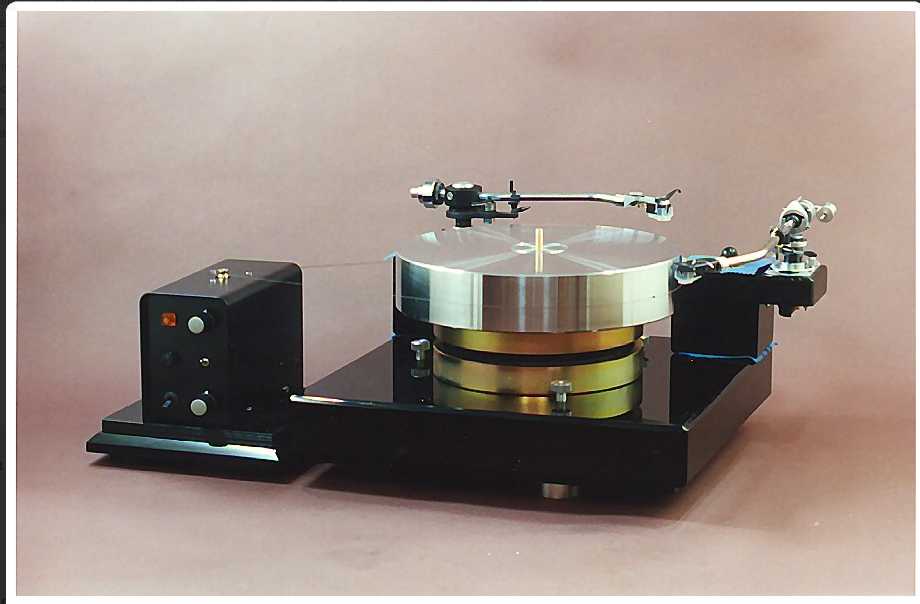

I will open soon a thread of how to DIY a very good turntable.
We already have the arm playing. It is based on the well Tempered and i think it is improved and easy to make without much machinery.
The bearing is also made. Again very simple without liquid or oil.
We have a brass platter where we will put a POM or PEAK record mat.
We also have a motor, at this time DC but we may find another solution.

Do you have target budget for your new turntable? It seems fairly easy to make a mega bucks design, but to do one for a reasonable amount and get a great end product, that is the art that I would expect of you! I have followed you in a few places and I like how you think. I would love to watch your new thread and as long as I am capable and my machinery can hold the tolerances that you will need to make one of these turntables that would be a worthwhile effort to have something that I would not pay a high end company to make for me. Sign Me Up.
Why brass and not bronze? Seems like for appearance sake alone bronze would be easier than brass but brass may be easier to get. I understand the concept behind a high mass spinning having a smoother rotational speed but my question for that becomes how do you dynamically balance it? I have a friend who balances crankshafts for engines but I'm not sure it would work for a spinning disk like a platter.
Bronze could be even better but brass was more easy to turn for my supplier.
I think by simply turning the brass with precisson will not require balancing.
The bearing is simply a teflon cylinder with a teflon mirror. The are 3 set screws on the top and 3 set set screws down in the cylinder.
The spindle is from polished steel with a rounded end that runs on the teflon mirror.
This is a bearing without lubrication.
The base will be from slate. Can be granite or artificial stone.

I suspect that a cast or hollow formed platter would have more problems with balance than a solid cylinder so you are probably correct that at the speed of a turntable balance would be a small issue at most. Bronze is probably a bit harder than brass but they both should machine fairly easily if they are not sticky to the cutter. I'll wait for your thread and let the fun begin.
This is a basic concept "Well Tempered" ...
Normal it's possible to go "near absolute center" ... if with easy-accessible-tuning-micro-screws (& perfect vertical center axle alignment) ....

I assume that the base is granite or slate for a mass loading effect. How is that superior to the old spring loaded isolation that is used in most commercial turntables in the past? I have built some massive granite shelving units in the past and I will say that sometimes it is surprising how well certain granite pieces can sing or resonate giving the right input.
I may also float part of the platter weight on neodymium rings.

Yes, We have highjacked Stephano's thread here for a while now. Start a new thread and let us know the title of the thread. Is that picture you just showed the basis of your design? I see that one is belt driven. So you are saying that the spring damped plinth idea does not isolate the platter well enough and want the massive mass for isolation?
