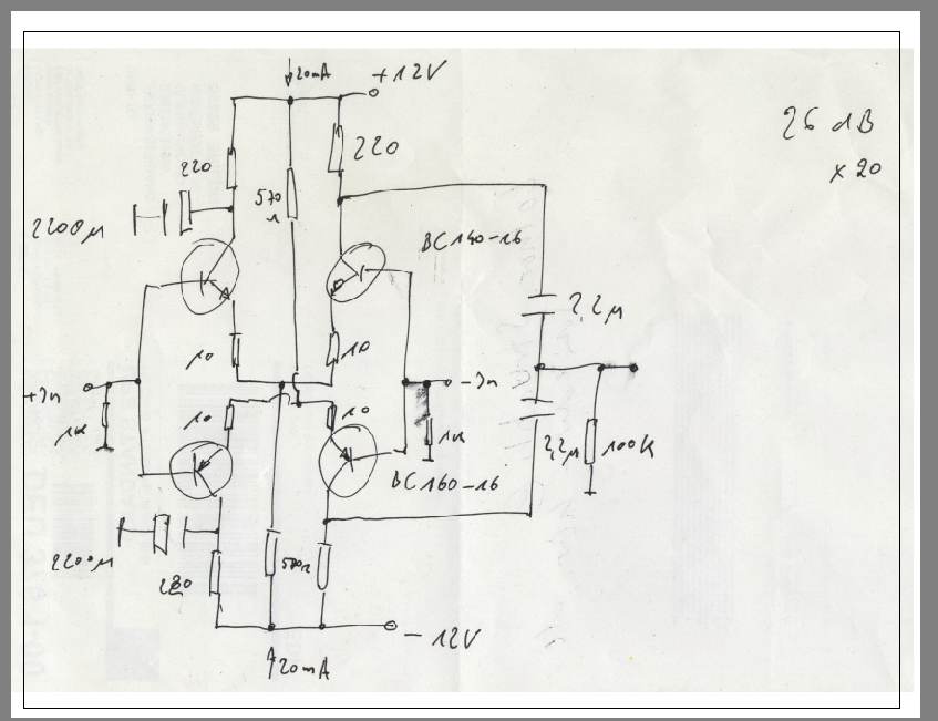

Here is the basic structure of the input gain cell. It looks very simple on the surface but works better then expected. The way i have drawn it, it is made for battery supply.
There can be many improvements being made, better PSU rejection by CCSs, lower noise etc. but try this before you draw conclusions.

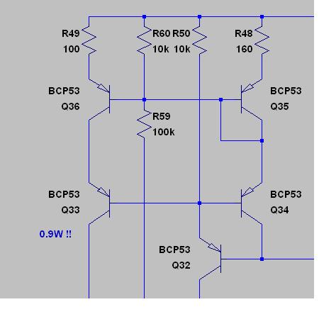

I have another question regarding the mirrors.
For the mirror attached here for example, beside Q33 that dissipates a significant amount of power all the other BJTs have very little power.
So my thought was the following:
Would I create any problem on the mirror if I would use dual small power BJTs for Q35/Q36 and use a TO220 device for Q32/33 (with heatsink)/34?
I was thinking that as long as the pair in the top are symmetric and the pair at the bottom with its helper are the same matched device it should be ok, but maybe I am missing something.
The reason for doing that is to save space on layout and also thinking that having a dual BJT on the tracker above would help keeping the current mirror on track better than having two single devices thus improving a bit output DC offset/
Any thoughts on this?

Stefano, if you do not want to parallel this is a way to solve the thermal issue.
I think as long as the chip inside the package is the same and PNP and NPN match in the quasi saturation region that should work and even improve the thermal offset when the heat of each transistor is more similar in the group.
If your chosen transistors work well or better then the BC327/337 used in the Paradise i can not tell. That can only be found out on the curve tracer and i do not have this transistors at hand. You got a curve tracer and could make some measurements.
I have shown on the MPP thread how i do the measurements and what i think is important for good mirrors.

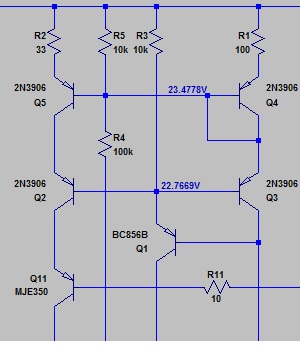

Joachim,
what if mirror is cascoded using dual small devices for the mirrors so that power dissipation on the upper devices is kept pretty low and let the cascoding device handle the power dissipation?
In this circumstance does the helper have to be the same exact BJT? Because with the helper the number is odd of course.
Me and a friend of mine were looking into the DMMT3904 and its complementary for tiny dual.
The only problem there is that if output current is set to be 30mA this device is not so linear at that current level.
What are your thoughts? Do you have a better dual in mind we can use?
Layout is complete with single devices but I decided to improve it further if there is the possibility and using little duals to achieve better tracking for output DC.
Some say : do not cascode the cascode.
I do not now. The Paradise mirror works because the output impedance is not TOO high.
Raising the output impedance to an insane high level can compound the thermal drift so you end up with a DC offset that floats around between up and down.
In another mirror design i had the same problem with thermal overload and i simply paralleled two matched BJts. Works just fine.

yes, i would keep the mirror as is and parallel similar BJTs.
i now heard the Pardise with a tube PSU and that did sound awesome so i know that the mirror has a very good potential.
why change a winning team ?
yes I agree with you.
It just happened that once I tripled the mirror it seemd that offset worsed a bit but granted I hadn't provided enough cooling for parts while in this next prototype everything will be arranged properly.
