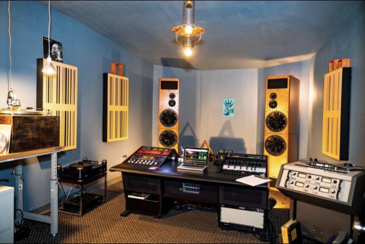

Jouanjean advocate for semi live polarized room Hidley for ultra dead room ( zero environment) highly polarized room ( only front wall is reflecting).Both are some kind of extreme and the majority must be between that i suppose (not all can afford the cost of acoustician like that and prefer to invest in gear right or wrong).
There was this post from Jouanjean (2nd post on the page) were he describes the reasoning for his rooms. Not specifically speaker related, but a very interesting read in my opinion.
Front-To-Back Acoustic Technique - PRW
- Very controlled environment for the speakers
- Natural environment for the engineer
Room is quasi anechoic as far as the speakers are concerned, but it should give some "localization cues" for the engineer's self produced noises so that it sounds like a natural place.
This is the distance within the room where you have 50% direct sound 50% 'reverb' sound ( decay is more true than reverb).
In other words this is the distance between source and you. If you follow the equilateral triangle rule it is the distance of sides to the apex.

Having DIY treated multiple rooms for recording/mixing, I have first experienced the oppressive feeling of an overdamped room in the mids/highs. For my currently under construction home studio (construction stopped thanks to the coronavirus 😡) I am trying to apply these principles. Lots of absorption for the low end, no early reflections for the speakers but some for the engineer and the musicians.
In fact what i see as a trend is the acousticians try to manage ER in a different way. All more or less agree an RFZ is important but they try to apply this differently than 'just' use absorbtion: by redirecting the ER. It is very different than absorbing in that it doesn't 'steal' the energy into the room. Of course you'll still need to absorb but it seems more natural as an outcome ( at least for the one i've heard using this principle). But that ask for the use of diffusers and given the size allowed for control room don't stop to lower it makes it more and more tricky to implement.
I think like Art this as to be a compromise between extremes.
And in my view the ER are not to be decimated/absent/eliminated. If you want that use headphone 😉. The point is more to me to try to have them 'designed' ( level and time of arrival) to something that suit you ( and in the limit of what is achievable within your room dimension).

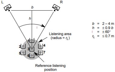

With respect to sweet spot, this is from one of the specs from ITU and EBU I referenced earlier:
