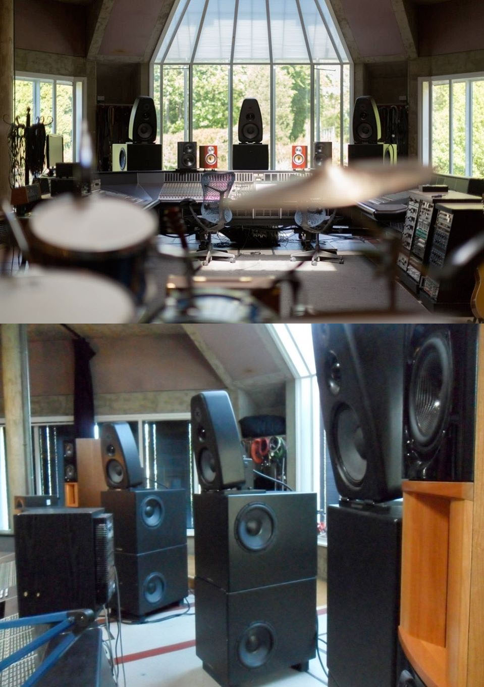

The mastering room i talked about previously located in Paris is almost exactly the same as these one. No high directivity loudspeakers in there but the acoustic is build around the Atc.
This is the key: a system composed of room and loudspeakers.
Here is the Nashville's Hidley mastering room i talked about: here RM7 Kinoshita and zero environnement room. Different approach, directive loudspeakers:
