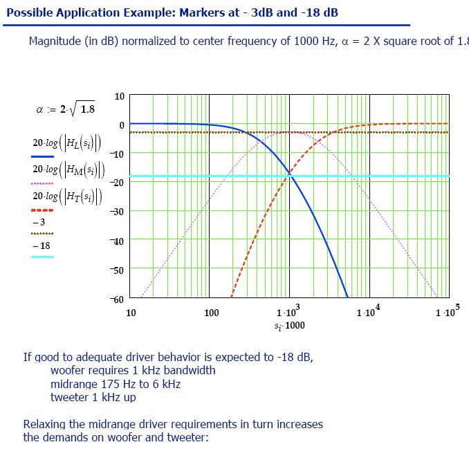

Crossovers. I have no idea who wins...this guy or 48db LR.... this just throws my whole idea of where to put crossovers, out the windows, or one could borrow from the idea and place the epicenter elsewhere... I guess I'm just curious how this approach to crossover applies to time distortion, on the other side of the scale (steep crossover) the benefits are easily seen...other than lowered group delay for minimum phase...why would anyone want anything but a steep crossover?

Duelund approach to filter.
You open a can of worm with this kind of wording about low order filters! 😀
