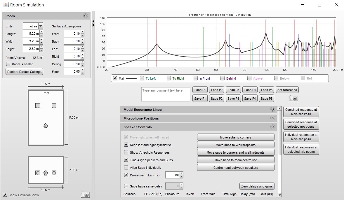

in my small listening room (3,25 x 5,20 x 2,50m) listen near the middle of the room sounds best to me, sitting any closer then 1,1 meter to the back wall and the room starts to dominate the sound to much
all room sizes seems to have their disadvantages, but in a large rooms you can at least place the speakers and the listening chair far from any walls
Testing out the sort of room interaction you will get in the modal region is not too hard with REW's room sim
Here is an example of the dimensions posted above, with a quick move around the response is not too bad in these locations. A few peaks that could be dealt with EQ and not a huge number of nulls.
I have found that this is pretty accurate in a rectangular room, surprising that very small changes can make big differences. Some of the rules of thumb work out OK, others not so much.
Add some subs in strategic locations and it would look even better.
Hi Celef,
What you experience from your closest position to back wall are reflection from it but it is a long time since you room dominate the sound. Try the calculator linked and you will see by yourself the critical distance ( point were you are at 50/50 between direct sound and 'reverb') is way shorter than you could imagine:
