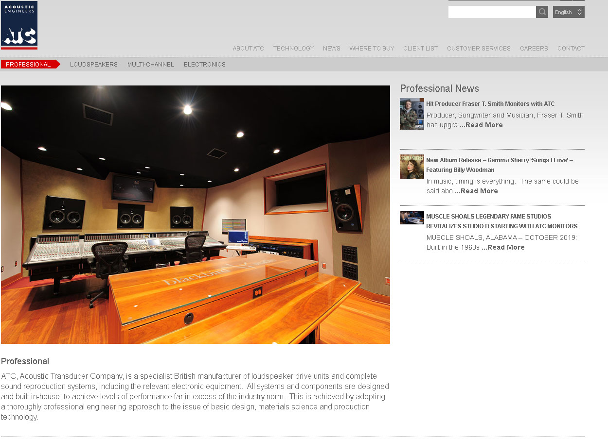

it used to be easy to get ATC drivers in the early seventies and in those days ATC's money came from Dave Martin creating the Phillishave mid and Hill Headwater's M3's after garnering a good rep from those driver developments they went after the studio monitor market and dried up the availability of components to the diy crowd.
I emailed them...
attachment.php
The link is only an invitation, I welcome you =)
