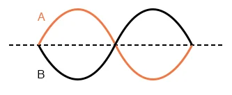

They don't have that perfect rear waves that normally will meet back up with the front wave but 1 cycle behind.
Since wavelength is different for each frequency, but distance to the wall is fixed, I'm not sure what you are getting at here.
https://www.linkwitzlab.com/rooms.htm
"Often concern is expressed over the fact that the rear radiation from a dipole is out of phase with the front radiation, and that thus any sound reflected from a wall behind the speaker would cancel sound coming from the front of the speaker. Cancellation can only occur when direct and reflected sounds are exactly of opposite phase (180 degrees) and of the same strength. Since direct and reflected sounds travel paths of different length, they undergo different amounts of phase shift. Thus, the phase and magnitude conditions for cancellation are given only at certain frequencies, if at all. At some other frequencies direct and reflected sounds will add. The same also applies to a monopole speaker in front of a wall. The only difference is in the frequencies for which addition and subtraction occur. The best remedy is to move the speaker away from the wall, or to make the wall as sound absorptive or diffusive as possible."
which side is the first to produce sound?
Which one of these waves is the first to move?

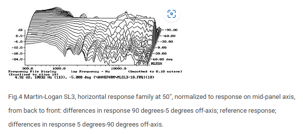

The curved panel does very little to increase the sweet spot in fact I'm thinking these have an even smaller area that can be considered to be the "spot".
If you compare a flat panel of similar width whose entire area is playing midrange and up, you do see wider dispersion with the Martin Logan approach.
Innersound Kaya
https://www.stereophile.com/content/innersound-kaya-reference-loudspeaker-measurements
Martin-Logan SL3
https://www.stereophile.com/content/martinlogan-sl3-loudspeaker-measurements-part-2

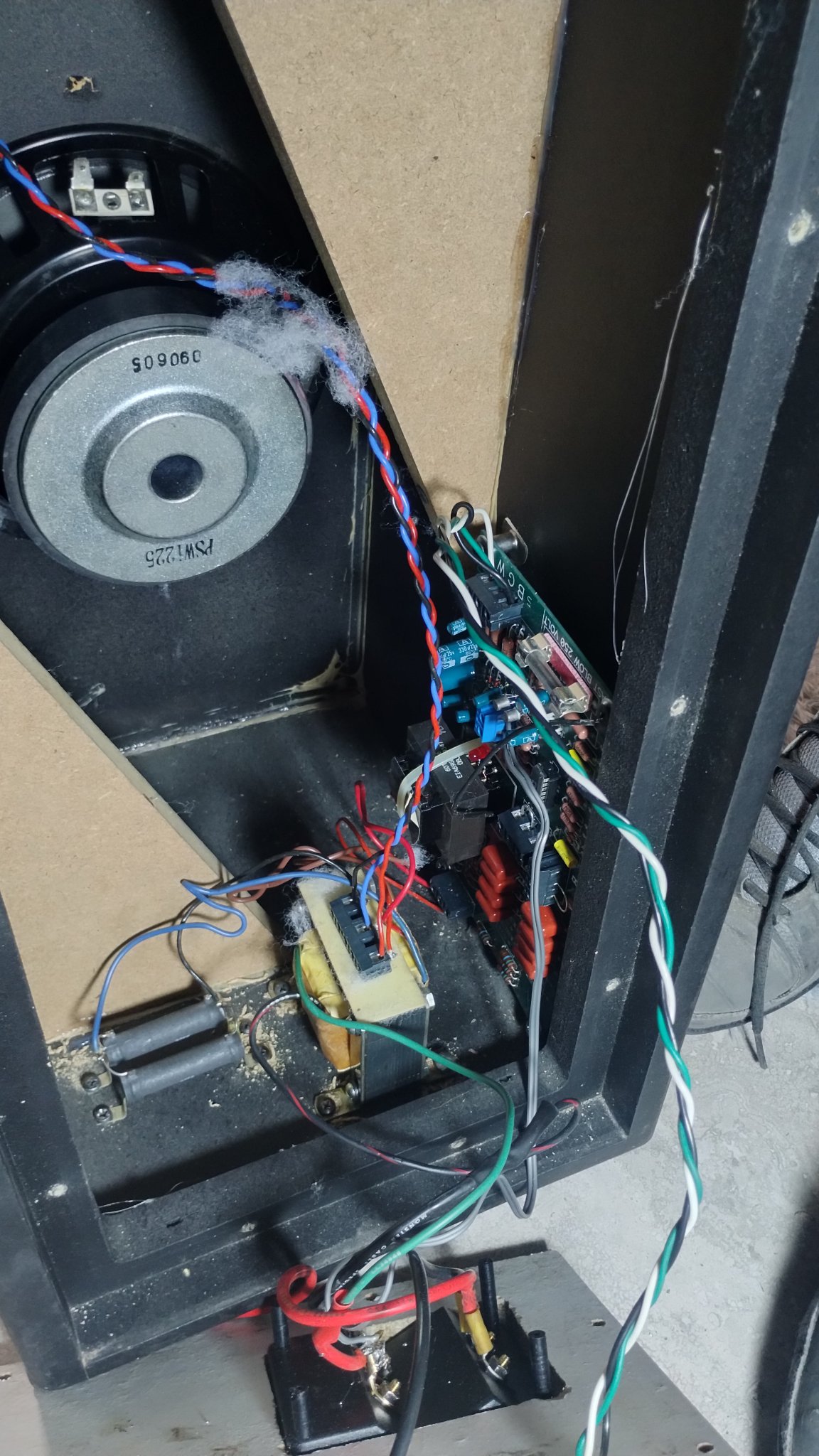

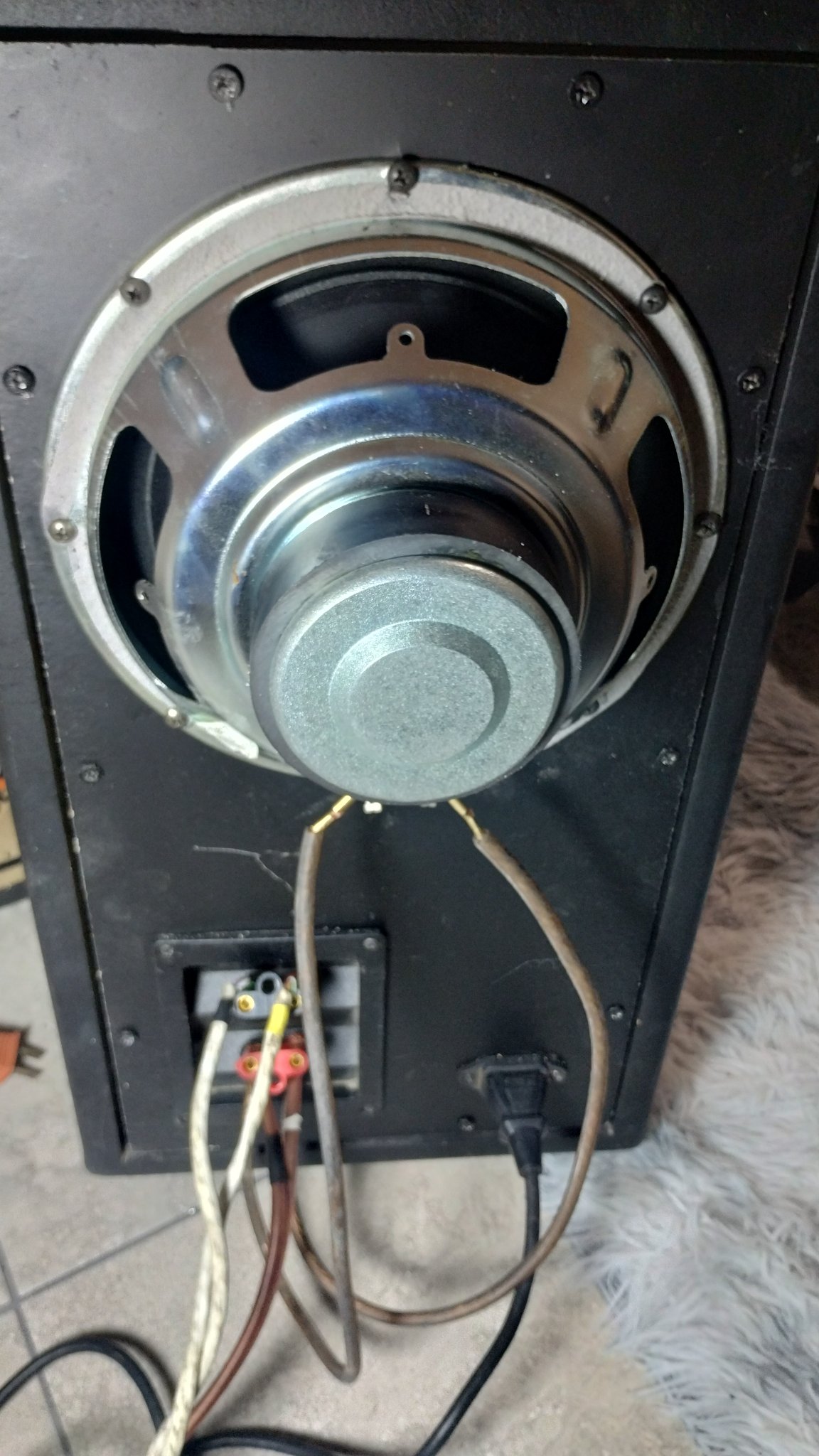

It may surprise you that when I mounted the rear woofers, I tested them mounted in both directions, firing in the cabinet as shown and out and I tested with straight and reverse polarity. What I found was the best ended up as shown but I the wiring ended up connected in reverse, the positive connected to the negative on the driver?
My old Mirage subwoofer (BPS150i) uses 2 8" drivers both aimed outward and connected normally with both pos and neg connected to the drivers position and neg posts yet they called it an isobaric configuration. Technically that's not an isobaric configuration, but that sub has a fantastic sound. It's too bad that they didn't make it capable of turning the cutoff low enough to actually match other speakers properly.
I was surprised when I got both better bass, in frequency and in db there was an improvement, but, what I was really looking for was to help the imaging and stage that was eluding me with the MLs. That too was vastly improved, but I rechecked the tests to be certain what I found the first 4 times I tested and I saw duplicate results.
I ran 4 x 12's in my car in a clamshell isobaric configuration and had great results using cheaper drivers, I did that for 20 years and swapped out drivers a few times with the same results. The car subs were ported though, the ML woofers are sealed and I made sure the cabinets were sealed as well, filling any possible leaks with wood glue. They're about as good as sealed as can be possible with all drivers and the rear panels mounted with foam gasket. I made sure to use screws that do not penetrate the panel and sealed the front panel screw holes, then turned the new woofers to use fresh screw mounting that didn't penetrate the front baffel.
I summized that the back waves coming from the back side of the cone had helped to disperse the sound more like a dome driver would. Rather than firing in a more direct concentrated wave as it would when mounted normally. The pattern diffuses in all directions in a way that matches with the panels diffusion and solidifies the rear wave forming a more dynamic and coherent overall sound.
When standing up, the panels don't lose their highs and walking out of the room doesn't lose the sound as it did prior. My old JansZen panels had a major loss of sound once you left the bubble in the sweet spot, standing up was like flipping a switch. Since I'm not listening to them while I'm moving around, gaining off axis sound makes no difference to me, but at least I can say that they are much more enjoyable now than when I got them.
This may surprise you but I had no idea ML had other similar models that have rear mounted woofers until after I did this to mine. I found out after I went to post my plans and came across a few other models that incorporated the design. I know that they mounted the woofer aimed magnet inside the cabinet, I figured due to obvious reasons but I don't know how it's wired. I haven't heard any of those models yet so I can't say what the intension was for adding the 2nd woofer. From what I've read, the specs don't reflect much of a gain in lower frequency from models with 1 driver, so they may have been trying to reinforce the rear wave as I was. I'm wondering if there is any gain of the woofers is mounted as I did mine and of course a change in polarity might be needed.
