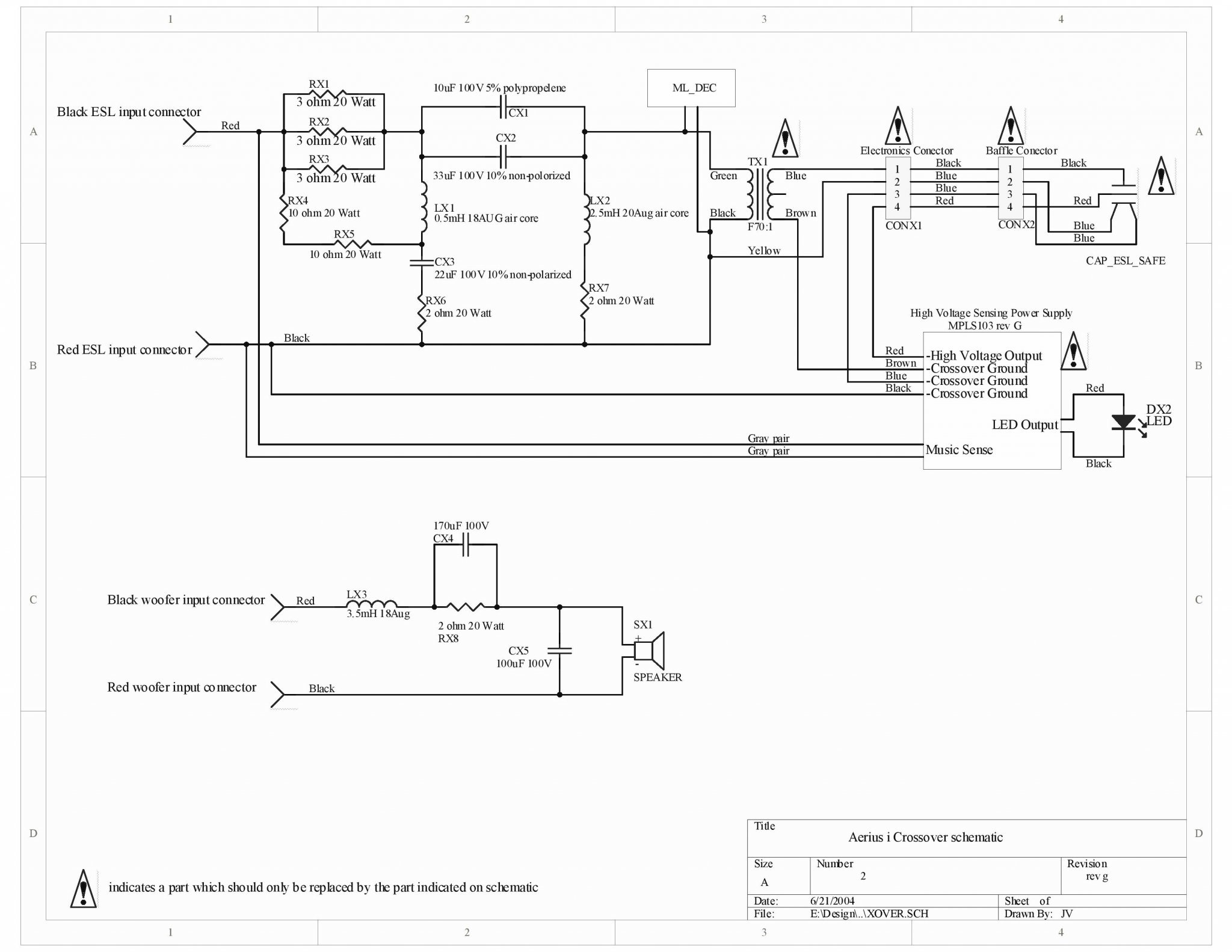

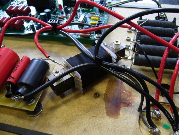

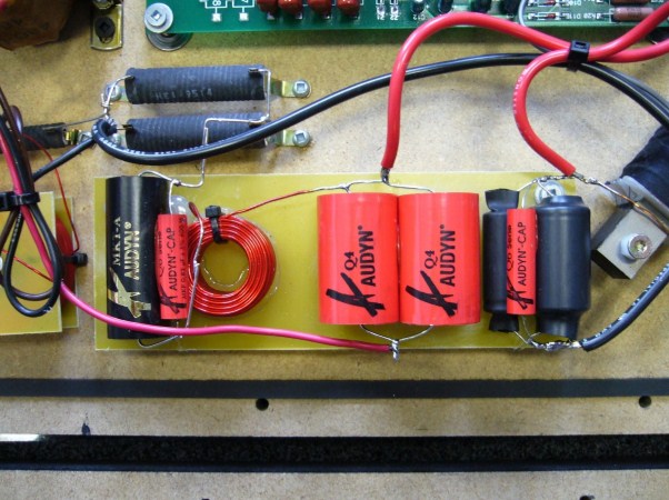

Some years ago I upgraded parts of the XO like follows referencing the attached schematic:
Panel XO part:
C2 - 22UF swapped to a Audyn Q4 22UF
C1 and C2 bypassed with a Audyn Q4 0,1UF
C1 - 10UF Audyn Q4 was not in stock back then so I left the stock PP - 10UF in.
Bass XO part:
C4 - 100UF swapped to a Audyn Q4 100UF (quite big)
The improvement was quite audible, I was satisfied.
Today I decided to swap
the original C1 PP 10UF with a Audyn Q4 10UF
also swapped the C3 - 15UF ELECTRO to a Audyn Q4 15UF
at the same time I removed the bypass Audyn Q4 and installed a Audyn Plus 0,1UF in the same place bypassing C1 and C2
I left the Bass XO part as described above as I am going to get the HiFi Zenit Bass XO rework done.
WOW was that an improvement, I´m absolutely flabbergasted!
The soundstage turned deeper and wider and the high frequencies is far more detailed. I did not expect such a vast improvement.
Hi Folks I have done the high pass upgrade on my aerius i, using clarity caps. I've been quite impressed with the results, mainly I think coming from a reduction in distortion which I assume was high due to the age of the original capacitors in there.
So I think I will do the low pass as a matter of course to see if there are gains to be had there. At the moment I'm only interested in restoration so will replace the components like for like (I might look at active cross over later).
My question for you good people relates to C5. This seems to be a signal path to ground not to the output and therefore would seem a waste of money to "upgrade" the quality and a lower cost component (like the original) could be used there. C4 is in signal path and therefore may be worth spending a little more.. Or am I missing something?

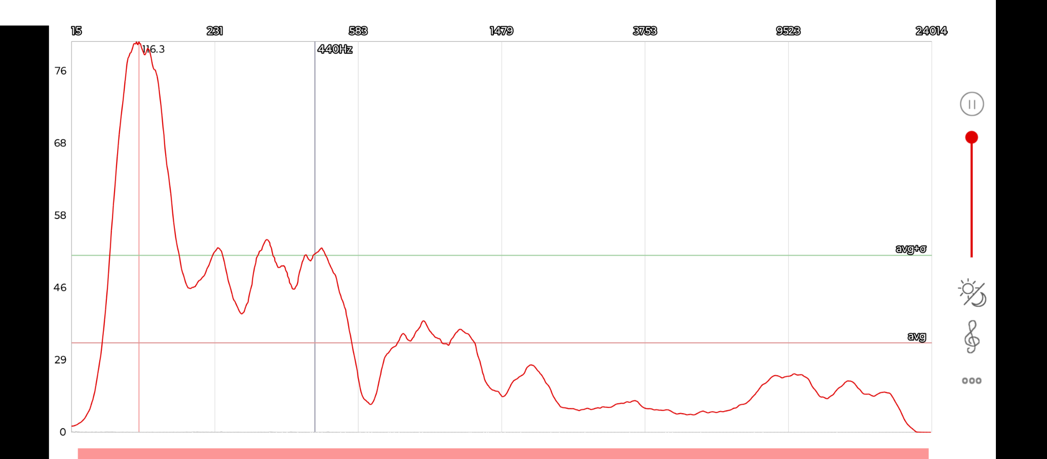

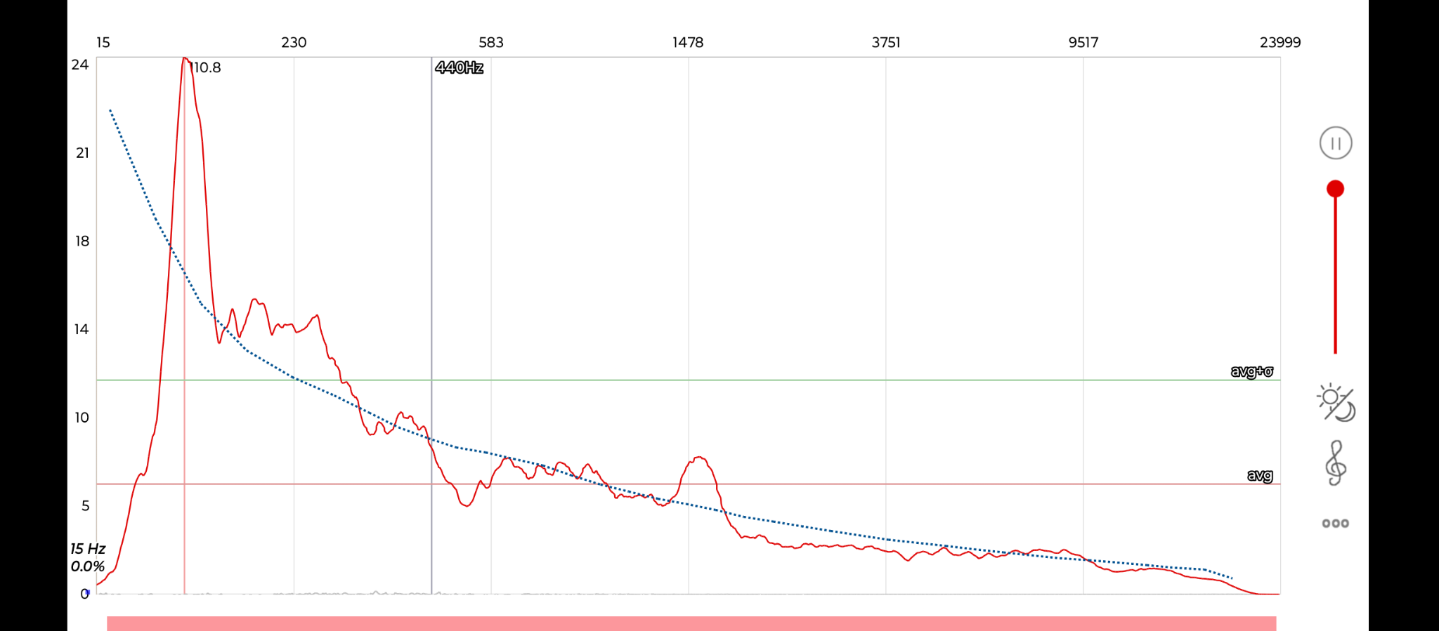

I have found some answers. First off the test mic I was using has an issue! I was able to find a version of my favorite RTA app called SPECTRUM RTA. The newest version won't work with my Moto stylus 5G Running And 13 but runs fine on my tablet. The version 2.10 or 2.12 is the one that runs on my phone, 2.40 is the newest.
My Moto phones have always had really good mics that are pretty close to reality when using that test app. I found the built in mic to be better than the Dayton calibrated test mic.
So I was able to run more tests and I eventually bypassed the internal crossovers and am back to active. Using a 3 way in 3 way mode. I tried the 2 way mode and even another 2 way crossover and the slope for the crossover makes for an obvious transition point.
The panels tested down to 260Hz usable output without anything crazy going on. I replaced the woofers, it appears 1 was replaced and the other has been reglued on the surround and they looked the same on the front, they were different years or something. I also removed half the fiber fill from the cab. Typically sealed cabs don't need to be packed full.
The bass has improved dramatically and the tests I have done need to be reran again just to see where I'm at. I have been swapping amps a bunch lately since I have 2 channels that get hot, I have removed those channels and tried several others in different configurations. I have 5 matching BGW A150s that can be bridged for 150w output , the 50w x2 Just isn't enough to do it and while I'm figuring out the bias settings I've subbed my old faithful Peavey CS400 with fan mod for the bass.
After tipping my the speakers down instead of upward, I have gained a huge improvement in sound quality and focus. Still not the same as the old flat panels.
I have moved them over 3 ft off the back wall and tied them so they cross in front of me while in an equal triangle set up. I'm crossed at 350Hz for the woofers the panels are running to natural roll off and I have been setting levels in the Crossover . Also finding if I need to reverse polarity on the panels or on the woofers or both!
The way the sound eminates from the panels needs to start with the rear side first (is what I would think to be logical) since it's traveling further via reflection, it should have a head start so it can meet with the front sound back in phase (somewhat).
Then theres the woofers phase, there's no way to predict if the crossover point is going to be in phase or not and using the overlap of sound could benefit front out of phase tones in the band where it would otherwise be gaining. Since the timber is different, the amount of cancellation is little but what is cancelled will help the 2 drivers transition without as much noticable change in sound.
It worked on my last set and I'm getting closer to a cohesive sound again. The mids are starting to be more directional and focused. There's a need to EQ them though there should be more mid detail in the 1kHz area. Sound like a hole there. When your speakers can reproduce that area without distortion, it becomes a huge part of realistic sounds. Increasing on other speakers just makes it sound awful and sqwauky. Where the panel will use that to bring things to life. Kinda like the opposite of what everyone used to set their 1970s eqs . The smiley face curve.
They're shaping up slowly. I've been thinking of moving the power supply into one of the side walls and using the back to mount a 2nd rear firing woofer in an isobaric config. There again comes the need to test with driver facing in or out and in phase with the front or not.
Cutting another back board to do do tests will make things easier too. I can cut 3 or 4 to have changes ready to go to mount and remove. Probably glue some blocks in the corners to run screws so I don't strip out the original holes. I can know them out later.
The isobaric set up won't be to add more bass but to reach lower to bring out the subharmonics that these speakers are missing. You don't realize how important it is to the overall impact of each song until it's no longer there and you're expecting to feel a certain vibration at some moment and it's not there. Without ever experiencing it, you'd never know it was gone, once it completes the song as it was intended to be, it just sets the mood. Of course it's only effective if it's really clean throughout the entire range. Only hearing bass as the recording has supplied it was another realization for me. The bass is only there when it's supposed to be.
In my car, I hear bass constantly but the old home system played the same songs completely differently with a much defined sense of reality and way deeper bass that only kicked in when it should. All bass tones are not just one note but formed several different sources at different levels of frequencies. It seems years of using a dedicated subwoofer has done to ruin music for so long.
Car is unavoidable, but I made sure to fix it with my last build and now it's gone and these speakers bring a much harder set of restrictions to work with to achieve it will take some time but I think it's doable with the correct plan.

I had acceptable bass with different woofers and the Peavey amp. The amp is barely working and only see the first LED lit during normal listening. After much repositioning of the speakers I was able to get a little bit of what I expected when I moved them over 4ft from the front wall and about 8ft apart with slight toe in. My JansZens were just 2.5ft from the front wall with a toe in that crossed in front of the seat position. I'm still not getting the full headphone effect but it's close. I still think the curve is interfering with the rear waves. The rear woofer may be able to reinforce it and bring it together but I'm worried about the distance from the wall being to far away to get it timed correctly. I've always had all woofers aimed in at me in previous designs.
I have a noise that enters at around 160Hz, cabinet vibration on the side I'm currently working on and I couldn't find it or stop it using my hands on the outside and I'm hoping that removing and remounting the boards on the side wall will fix it. The HT board will fit perfectly behind the brace and I replaced those tiny wire posts with true 10ga type screw down all metal ones and a 4 post cup type terminal. I'll be sealing everything with hot glue to try and make the isobaric idea working properly. There can't be any leaks or the isobaric loading will not be effective.
I'll report back in the afternoon tomorrow with more results.

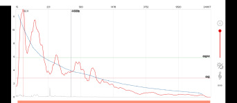

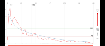

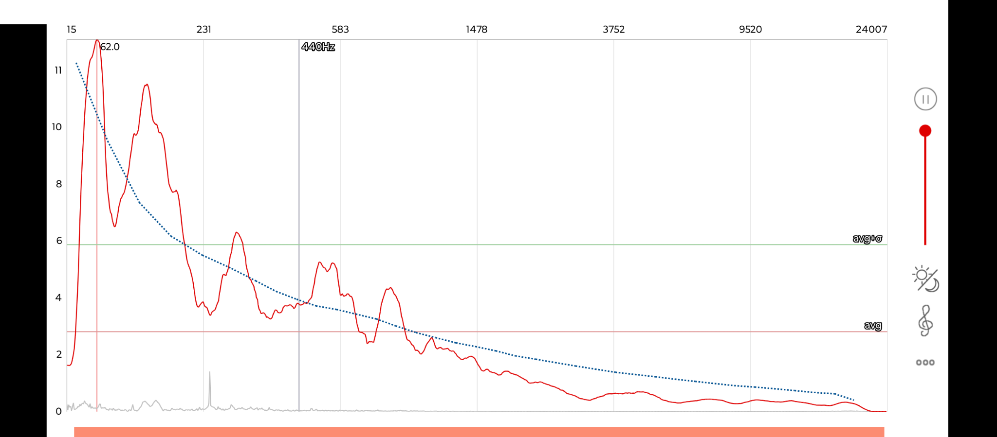

Oh yeah here's today's sweep with no EQ.
This is last week after new woofers and EQ.1
Before new woofers
Here's one of a speaker I put together using some old drivers just to prove that paper cone drivers and mismatched parts can sound better than most bookshelf speakers made by Infinity using dome tweeters. This is an old Sonic cabinet with 10" Marantz woofers, a sealed back sonic (pioneer) 3in mid and a Bose 501 2.5in tweeter with a 3 way crossover that uses 3 caps, 2 resistors and 2 coils.
