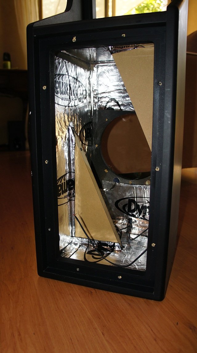

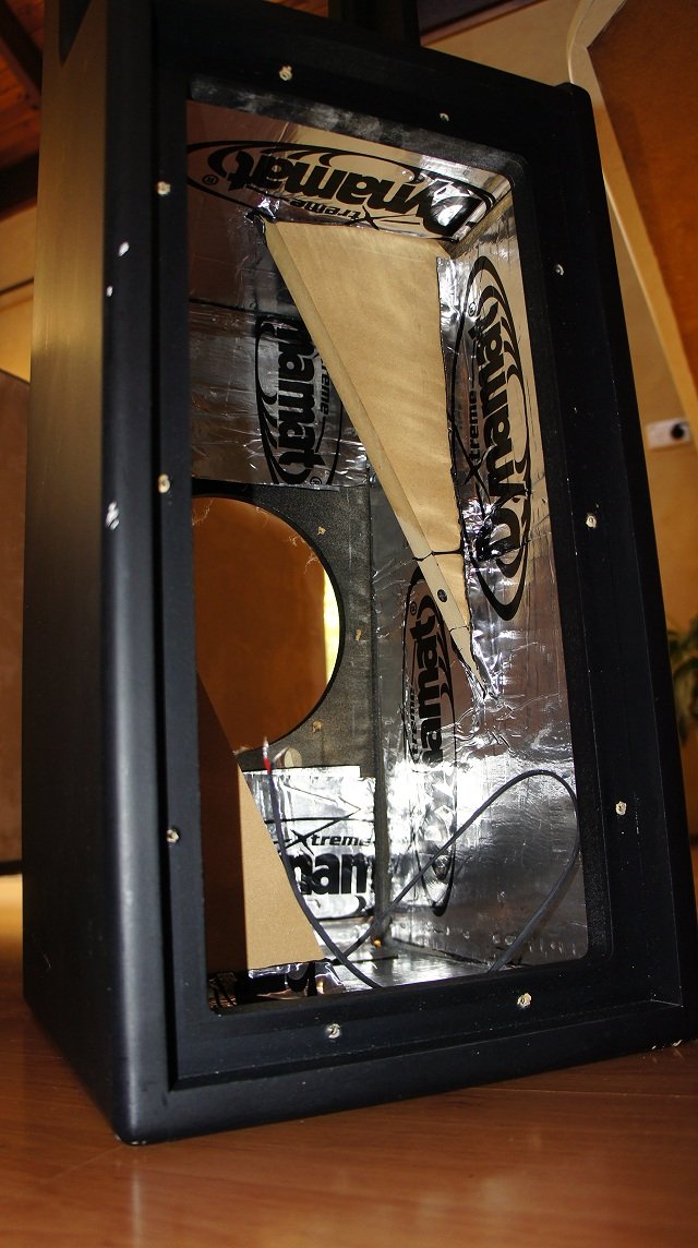

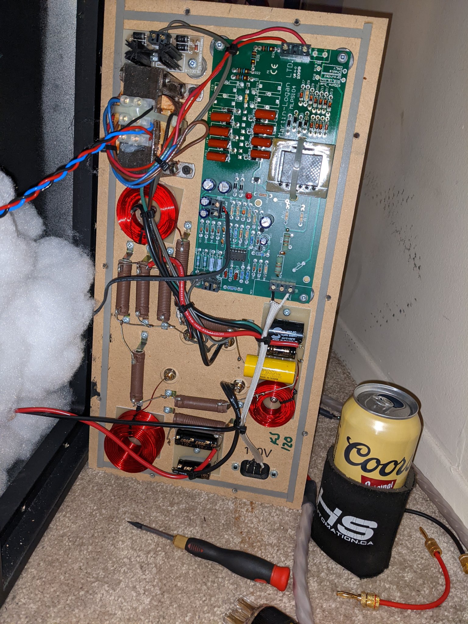

Here's what the finished addition looks like
The change is dramatic, the imaging has improved greatly but is still lacking, they sound more like a dome tweeters in that they have a bit of harshness, like a slight sybilence (not sure how it's spelled) I'm very hesitant to wash them since I keep reading how they are coming loose on the sides. Doesn't that completely destroy them when they loose tension? People act like that's not a big deal, but to me that would make them junk.
They seem to work as they should there's plenty of sound coming from them and they test good from 250 to 20kHz.

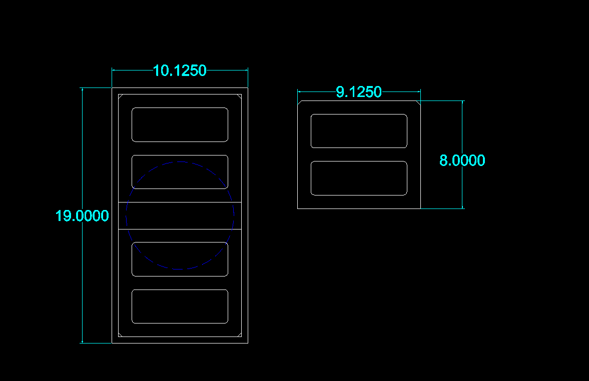

I've done quite a bit of testing using multiple JansZen panels in various configurations. I had a total of 28 panels to work with, 8 were the smaller 2.5" x 5" and 20 of the 5" x 5". When I placed them in a circular configuration with 4 panels horizontally and each panel placed about 8 degrees angled from each other evenly, my staging and imaging disappeared.
I basically copied the same layout that JansZen had with their 4 panel systems that were mounted with the backs blocked off but used them with the backs open.
I also tried copying the Infinity layout where 4 panels were on a horizontal plane with the outer panel angled outwards toward the side wall, that improved the focus a bit and have a bit more off axis sound but it didn't have the same sound as when all panels were aimed on the same plane.
I came to the conclusion that the curving would cause huge reflections or refraction as the waves crossed paths, blurring the rear waves. I haven't tried blocking the back side of the MLs yet but I intend to do test it this week. My guess is they will benefit from this in the stage and imaging, I will disconnect the rear woofer while testing. I should be able to move them back to the wall a bit as well.
It may surprise you that when I mounted the rear woofers, I tested them mounted in both directions, firing in the cabinet as shown and out and I tested with straight and reverse polarity. What I found was the best ended up as shown but I the wiring ended up connected in reverse, the positive connected to the negative on the driver?
My old Mirage subwoofer (BPS150i) uses 2 8" drivers both aimed outward and connected normally with both pos and neg connected to the drivers position and neg posts yet they called it an isobaric configuration. Technically that's not an isobaric configuration, but that sub has a fantastic sound. It's too bad that they didn't make it capable of turning the cutoff low enough to actually match other speakers properly.
I was surprised when I got both better bass, in frequency and in db there was an improvement, but, what I was really looking for was to help the imaging and stage that was eluding me with the MLs. That too was vastly improved, but I rechecked the tests to be certain what I found the first 4 times I tested and I saw duplicate results.
I ran 4 x 12's in my car in a clamshell isobaric configuration and had great results using cheaper drivers, I did that for 20 years and swapped out drivers a few times with the same results. The car subs were ported though, the ML woofers are sealed and I made sure the cabinets were sealed as well, filling any possible leaks with wood glue. They're about as good as sealed as can be possible with all drivers and the rear panels mounted with foam gasket. I made sure to use screws that do not penetrate the panel and sealed the front panel screw holes, then turned the new woofers to use fresh screw mounting that didn't penetrate the front baffel.
I summized that the back waves coming from the back side of the cone had helped to disperse the sound more like a dome driver would. Rather than firing in a more direct concentrated wave as it would when mounted normally. The pattern diffuses in all directions in a way that matches with the panels diffusion and solidifies the rear wave forming a more dynamic and coherent overall sound.
When standing up, the panels don't lose their highs and walking out of the room doesn't lose the sound as it did prior. My old JansZen panels had a major loss of sound once you left the bubble in the sweet spot, standing up was like flipping a switch. Since I'm not listening to them while I'm moving around, gaining off axis sound makes no difference to me, but at least I can say that they are much more enjoyable now than when I got them.
This may surprise you but I had no idea ML had other similar models that have rear mounted woofers until after I did this to mine. I found out after I went to post my plans and came across a few other models that incorporated the design. I know that they mounted the woofer aimed magnet inside the cabinet, I figured due to obvious reasons but I don't know how it's wired. I haven't heard any of those models yet so I can't say what the intension was for adding the 2nd woofer. From what I've read, the specs don't reflect much of a gain in lower frequency from models with 1 driver, so they may have been trying to reinforce the rear wave as I was. I'm wondering if there is any gain of the woofers is mounted as I did mine and of course a change in polarity might be needed.
