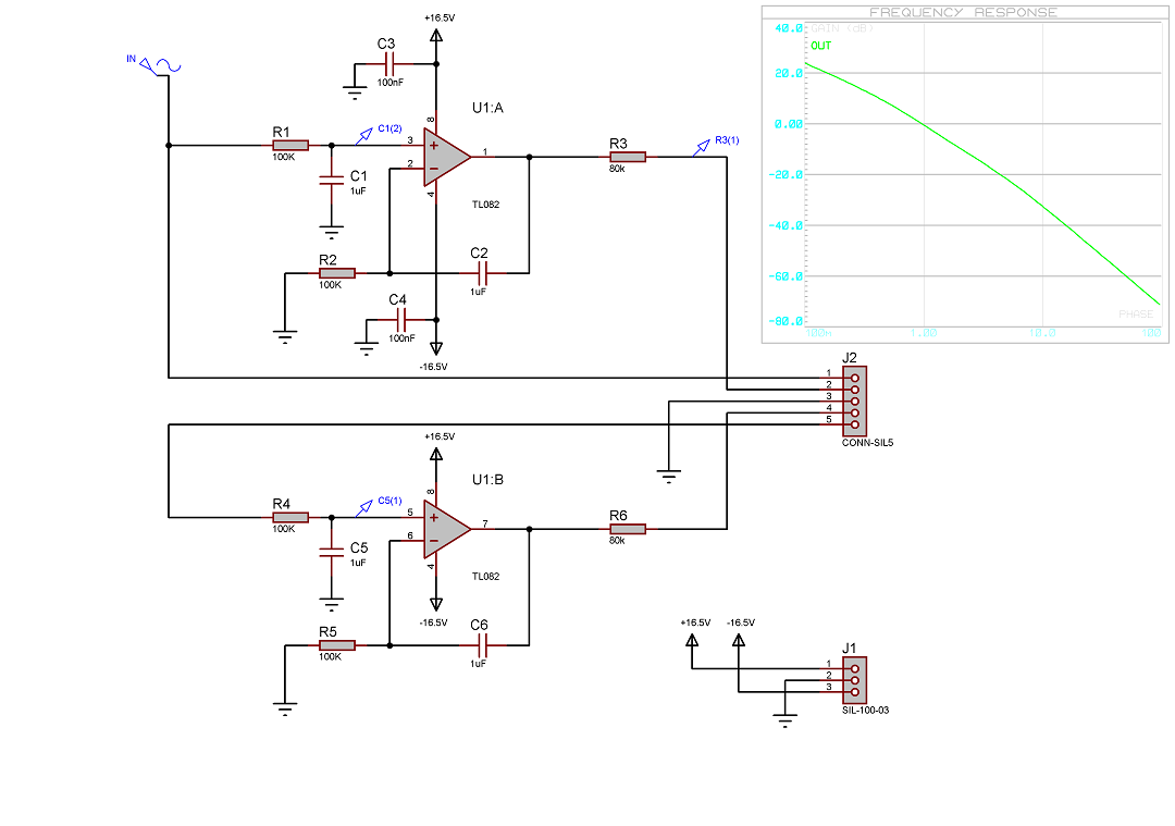

I have some problem with the DC offset at amp output. The problem is due to small - 3-4mV voltage at the output of my source. The question is - how to resolve it better: by decoupling caps like : ????? ?????????? - WIMA - MKS2B046801M00JSSD - CAP, FILM, PET, 6.8UF, 50V, RAD or 1 Pair 2pcs of Mundorf Mcap Supreme Capacitors 2 600 1400V All Values | eBay, or to build a simple DC servo with some fet input opamps, like TL082 ?
Personally I would address the issue at the source and leave the amp alone.
The source still on the warranty, and I don't wont to void it. And I don't think that 3-4mV at output is valuable reason to open RMA request. Even if RMA request will be accepted, the shipping of my DAC to factory, will cost much more than pair of caps, or servo...

Now the DC servo. I tried to simulate you amp circuit with DC servo added, and noticed kind of improvement in THD floor. The amp benefits from low THD if output DC offset is so small as possible. DC servo doing here perfect job.

Well, I assembled a servo at kind of breadboard. First of all it defeated that voltage offset.
While amp with input shorted to ground was drifting +-3...5mV, with source connected and volume on max it was about 20mV, now, it 0-0.4mV regardless to what's going on the input.
The servo works better if it ground connected to the star ground point just between the regulators.
With 100K resistors on input and 50K at output of the servo, the LF roll off begins somewhere about 2Hz -0.1dB, 0.8Hz -0.2dB.
I didn't noticed either noticeable changes in the sound. Probably hi end became more transparent. But it can be a my subjective bias.

yes. I suspect the same p/n for transistors were not used. The ones I used were also operated at their zero TC bias point and does not drift.
When you force an unbalanced amp to balance by servo you often get higher distortion.... balanced for DC isnt always the same as balanced for AC.
However, I would not bother with servo with the small offset being talked about.
A misuse of a dc-servo has been to zero out an unmatched/unbalanced stage.... I developed the servo concept primarily for reducing dc drift. With closely matched devices and the ones selected and operated as I did.... offset and balance is not an issue and distortion (as measured) is extremely low.

Now if you want to hyper tune the amp, and if you can measure the harmonic distortion way down low ---- You can add another trim in place of R10... a value of 500 ohm should work well. Or, you can jumper in a 2K pot across the existing R10 and adjust for distortion null and replace pot with a bridging R value of the trim pot value. I found some more reduction in thd this way when under load (<100 Ohms).
Here is my proceedure to try if you have the thd equipment: Apply load R to the amp.... using the dc offset pot, trim to minimum thd. You will then have a dc offset. Then, using the pot at R10, readjust for zero dc offset. Maybe a little back and forth and you will have the lowest possible thd... even beyond matching. In my case changing R10 value by only 40 ohms improved the performance under heavy loads. So, use a multi-turn trimming pot. How much improvement depends on how well you matched all your transistors. The matching of the jFET provided by jackinnj is even tighter than i did... so i cant say how much better you can get under load, but its what i do.
Yupp, carefully trimming R10 and adjusting P1 nulls both distortion and DC offset. You have to be patient, going back and forth from one to the other. I adjusted mine for the load of the Sennheiser HD650's.

Do I have to change these to MJE210G 200G ? The problem is that obtaining MJE2XXG is subject to import from US only, and farnell asks $0.64 per transistor if I buying a bunch of 25+ units.
And I found strange behaviour: while voltage across CE of Q1 and Q2 are equal at one channel, the second channel shows 0.5V imbalance, and the output of that channel is always 2.9-3.2mV(even with the servo connected) while another channel 0.1-0.4mV ...
Looks like something was not matched carefully enough ?
Another question - do I have to use separate radiator for each channel ?
