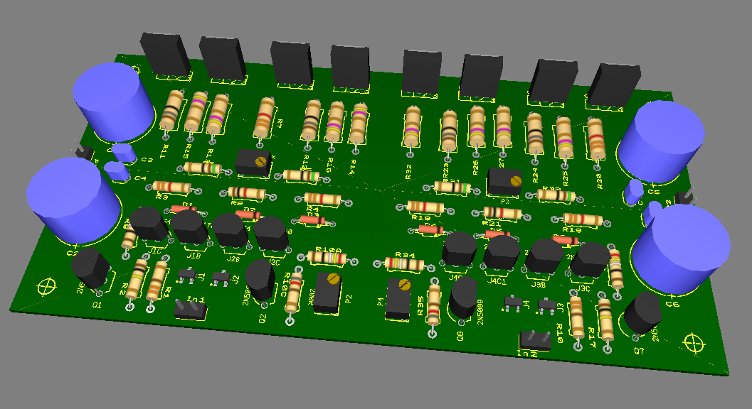

Hmmm ... regretting my choice of PCB then as this layout is not conducive to heatsinks (devices too close together) ... I was under the impression they would run fine as-is.
Back to eBay for some cheap offshore extrusions! 😛
You can use heatsinks that clamp onto the transistor. You don't have to have the heatsink mounted on the board. They cost about 50 cents each, they just are a U shape that has fins on one side for the cooling. And if you run 2 diodes, which is what Richard Marsh does, you really don't need them. but again, you can get heatsinks that sit right on the devices on the same boards.

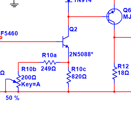

I have had a run of requests for boards -- ran out several weeks ago. I was thinking to modify a bit by providing for adjustment of the 2N5087/8 and allowing folks to use SMT input JFETs, or K170/J74. As before, and in deference to Richard's IP, will offer the boards out at cost:
Any chance of spreading the output transistors apart more to allow for heatsinks to be attached?

On the first go-around, I didn't realize that so many folks would have difficulty sourcing the 2N5457 NJfet. The equivalent is available in surface mount. The through-hole device does show up from time to time.
I think it was Richard himself who suggested twiddling with the resistor values...and that was at least a year after the article was published in LA.
You'll probably find that careful adjustment of the two potentiometer values, getting the output devices relatively close will swamp any effort to tweak a bypass cap here or there.

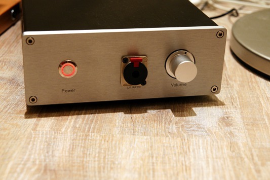

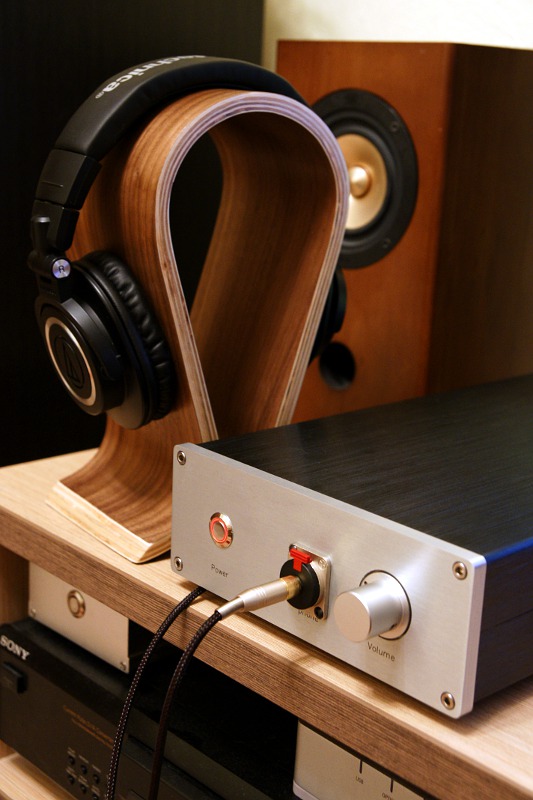

I finished my Marsh amp, sounds good. Added a few pictures. However, it is quite large in size for headphone amp , but i like it. tnx for circuit.
some details - added DC B1 + elna + bypass Caps + Rifa.
