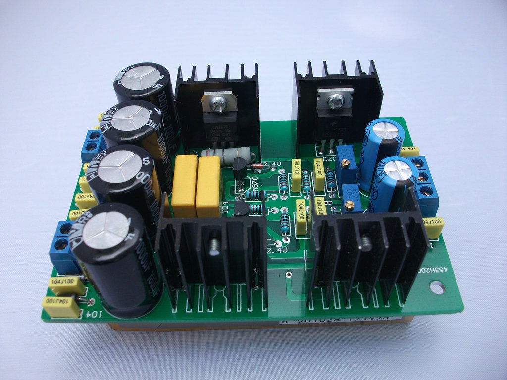

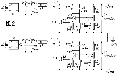

I got my board assembled and am shopping for a power supply and ran across this on eBay ... seems like it would do the trick and the price is right at only $15 fully assembled PCB with free shipping! Looks like a CCS-fed shunt to me.

Very nice solder work.
15$. . . wow. I wish I had seen that. Get 2, one for each channel. Do you have the link on ebay? I have made up CCS before. Done right they sound good, but if off, I found them slightly grainy and at that point I prefer battery but then unless you have another circuit involved you don't have CCS.
Thanks! In a previous life I was MIL-STD-2000, IPC and PACE certified. 😀
Here is the link: Class A Parallel Regulated Power Supply Finished Board | eBay
I plan to integrate this into my existing preamp chassis, so I don't have the room for the second supply.

Right, having an umbilical is a nice way to go but then you have more to mess with.
It is unbelieveable they can do it for that money!
Though, be aware, you need a xformer with two fully isolated secondaries.

Yes it is! Sometimes the things I find on eBay from China baffle me! I usually buy all of my gold-plated audio connectors there for pennies on the dollar for the same ones sold here in the USA that are "rebadged". 😉
FYI - I already have an 18V+18V Antek toroid

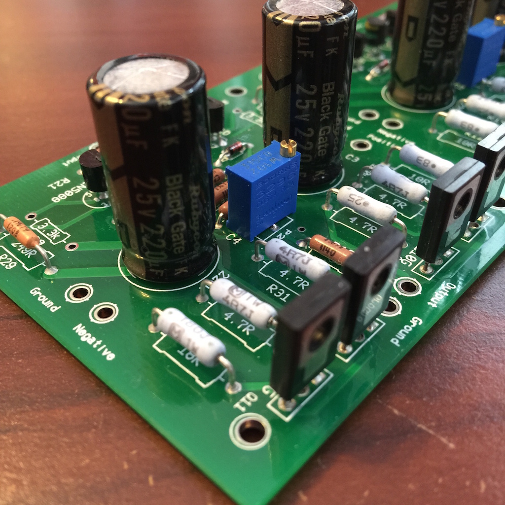

I had to go back and look at your soldering skills. I need to work on mine. I have been soldering for over 50 years. Do good at times and have soldered resistors about the size of dust but always like to improve my skills.
I just noticed you installed Black Gates. I still have a large store of BG's but not enough of the right ones for this.. . . oh, I have some 16 volt 470uf non polar. That would work. I like caps near their max voltage anyway.

As for the BG's, I had them leftover from an old Marantz CD63 I had modified back in the day. IIRC, I only paid about $10 each for them back then. I decided to give them a home in this board ... now I only have 2 left! 🙁

Right, I refuse mine. Still have around 100 NOS. High voltage for tube equipment and then mostly 6.3, 16 and some 25 volt. Mostly in non polar, which is what I preferred. I bought a number when they were on sale at 1/2 price of the original retail. :^) Maybe some day something will equal them for analogue stages.
