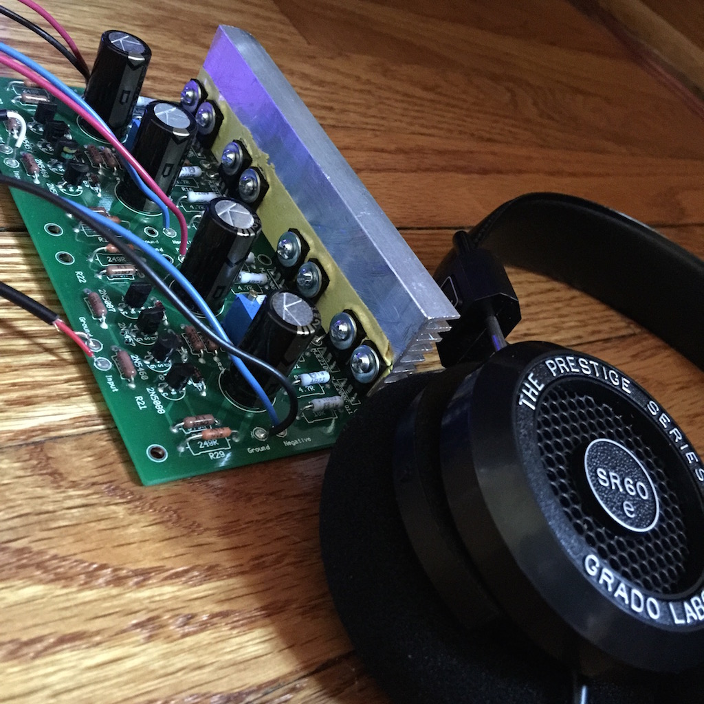

Finally got the heatsink mounted and am burning my Marsh in. The sound isn't bad right out of the box. A little muted on the highs and lows but typical of new electronics (and headphone drivers). 😛
WOW does that heatsink get hot! I can touch it but not for more than a second. I'll have to borrow a Fluke IR meter to make sure they are running safe. I am only running at +/-15V right now.
Looks very nice. What PS voltage are you using? And, if you changed OP stage devices, you may need to delete one of the bias diodes.
-Richard
-Richard
-Richard
+/-15V ... I am using Jack's kit with the 2SD669AC and 2SB649AC ... should I short one diode?
Just do it - it's easy 🙂. It will run much cooler for sure; if it sounds different is up to you to decide. Mine didn't, neither got the THD any worse.
Yes, I removed one of the diodes and it runs MUCH cooler now! I then went from +/-15V to +/-18V and it still stays only slightly warm but sounds much better at the higher voltage. It seems to be taking much less effort now. The sound is more open and dynamic.

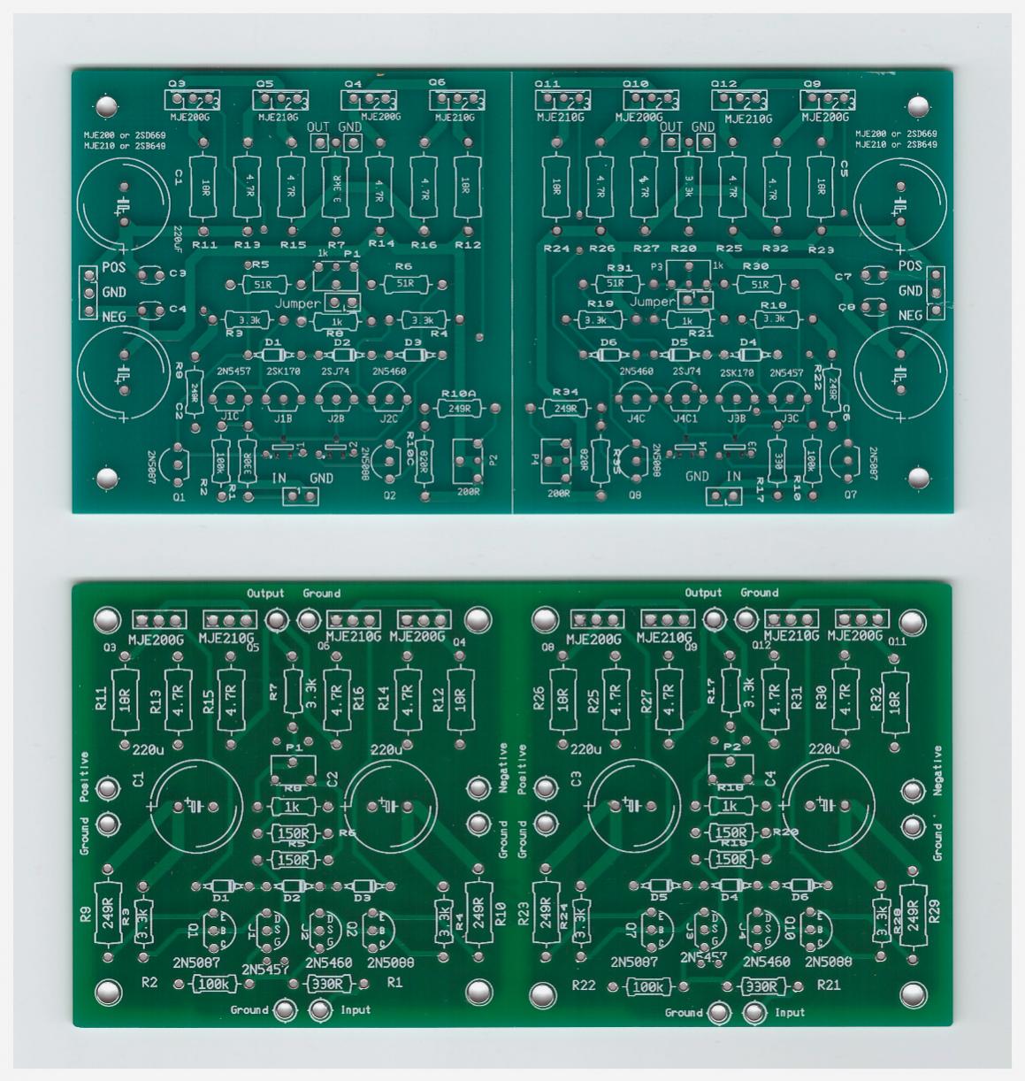

I have had a run of requests for boards -- ran out several weeks ago. I was thinking to modify a bit by providing for adjustment of the 2N5087/8 and allowing folks to use SMT input JFETs, or K170/J74.
Hello, jackinnj
Could you tall me about possibility to buy this modified version of board with kit.
Thanks a lot.
The boards are in! Offer remains the same -- $3 which is my cost (but you'll have to pay the postage).

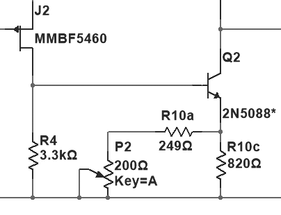

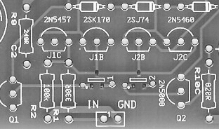

Layout is a bit different -- I allow for a potentiometer to trim the value of R10, you can use the TO-92 or SMT versions of 2N5457/5460 or 2SK170/2SJ74. The optimal size for the trimmers is the Bourns 1/4 inch variety.
The new potentiometer arrangement, layout, etc:
