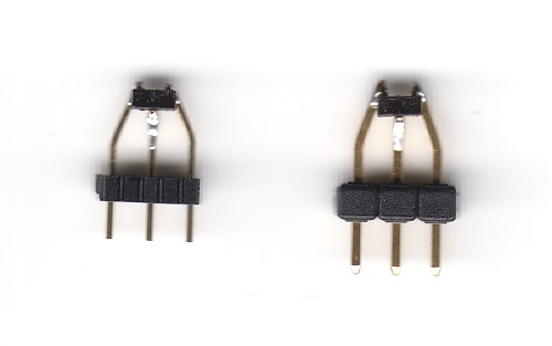

Sticking the SMDs to 50mil pin headers did not work as good as I wanted. Bending the 'legs' outwards for a 100mil grid frequently results in breaking them off from the carrier.
I found another way though: Bending the pins of standard 2.54mm headers inside with needle-nose pliers works a charm! It's a little tricky to hold them in place while soldering, but it's doable.
Please excuse the bad image quality, but I simply used the fladbed scanner (which seriously lacks depth of field) 😎.

Any of these pin headers are way too stoff compared to the SOt23.
So whenever you move one of them (e.g. by accident), the SOT23 will have to give.
In any leaded package, one has to build in mechanical compliance (flexibility).
That is why we did those adaptor boards. Not for no reasons.
Plus that the signal path is quite a bit shorter.

I could dip them into Epoxy for some stability 😉. They won't be subjected to a lot of movement once they're in their crowded case, though... And I doubt that the signal path is much longer than that of TO-92 devices.
