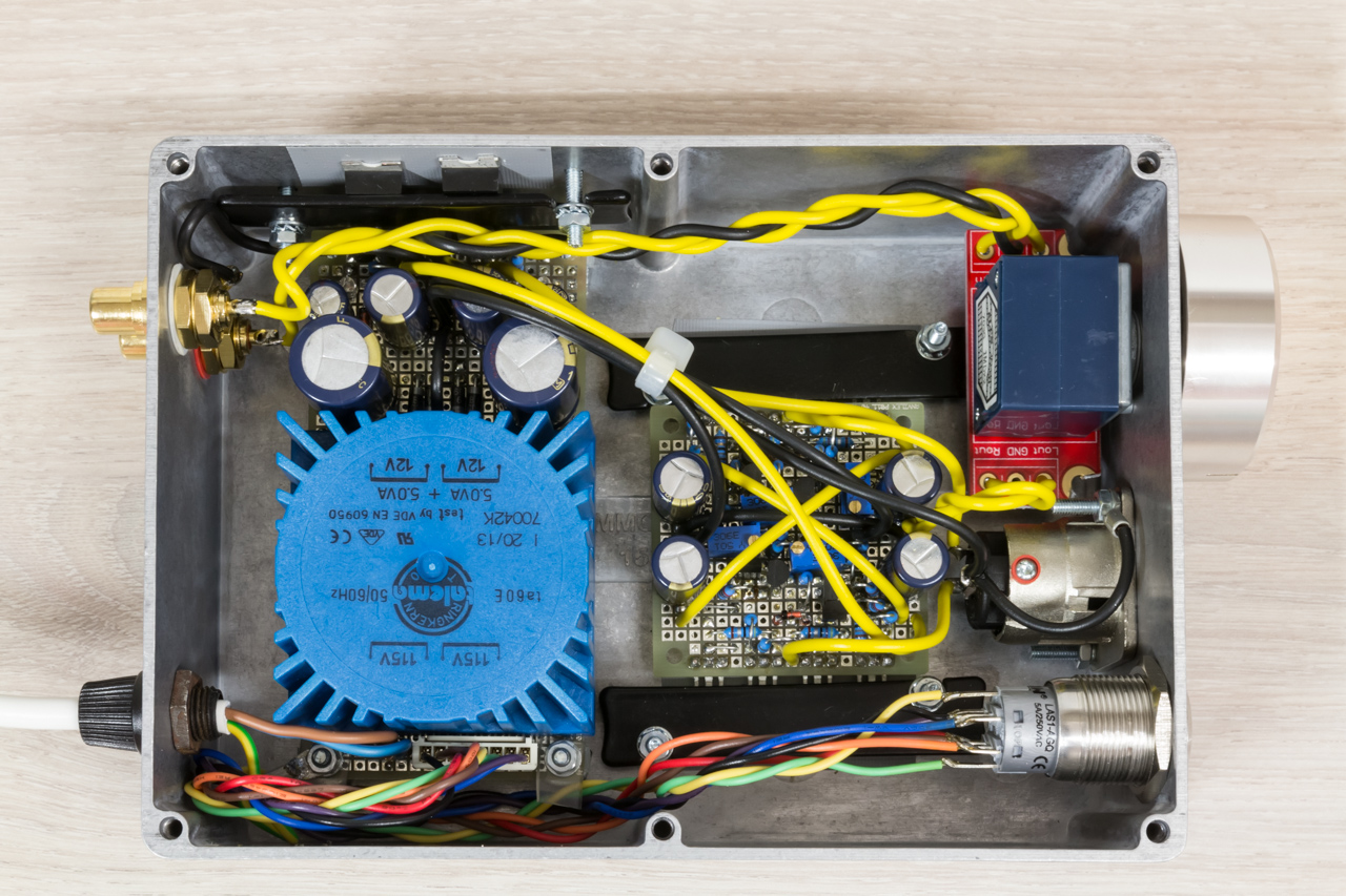

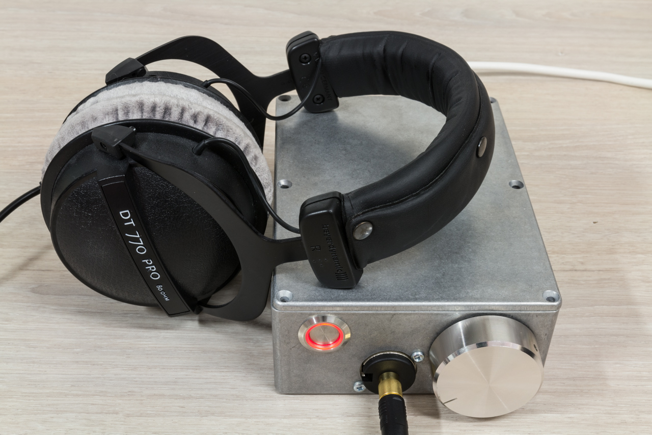

Here're some box shots FYI. I'm no fan of those Hammond cases actually, but they're cheap and easily modified.

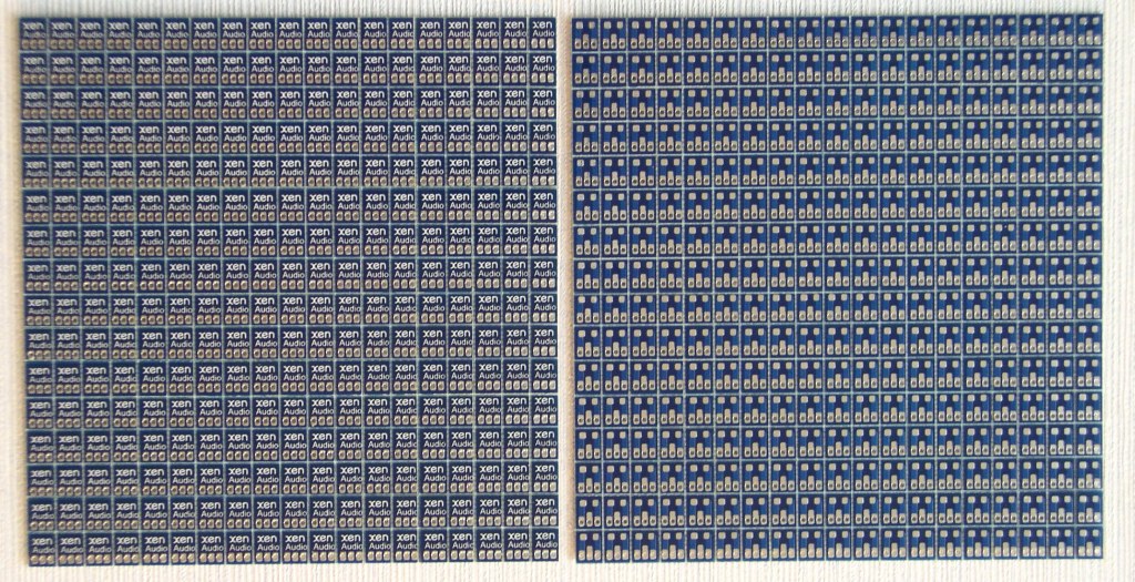

They are meant for our own use.
But we'll let you have a strip of 19x4 adaptors at cost.

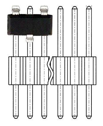

While it is hard to argue with Euvl's boards, I find the idea of soldering it to header pins to be extremely clever. IT is an excellent idea for anyone who might be using that particular smd package and etching boards at home. THank you.Thank you for your offer, but I'll try to solder them directly onto the 1.27mm pin headers first.
If you solder the part to the short end of the header, you should be able to spread the longer "legs" apart like it's possible with any TO92. Didn't receive any parts yet, but I'll tell you how it worked out.

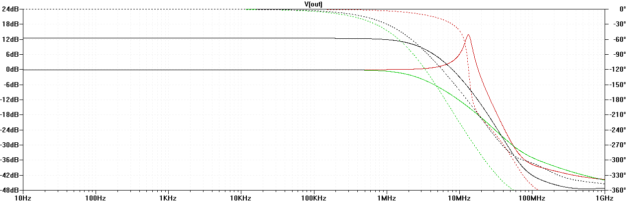

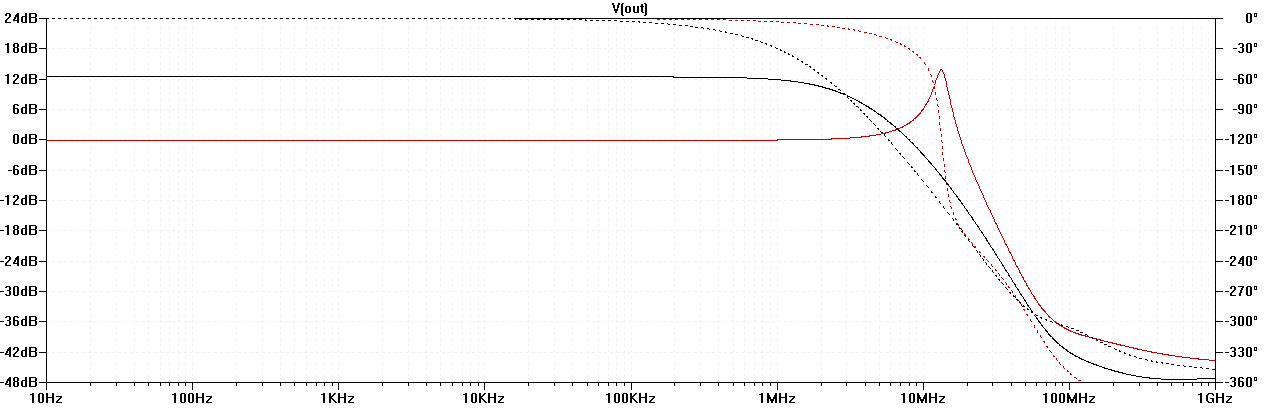

I am away from home so I do not have my Linear Audio copy with me.
But I used the schematic image at the LA website to make up a Spice file for the unity gain version, just out of curiosity.
The frequency response indicates too much gain in HF (> 1MHz) resulting in oscillation or very marginal stability.
Load is 60 ohm resistive.
Is it only a Spice problem and not in reality ?
Or does it only apply to the version with unity gain ?
Anyone did any Spice simulation before ?

Putting 100pF each between Base and Collector of Q1 and Q2 (I used BC550/560) results in the green trace.
Sims well, but I didn't actually test it.
EDIT: 47pF should be sufficient, yielding a higher bandwidth. Anything lower still shows peaking.
Dont forget to include the stray C from pcb layout..... especially if going to use a ground plane/shield.
BTW -- Which jFET P/N was modeled and whose model was used.... they arent very accurate as a rule.
What does the SIM's show for THD?
THx-RNMarsh
