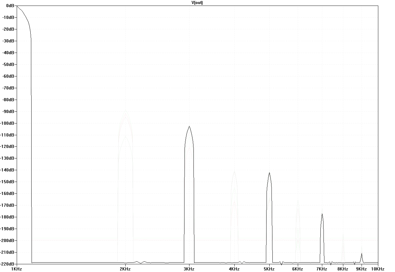

Here're some simulated THD results. Input level was 1.414V peak.
Green: Full circuit from Figure 8 with unity gain, 60R load, 2x47pF, EUVL's Models
Red: Same, but my models for substituted parts.
Dark Green: Buffer from Figure 7, 60R load, 2x10pF, EUVL's Models
Dark Red: Same, but my models for substituted parts.

Never the less, you have respectable results with your SIM. Most people in HighEnd and DIY do use some matching as I did here to reduce distortion further than unmatched devices.... esp useful when the NFB is not high. BUT the SIM data is with models of complimentary devices which are Not matched. When matched, of course, the comp devices are more alike than your SIM uses.... your results are closer to what you will get with unmatched devices.
THx-RNMarsh
THx-RNMarsh
3H should be lower -- see measured data on line # 698. I would Tweek device data until matches with measured data.
THx-RNMarsh
THx-RNMarsh

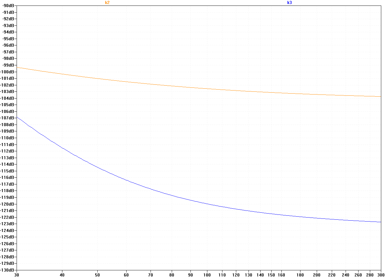

This time I used the full circuit and tweaked the output BJT's models to better match your k3 measurement. K2 can be lowered, but to achieve this I'll have to dig deeper into the FET models. Stay tuned 🙂.
The attached graph shows k2 and k3 over a load range of 30 to 300 Ohms.

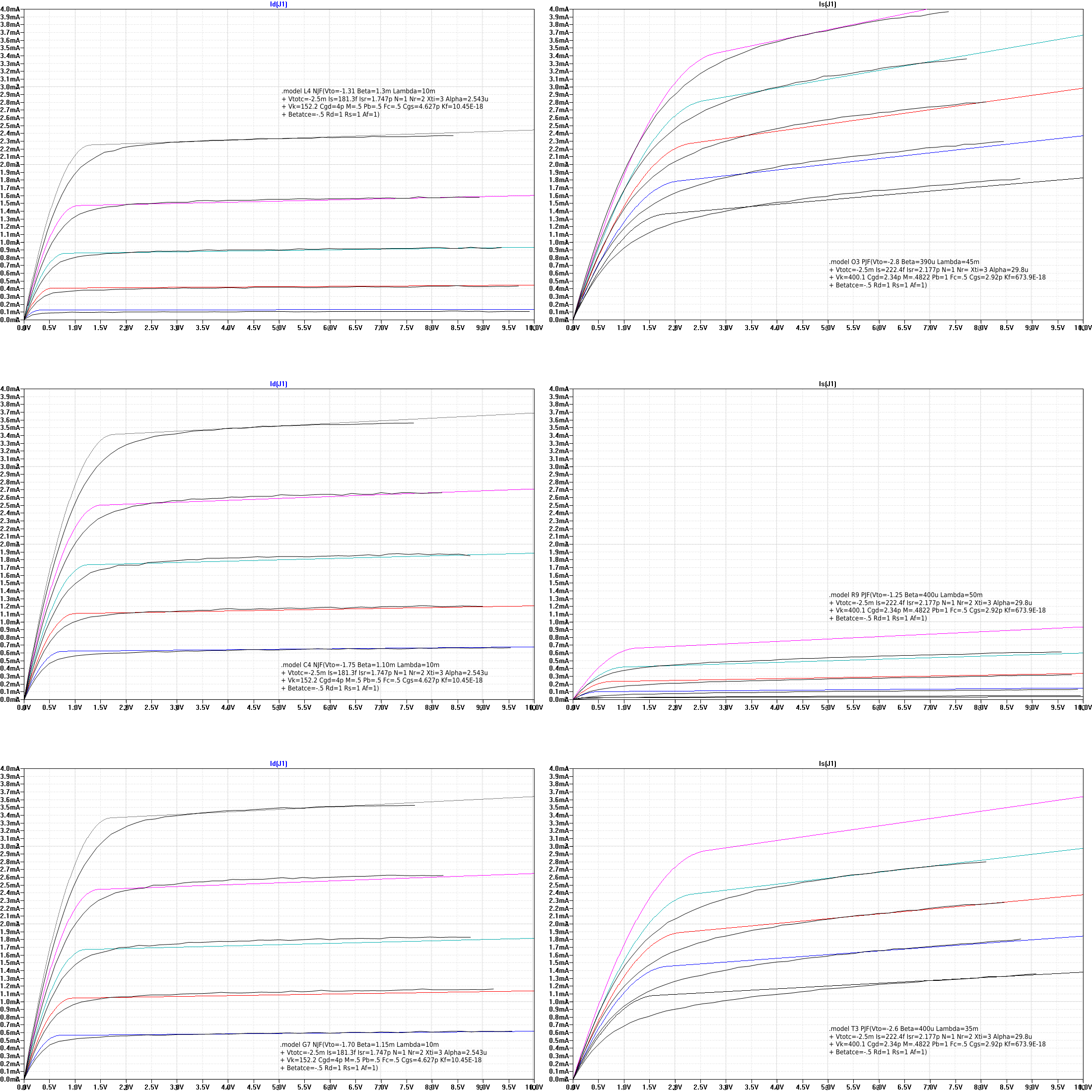

Just finished measuring up all those 180 tiny little FET's. Tedious....
On a first look there're absolutely no matches. If Vgs(off) is about equal, then Id is way off and vice versa. Gfs is nicely separated between NJF and PJF with a huge gap in between 😡.
Next up I'll try to tweak the models to closely resemble a couple of my measured results and then see which work best.

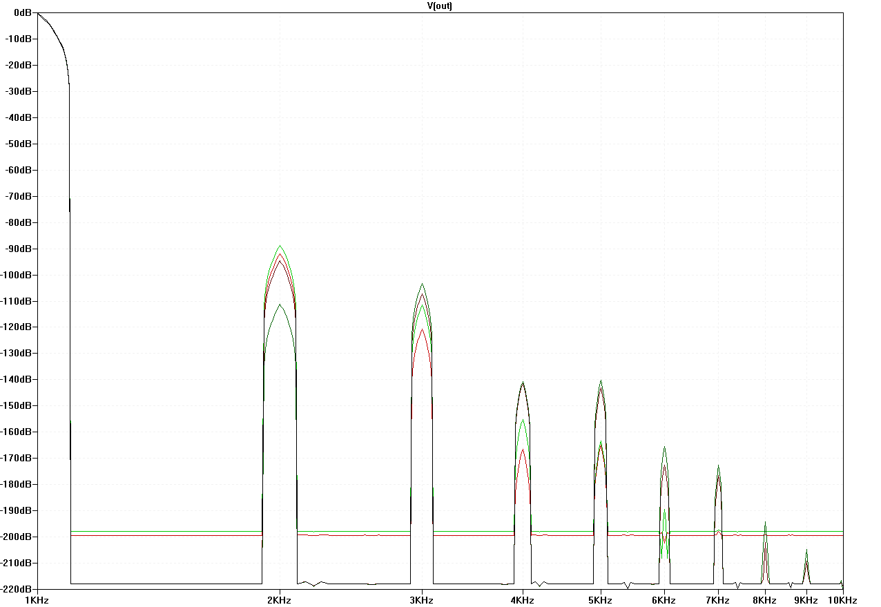

I arbitrarily picked three "complementary" pairs of my FETs and traced some curves. These were then used as the target to tweak the models using only three parameters. VTO was set to the measured value of Vgs(off), BETA was adjusted to match Id@Vgs=0V (this is the 'knee' where the curve traces start to run almost flat), and LAMBDA set the slope to match Id@Vgs=0V at about Vds=8V.
The first pair was picked for measured gfs, as good as it gets 🙁. The best PFET has 2.3mA/V while the worst NFET has 3.4mA/V. Total range was 1.8-4.2. This pair caused a huge DC offset, which was barely trimmable.
(Blue Trace)
Second pair was selected for a Vgs(off) of -1.70V, while the other parameters differed widely. This pair also caused a huge offset, albeit in the opposite direction.
(Red Trace)
The third pair was matched for a drain current Id of 3.50mA at the same Vds. DC offset was only marginal and easily trimmed out. A look at the measured curves below shows the overall best match of all this three pairs. It's still far from perfect though, cause all the other parameters don't match here, either.
(Green)
The first image shows an overlay of four simulation runs into 30 Ohms. The black trace is the result of using all standard models without any tweaks.
The second image shows the real world data of the used FETs. Please excuse the crude graphs; I simply stretched them to the same scale for easy comparison.
Note that the FET models were only rough estimates of the measured values. I'll probably try to create a nice overlay of measured and modeled data and then try to tweak the models further. The BJT models were tweaked already, albeit not perfect ideal matches.
(Blue Trace)
(Red Trace)
(Green)
The results just got a little worse 🙁.
Spent some more time on creating graphs and on fine-tuning the FET models. This time I attached an image where you can find both the measured curves (all black traces) and the simulated curves (in color) for comparison. They're still not perfect and I didn't consider any dynamic parameters, but it should to the trick, I suppose. Notice that VTO is not equal to measured Vgs(off), but it's a good starting point.
This time, for the second set of curves (corresponding to the red trace), DC offset was ~20mV with the trimmer at full stop, so it can't be set to zero at all. Which leads to the conclusion that matching the FETs for Vgs(off) is bull🤐.
On the THD side there's not much changed, except for k2 being about 5dB worse than before. Better models = worse results. Looks sound, doesn't it 🙄?
