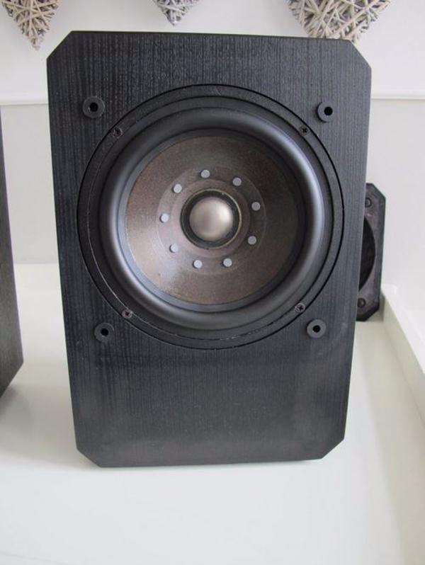

Maybe there could be be some effective taming of resonances by mass loading special points on the cone. See attachment with Pfleid Frs 20 loudspeaker (out of production since 1996).
However if there are peaks at resonant points I know from DSP use with my own metal coated paper cones that after linearization the resonance was completely gone in the waterfall response what is quite effective.
For this I always listened to every filter applied doing a variation in db, steepness of filter and wideness to check if the smallest application of it already does the job of eliminating the audibility of the resonance.
Mass loading special points on the cone could be done with removable material without damaging the cone.
