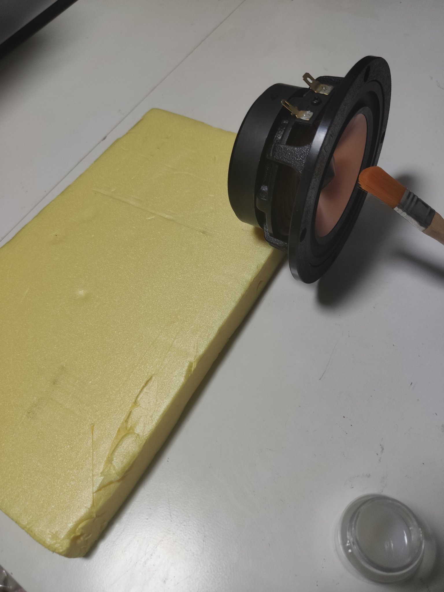

As mentioned in another thread I'm doing a cheaper driver before the Mark Audio Alpair 10.3, namely Michael Audio 4" AlMg cone (same cone size as MAOP 7), kind of an experimental edition of the "drum paper" 4.5-5.5" drivers I often praised. So I applied one coat of half-strength MicroScale Gloss to one driver (call it R) and couldn't even see a difference -- I thought both drivers must have been pre-coated already, the way the diluted liquid ran and pooled over the cone. Aack so much for "as little as possible"! I soaked up any excess, pooled, over-ran Gloss and waited 24 hours. First listened to tone sweep and R sounded barely fainter than L, easier to tell at high frequency but still not so definitive. Then I listened to music, swapping listening ear or channel hookup to try to prevent bias. The short answer is: L presented detail more up-front; R presented them fainter, but also the next level of detail. For example, the long trailing-off violin uber-high note was more pronounced on L, but the tail was actually longer on R. I was impressed. Overall more MAOPy.
Now a dilemma. As I laid on the first coat too thick probably, should I forego the second coat?
Too much will kill the top. You probably won’t know until you have gone too far.
dave
OK, I will set R aside and try to coat L as thin as possible, compare, then do L again (like climbing ladder). If the top is diminished too much (as I suspected it well might) I could add a small "plast-tape" whizzer.
p.s. Put down a nano-layer by rolling driver over a block a "step" at a time; dip and fully tamp out both sides of the "sculpted" brush and nearly dry-brush the lower cone sector below dustcap; repeat.
So the thin layer L got maybe half to 2/3 the refinement of the thick layer R, while maintaining a very small edge in loudness. Put another layer on L, a bit thicker and the dustcap too. Wait another 24....

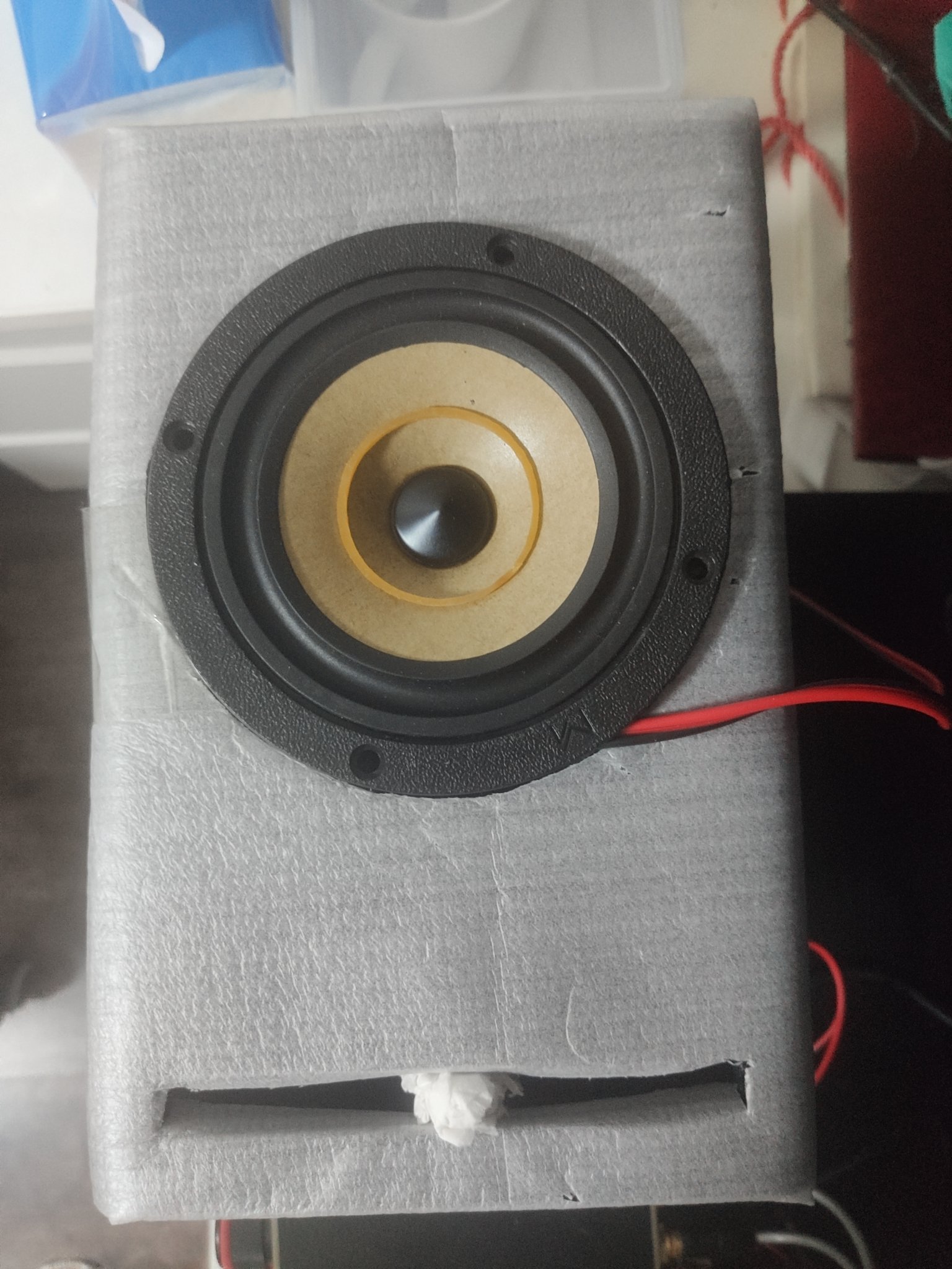

Comparing AlMg R to the original drum paper cone, R is a bit smoother and cleaner, more realistic sounding. The drum paper cone is more dynamic with better 10-12khz response (than even the untreated AlMg) hence more detailed, but also a bit resonant/cluttered. I placed a small rubberband on the paper cone up-firing and that solved the clarity problem -- dead heat between the two versions (other than small trace of sound character difference due to cone material). In their Michael Audio slot-loaded 4.5L cabs the AlMg has just a tad more 50hz but I suspect it would comp better if converted to TLonken or similar.
Will probably try "ringing" the paper cone with plast-tape or ZIG-glue or (even) EnABL-like spots. The paper cone is pre-treated with water-proof "nano" coating (haha) so probably no Mod Podge.
Michael Audio 4" AlMg cone: L (two thin coats) and R (one thick coat) sounded the same loudness at every khz up to 12, maybe 10-11 L was (at most) a hair strand louder. Music just fine, similar to Alpair 5.2 (from memory), perhaps not quite as airy and holographic. Against MAOP 7 (same cone size) the cheaper driver is a tad brighter, more detailed, dynamic, and open sounding, though not as refined, smooth, and focused sounding. Both in company-issue, high quality slotted BR; MAOP 7's 2.5 times bigger and a little louder at the port but they reached down about the same. (Both cabs will be TLonken in due time.)
I want to thank dave again for sharing the Gloss recipe -- transformed these $10 AlMg cones into >$1k high-fidelity sound.
