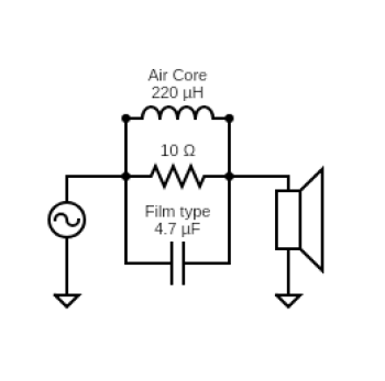

There is hearable cone breakup in with the Alpair 10.3, but it's mainly an issue when you listen very close on axis to it and it's easy to fix with an LRC filter (or dsp) if you want it. I heared the enabled version, and it also fix it largely, but i'm a bit clumsy on this kind of stuff, so i did not try it myself. It's easier to solder an LRC filter for it for me for my desk speakers in my office.
In my other setup, that is a waw that where i listen from a few meters distance, this is even not needed as the interaction with the room smooth that out. I use that setup now with a dsp, but did little eq on the top section, i mainly focussed to fix the bloated bass response due to the room. But in a former version with passive eq, i also used very little filtering on top.
