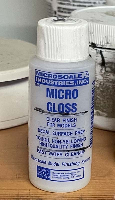

So i thot it would be worthwhile to try the simple mod lifted from EnABL that was most likely the cause of the ringing. So i did the penultimate step of the EnABL treatment, 2 coats of acrylic gloss (diluted 50%) on the cone and one on the dustcap. Sort of analogous to a dirt cheap MAOP but instead of electoning the topfew molecules of the cone, we add a layer many molecules think on top. The purpose of what i have is to paint over decals on model planes/trains/cars.
it is difficult, but possible, to reverse the mod.

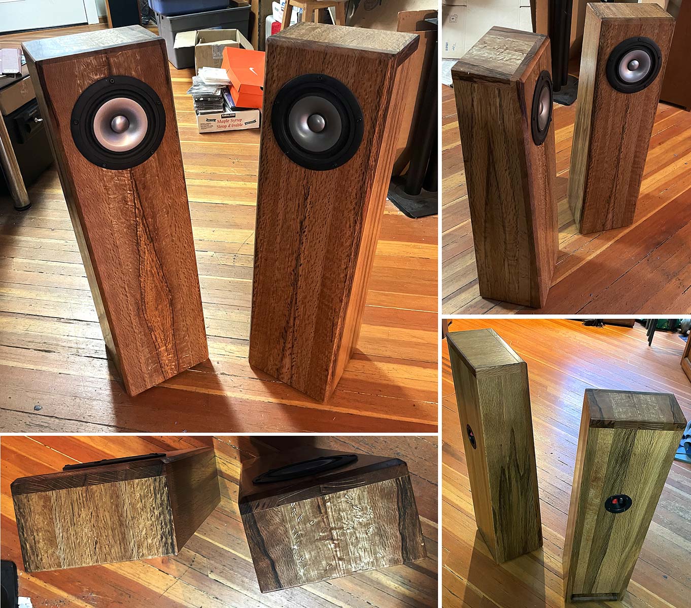

Bernie put them in these Compact Floorstander Mar-Ken11ms. These are high quality solid wood build like the Sibelius.
I had heard these stock (and also his Pensil/A11ms & FH3/A7ms builds). When they came back with these drivers installed it wasn’t very long before i thot i had something. A month+ in they have not driven me up the wall.

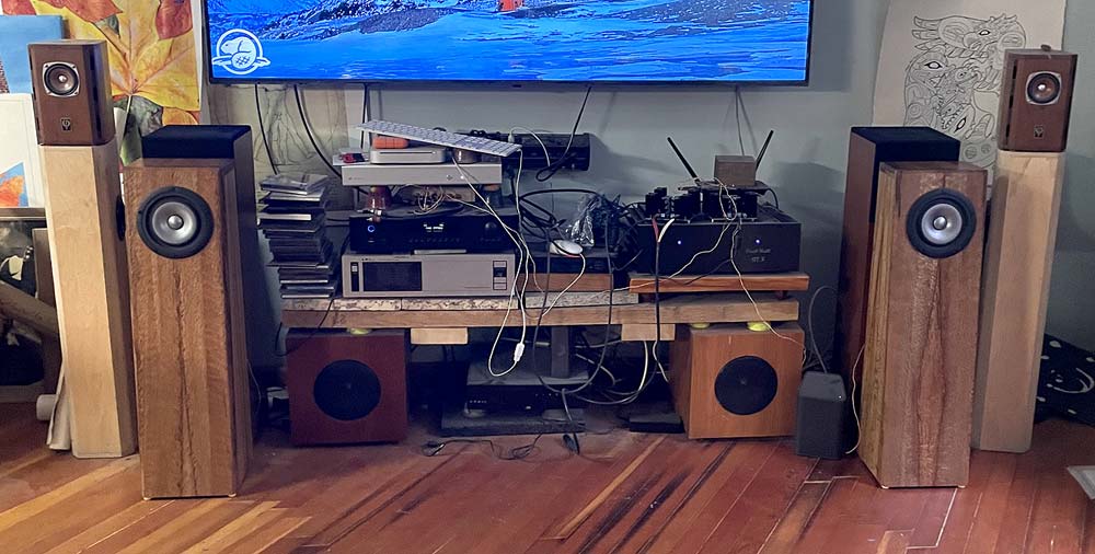

Not great light, but some alround shots.

Yikes can't find the MICROSCALE brand anything, only Tomiya and some local stuff....
edit: found it, hope still in stock
What size brush, and dilute with water or alcohol? Thx

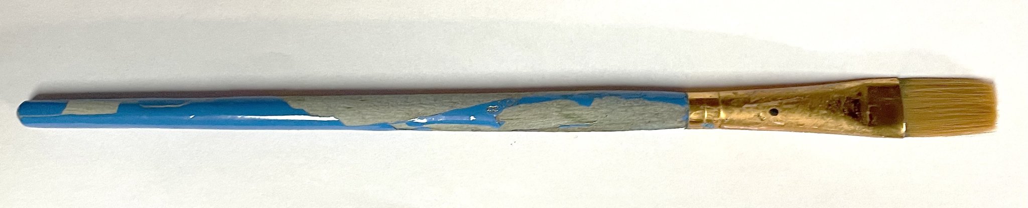

About a cm across, synthetic bristles.

Yes. Dilute with water. Distilled preferred i guess. My tap wate ris pretty good.

You want to apply as little as possible and still coat the cone, more so on the second coat, evenly.
More will suppress more top. In some cases that might be beneficial. But much easier to apply than remove.

I am sure there are lots of acyrilic recipes. Many of them probably work.
