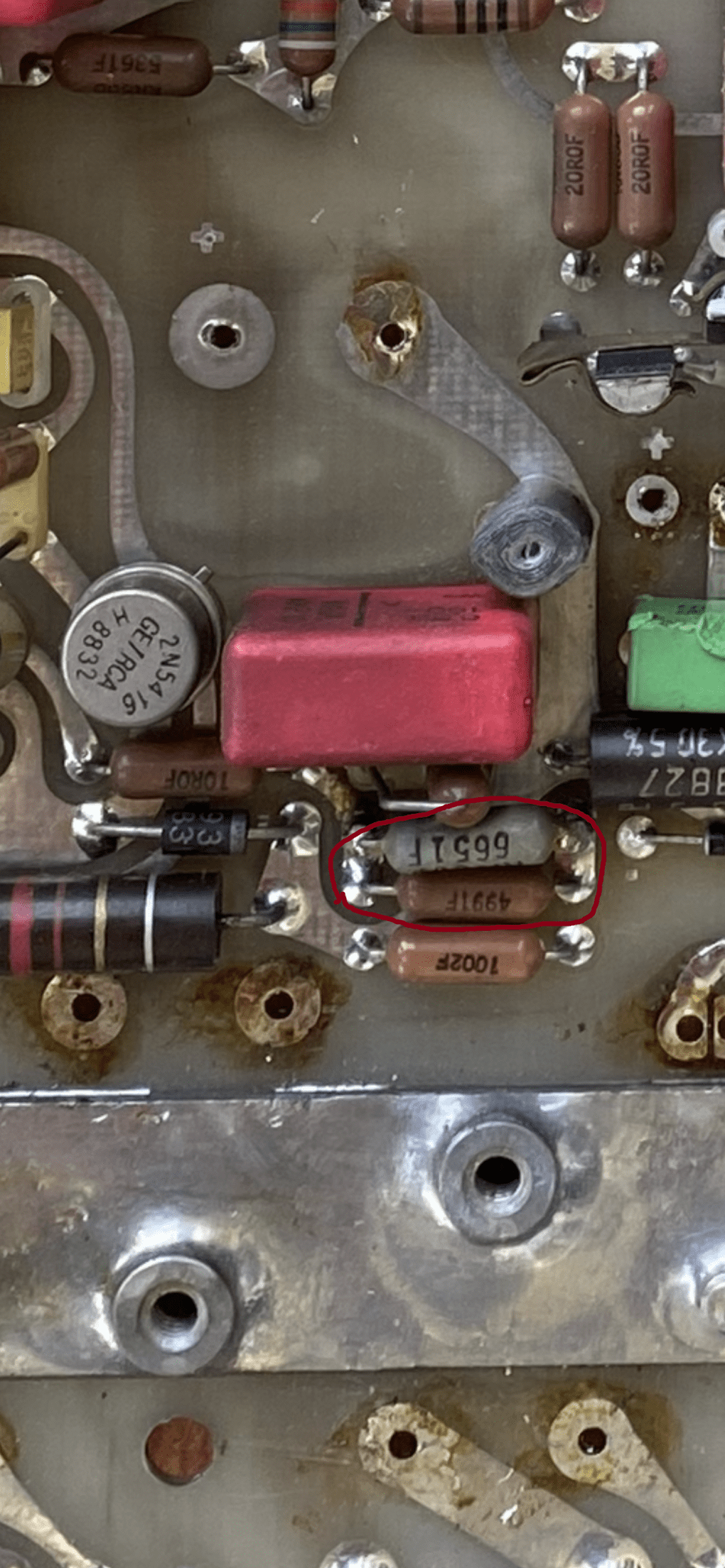

Thank you Handel for reference to the schematic page. I was able to verify the resistor is indeed 11K and 2W. You may want to consider replacing yours since this was apparently the source of failure. As mentioned earlier, I measured mine as 30 Ohms, a relative short, which would explain the burnt out part and slightly toasted circuit board. The resistor is connected to the LED which would explain what was done before. I noticed someone else had a picture of the soft start board where his resistor was replaced as well.

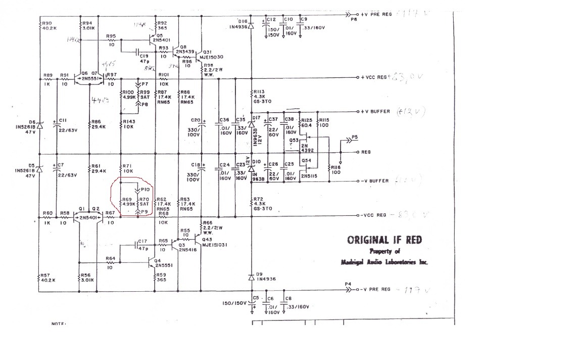

Thank you very much. I just realized that I can't find these details because I don't have the schematic. Therefore, I need to study more about testing to figure out how to determine the SAT resistor value. I can't take the measurement because the SAT resistor in the other section is burnt.The lower is the R69 and the upper is the SAT resistor(specified at test). I think the only way is to take the SAT resistor off and measure it to find the value. See attached voltage regulator schematic.
