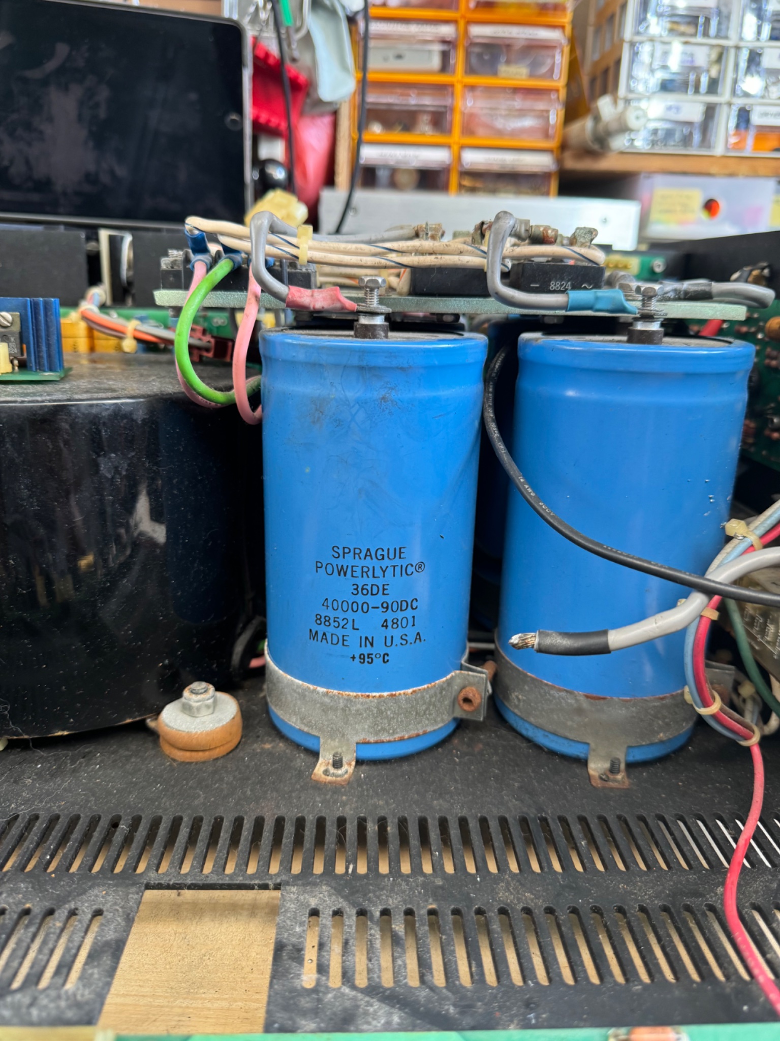

When dealing with old equipment like this amplifier is there anything you recommend replacing while you are already in there troubleshooting or are you of the mindset if it isn't broke don't replace it? I was just curious, because what you did obviously took a lot of time and labor.

For class A amplifier like this one, usually the electrolytic capacitors are the first to fail due to the high temperature inside the enclosure.
Some people just replaced all the electrolytic capacitors regardless of condition but just on age.
I like to test them first especially in old high quality amplifiers before I changed them. The capacitors of vintage years, found from experience to be very well manufactured.
One real incident to relate here. I was tasked to replace a bunch of electrolytic capacitors from an old Audio Research Amplifier. The owner had order modern new capacitors for me to replace.
I measured the old ones first and found out that the capacitors were still holding their capacity and the ESR were actually better than the new ones.
I recently repaired a Krell KSA250. The owner also wanted to replace the large computer grade electrolytic capacitors. Those are very well made and very robust. I measured them and they were perfectly fine.
In summary, if the capacitors are easy to replace and you are substituting with audiophile grade capacitors, I would recommend to go ahead and just change out all the old ones.

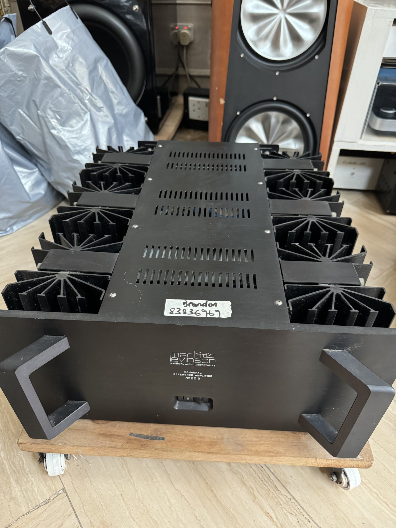

Thank you Mr. Lim!A month ago I was contacted by Brandon at the DIYAUDIO forum. He had seen my post on Krell Amplifier repairs and asked if I am able to help repair his Mark Levinson No 20.6. One of the monoblocks was experiencing a fault and and kept tripping and shutting down the amplifier.
I said sure. Little did I know that I was embarking on the most challenging task in my last fifty plus years experience in tinkering with amplifiers.
It is going to be a long story and I will start updating this post moving forward. View attachment 1399465

I got a chance to buy the ML 20.6 about three years back. There're some issues so I only switch them on occasionally for listening music.
When I switch them on, it will be either on or almost immediately shut down (trigger protection?) If one unit of ML20.6 can be switched on, the other one (totally two because they are monoblocks) can be switched on. Whenever one unit cannot be switched on, the other unit cannot be switched on. How can both units have the same problem at the same time? When they can be switched on, they can work hours until I switch them off.
Please could you give me some idea?

Glad you found my post useful. I learned a lot over the years through forums like this. So I wanted to share my experience so others can learn from it too.
The protection circuit monitors the following :
1. excessive DC offset at the amp output
2. Over temperature.
3. Over current / short circuit
4. Unregulated power rail over voltage
5. Regulated power rail over voltage
My guess is that it could be fault no 4. 1,2 and 3 are unlikely as both amps always behave likewise at the same time. As for no 5, once voltage regulator fails it will always fail and not recover on both channels at the same time.
You are from UK? Mains is 240V ? The unregulated voltage rails will fluctuate with the mains. Check your voltage selector setting. Could it be set like 220 or 230V instead of 240v?
I was thinking there may be a component failure on the protection board just like the SCR in my case but your amp failure symptom of both working and failing at the same time suggest same fault at the same instant which may point to environment like temp and line voltage. Unlikely to be temperature as it is also unlikely that two thermal switches fail at the same time.
I call this kind of fault finding as looking for gremlins. Makes very little sense.
Of course there is always the brute force approach. Eliminate one fault at a time even though it may feel unlikely to be the cause like I did on the protection board.
Take a look at me post with the highly marked out protection board circuit and go from there.
