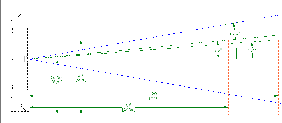

I noticed that the driver is only 26" from the floor. What would be a recommended way to raise this? Could front baffle be recessed making the height of the cavity longer (resulting in a C-shaped side panel and leaving the vents the same dimensions)? If internal depth is reduced to 5", it would raise the driver 10.5", and 6" would raise the driver 6.25".
One thing you should be aware of, the frame lip is 6mm (~.25") and it's not solid. Recessing the driver takes a considerable chunk out of the baffle. And although the drivers include a (thin) gasket, you may want to fill the back side of the frame flange to ensure it seals or use an alternative, thicker gasket, especially if your route was not smooth. Lastly, the mounting holes are small, #4 screws only. Two more mounting holes would have been nice. You may want to use a positive mounting system, like t-nuts. Fortunately, the flange is wide and leaves a good amount of material behind it. Some kinda supra- or double-baffle might be worthwhile, or surface mount on the baffle and use a 0.25" trim panel (fortunately, it's a common material thickness for lots of different woods.)
In practise this is not really a hardship. Listening a bit off-axis is often a good thing to avoid the beaming inherent in most FRs. And if you wanted the driver firing right at your head, it wouldn't take nuch of a lift of the front of the speaker to do so.
Further, discuaaiona with Chris on driver placement for a dual-driver version (Scott comment please), we will probably move the front driver up a half basket width, and the side driver down a half driver width so as to maintain Zd, keep the drivers close together, yet decrease the reflective surfaces of the back of the drivers away from the other.
When you consider the base we'll add + that change, driver height becomes 31".
The diagram assumes that a minimum stabilization base has been added.

Regarding driver height, Dave will probably be revisiting driver placement and bracing configuration when using a side mounted second driver (a la Calhoun) .

and yes, even with substantial ballast in the lower void, these will be very tippy, and some type of extended width plinth would be required.

Re height, angle it backward. 3 - 4 degrees would be sufficient in most cases. You can't recess the baffle etc., or alter the shape of the driver chamber in any way without a total redesign.

Thanks for the responses. I should have realized a base would be needed (of course, I would have after building them. :bigeyes: ) I rarely just sit and listen. I'm always moving around, but the "beaming" from the CHR70 isn't bad. You have to be a good angle off-axis to notice a drop in response. Certainly outside the "cone" illustrated by Dave. It'd be good to see some polar response charts for this driver.
