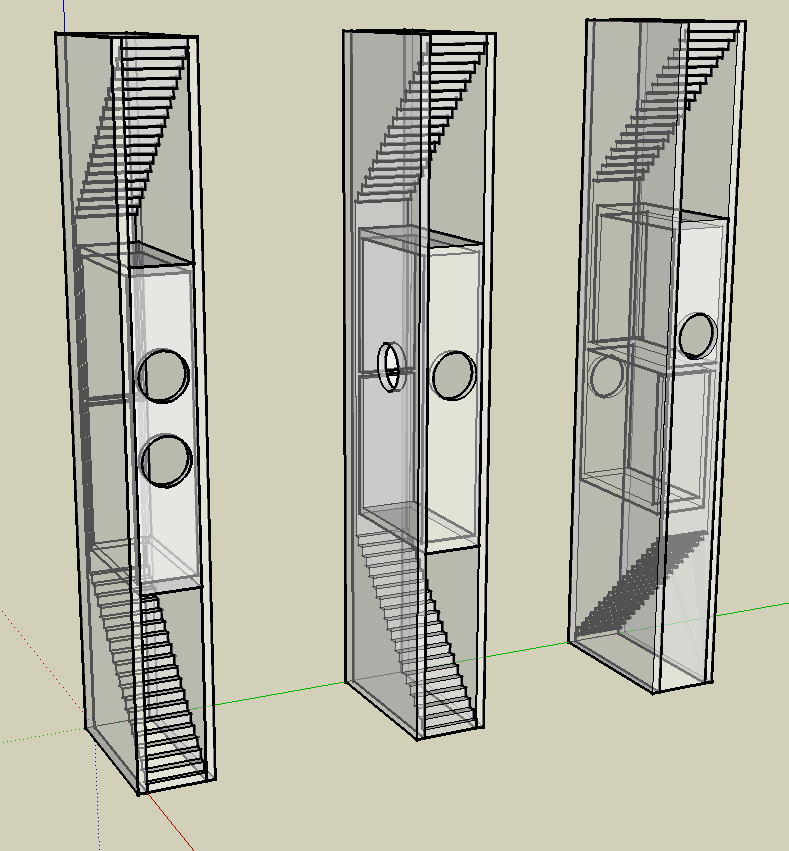

You mentioned the Calhouns but they have 2 drivers in the front baffle even though Scott said this was a bad idea.
The only pairs that have been built have 1 on the side & 1 on the front and an MTM... 2 FR125SR on the front is not recommende. The 2 on the front was for use as an MTM or as a 1.5 way (box done for WR125 originally, so they have a tweeter)
Attached are the options we proposed for driver mounting.
dave

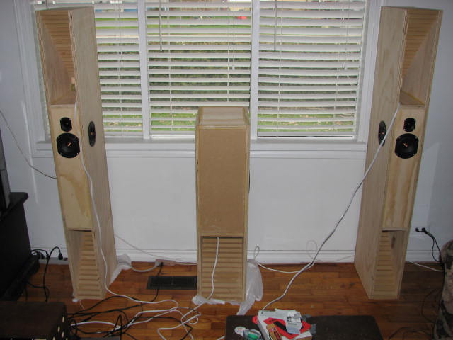

I'm finally sitting in front of, and listening to, my dual chamber reflex CHR-70's...
These speakers are incredible, even in their fresh out of the box state. The midrange is excellent and the treble is very articulate. The midbass is a little "slow" but the depth of output is better than expected. They're already showing the limitation of the source material (MP3s). I can't wait until they break in.
I think the enclosure choice was a good one. I took pictures and will post them when available. I used slots for all 3 ports. I choose an internal depth that was equal to the ports width. The 2 external ports exit on the side, and the crossover port is the entire divider between the two chambers. Overall dimensions are 21.5"x8.5"x5". I used 0.5" materials throughout. The driver frame is quite thick and thus I decided flush mounting would not have left enough material to support the driver. I really should have used 0.75" for the baffle. Next time. More details will accompany the pictures.
Thanks Mark Audio for putting out such a great driver at such a great price.
