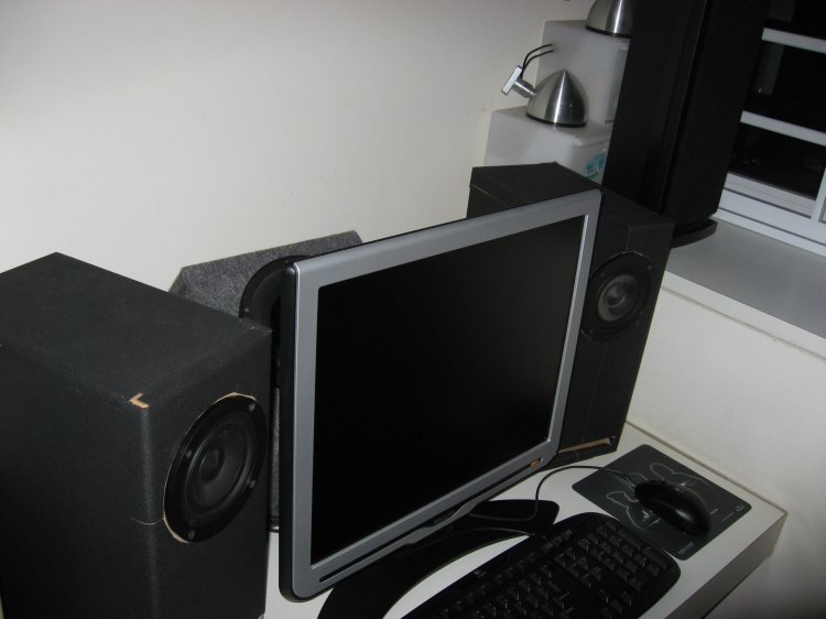

i just got a pair of CHR70s and proceeded to put them into a 7ltr front slot BR that i had previously used for the CSS FR125 .
after a couple hours of playing some bass heavy track for burn in, I took a listen and yup, they're truly very nice. Compared to the FR125, the CHR70s are louder, had more detail and better highs.
I like these and will choose them even if they have the same price as the CSS FR125.

Nice! That makes me even more excited to try out the ones I ordered! What are those enclosures tuned to? Where do you think your low end starts to roll off?
