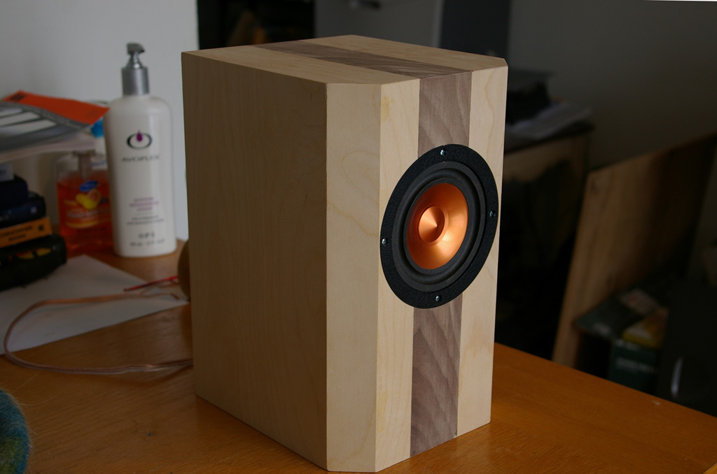

Now that they're finished I'll go ahead and post these here!
Nothing super fancy as far as box construction goes. These are just sealed with some basic bracing. I haven't even tried any stuffing yet. I'll play with that sometime when I've got my measurement rig all set up.
This is me playing with new construction techniques. The box is entirely miter joints, "birch-ply", with a 1/4" walnut inlay.
They sound pretty good! I was worried they'd be a little bass starved in the sealed box, but they're not that bad at all, and since I'm using them near-field and generally not cranking them too much, they'll take a pretty good deal of bass boost to suit listening tastes with no ill effect.
I get to keep these ones 😀 Next up, a similar styled box with Alpair10s, ported, for my roommate!

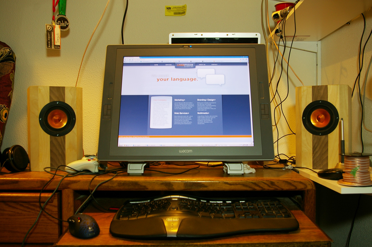

wow! i mean is it a wacom tablet monitor?
btw your building is gorgeus! with the colors of the monitor and the walls they do a very good job at visually disappear.
hope i had your skills at putting wood togheter...
since its an all computer rig you can try something like the sealed alpair-5 pushed to 20hz flat, to see where the chr-70 can arrive nearfield... there is a thread here explaining how to get powerful VST equalizer under win and foobar
ps. are you using a right-handed mouse with your left hand?
Yeah! It's a Cintiq 21UX. I do a bit of illustration/animation, and I have some RSI/muscle tension issues in my arms. The Cintiq is FAR more ergonomic than using a tablet. My roommate actually owns it, but we're working on some video game development and I'm kinda the lead artist for what we're working on so I get the honor of using it, currently 😀
Ooh, yeah, I remember reading that thread awhile back! I will indeed have to give that a shot!
Yup! I use it in both hands. I have a second mouse that sits to the right, too. I like to switch back and forth as my right arm otherwise gets way too tense and painful if I'm using it all day.
It took a little getting used to, the left handed mouse thing, but it's not so bad for just basic clicking around. When doing serious work and/or gaming, I swap to right hand

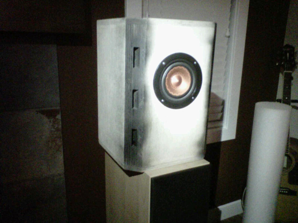

Hey folks, here's my effort - using Dave's splendid mMarS design:
Did these as a practice build before trying some newer wall-mounted designs. Terrible iPhone pic, and currently only finished in primer (not sure what final colour to go with), and lacking stuffing, but sounding good nonetheless!
Powered by my t-amp, no filter, used 1/2" roundover instead of flat bevel due to lack of table saw.
Thanks to all who've contributed to this thread - it's a great resource!
