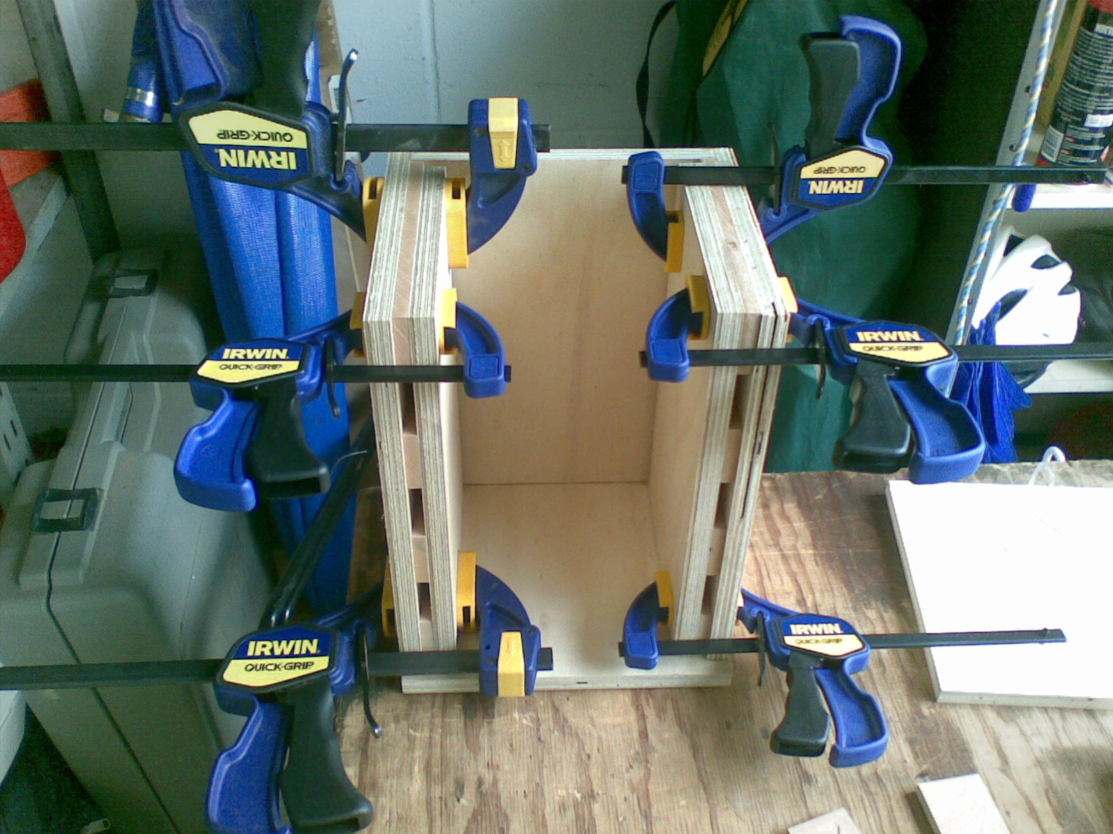

dMar-Ken70 progress picture:
attachment.php
Nothing very exciting yet, but now that I've got a few of the tricks down, the second box will go together pretty easily.
That's what's slowing me down - those are all the good clamps I have, so it's preventing me building the second box.
Notes for those who have built Onken's before: you'll note that the outer walls seem longer than strictly necessary - they are, but only because the bloke I had cut the timber got lazy and cut 12 backs instead of 4 backs and 8 sides. Doesn't matter, they'll get lopped off.
Further note: using a nailgun (and glue) to build up the side wall assemblies saves a lot of time and clamps 😉

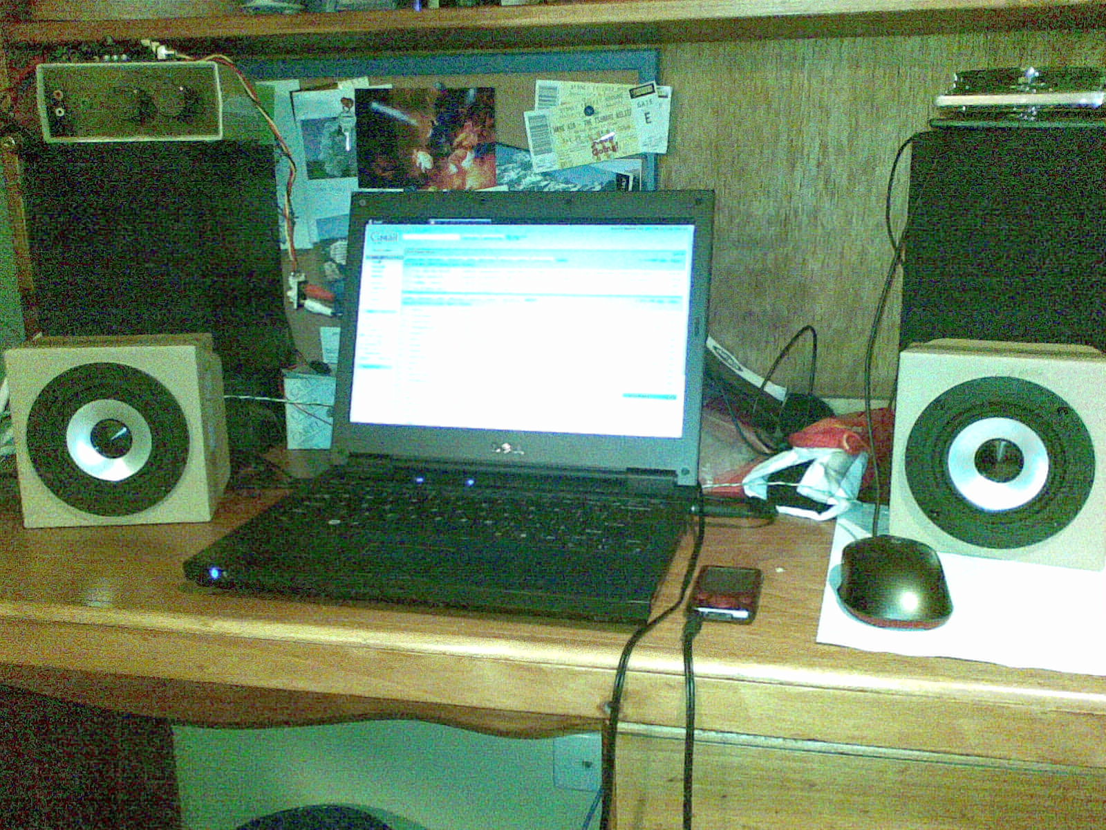

Hey Dave, I've got a new project for you - the uMarOB-70 😀
Construction takes only seconds - indeed, everything you need is in the box.
Bass response could be said to be a bit thin, in much the same way that water is a bit damp, but even like this these drivers are very involving. I was only going to set them up downstairs to break them in, but they appear to have ended up on my desk 😉

Haha, that's brilliant! just the driver "in" the box, wired straight to the amp?
Yeah, when they're shipped they're supported in the box by a bit of folded cardboard - add a bit of tape to keep the cardboard box-shaped and screw them in with the supplied self tapping screws and you have something that sounds damn good for the invested time, if not for the money 😉
