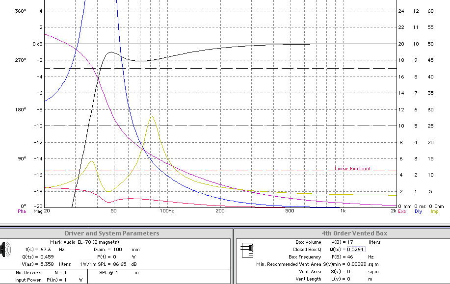

I used WinISD to calculate box for CSS EL-70. Do you see there is some major problem with my design (see pic)? Volume is 17litres and tuning 46-47hz. There would also be little driver brace inside (like in pensil70).
I like this shape of the box (tall and narrow) (now 1235 x 180 x 137).
As in above post, your design is an ML-TL and the BR sim won't reflect what is happening.
And even if made a BR, it is not all that pretty. The dip & the bump up should be avoided.

hmm. You're right about halfTower. That design is only 35mm wider than what I had in mind (if possible I need more narrow). It's also shorter but can be "lifted" - halfTower is 838mm tall. I need to make it about 1200mm. Does half tower lose it's meaning if vent is done like this:
iiiiiiiiiiiiiiii|iiiiiiii |
iiiiback |iiiiiiii | front
iiiiiiiiiiiiiiii| ___|
iiiiiiiiiiiiiiii|____ <--- square or pipe (tuned to halfTower 42hz)
iiiiiiiiiiiiiiii|iiiiiiiii|
iiiiiiiiiiiiiiii|iiiiiiiii| <-- lift to 1200 (stuffed)
______|____|_______ ground
Annoying picture (sorry) hope you get the meaning..
Also it is possible to make it more narrow (more deep).

The cross-section can be changed as long as area remains the same. One has to be careful if made too narrow. This brings the sidewalls close to the driver and can cause a "cupped" or "chesty" midrange colouration. Port can be moved from the bottom, to the front, back, or side. Just keep it as close to the bottom as practical. You can mount it on a wall, or lift it up as required.
