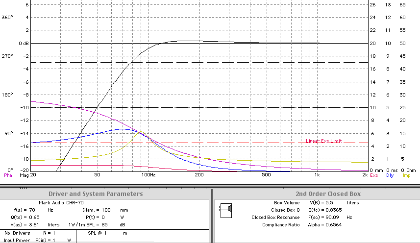

Hello,
I plan to build a MMAR for Markaudio CHR-70.
The box is indeed closed. I need a blocking circuit to adjust the Lausprecher or does it not?
Have summaryplot frequency response and efficiency of the box? What must be insulated?
The box stands on the desk near the wall.
Michael
Where you will be placing the loudspeaker you probably do not need a filter. Simulated FR is attached. Efficiency is the same as specification for the CHR-70 at 84.5 dB. You can looslry fill the box with polyester wool or line the walls with 1/2" wool or cotton felt.
dave

@planet10,
is the Alpair 7 better then the chr-70 😕
Fits the Alpair 7in the same mMars as the chr-70.
none of us @planet10 have yet to hear the Alpair 7, but even so the question of "better than" will probably be best answered as: "maybe - that can depend on your criteria" (i.e. is it a better match/value for you)
for example, I happen to prefer the paper coned (CSS branded) EL70 over the CHR70 in normalized versions of 2 quite different enclosures with which I've had opportunity to spend much time ( i.e the milli-size series, and the microtower), but as always, YMMV
The milliSize sealed enclosures are 5.5 litres and about as small as i'd go.
I see lots of FRs from Germany (i guess mostly from Timmermans) that have filters with more parts than some of my amplifiers, so i'm guessing that is where your question comes from.
I avoid filters as much as possible, and that is where i'd start if i were you. I know the German diy magazines have covered both of these drivers, if you find after you have lived with them for awhile that you feel the need to play, then i'd use those as a starting point.
dave
