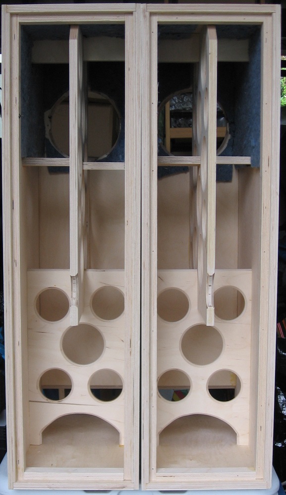

Holy crap! (pun intended) Very nice job, but that's a lot of work. How do you ensure the braces fit snugly (and are glued tightly) along their holey length?
Basically built from the inside out - in the case of the Tannoys, the interlocking space frame was built first, then the exterior panels (1" MDF at the client's request - so just guess the total weight 😱) were dadoed and wrapped around that.
The Fostex boxes weren't quite as as laborious - start with back, top and one side assembly, use spacers the same width as lateral braces to ensure long brace is square, and clamp / cold press. Then repeat with the second side, and bottoms.
I find it pretty hard to slow down enough to take many photos during the assembly process
Ok, I can't seem to find any pics of other Pensils and their bracing, but the normal procedure is to build the cabinet and then creat ones own solution to the bracing. Must it run from top to bottom of the inside?
Yes. It is both the most effective* and does not impede the vector of the 1/4 wave resonance.
*(the brace should divide a panel such that the sub-panels have a higher aspect ratio then the panel being braced)

Thank you for the picture. It should be possibel to complete as I have a plunge router.
