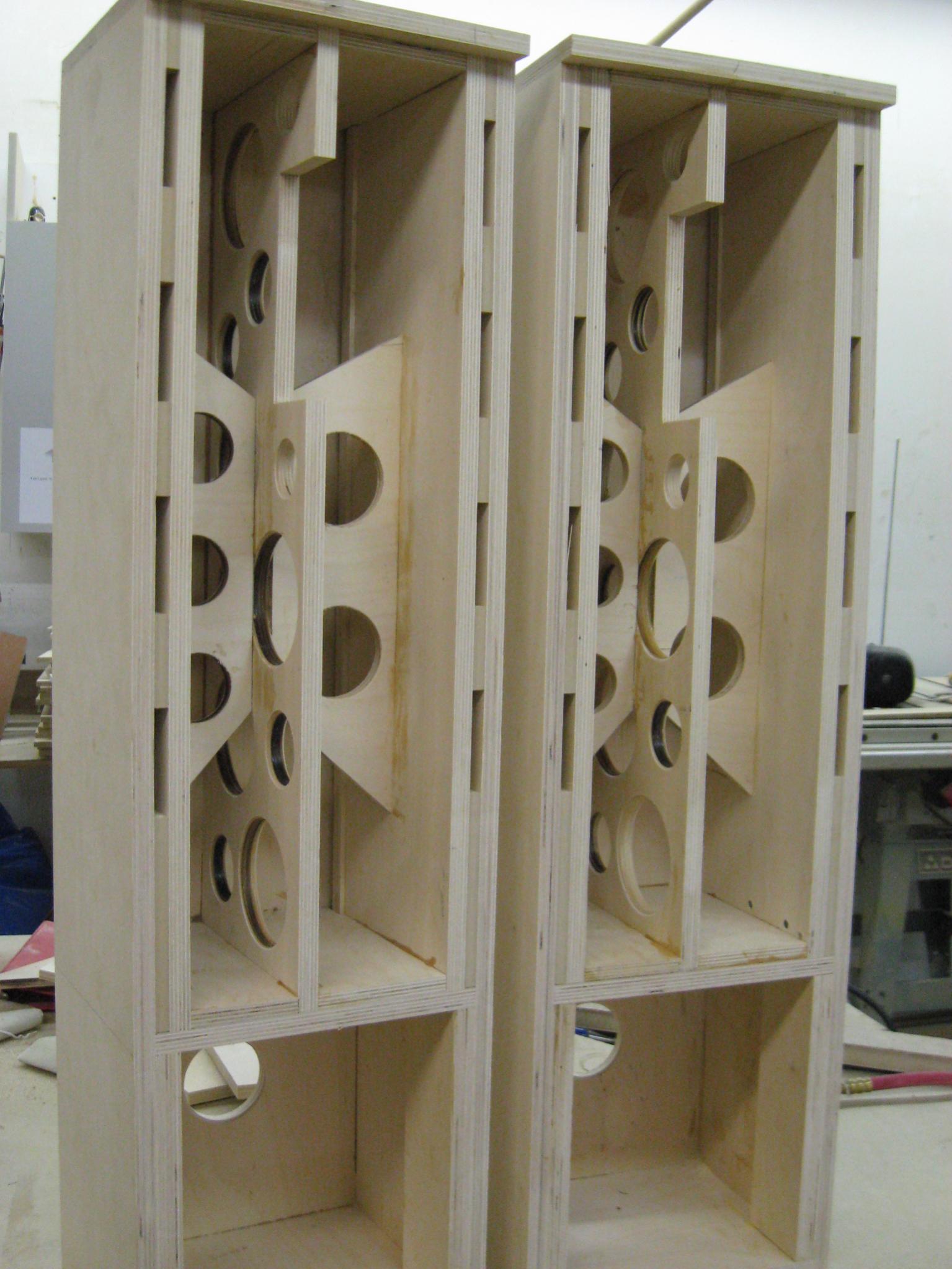

Maybe I am mistaken, but looking at the Pensil10p drawings, it refers to bracing
"3/ bracing is optional. For bracing ideas plase see the bracing sheet in the superPensil12 plans"
In the superPensil12 plans, the second sheet explains the hole filled bracing system.
The holey brace will stiffen the cabinet and draw reactive energy from the driver to the back panel (where it will be less noticable and share energy across multiple panels). In the larger versions additional side-to-side braces below the driver are also recommended. Holes mean to reduce impact on internal volume and to increase the complexity of any side-to-side, front-to-back standing wave structures.
The holey braces cab take as much time to do as the rest of the box, hence them being optional. We (Chris & i) would not build a Pensil without them.
dave
dave
Braces as elaborate as these?
http://www.diyaudio.com/forums/markaudio/187179-super-pensil-build-pics.html
Those are very holey braces. Nice.
I suppose if you had a router you could make them even fancier.
~Tom
~Tom
But is it neccessary to have such big braces, and from the design it seems it has to fit exactly behind the magnet so that it is fixed in its place?
Is there any theory on how big hold and how many, or just to find a balance between strength and holes?
Concerning Mass-loading, is it important to "block" the air so that there is noe direct path through the speaker except having the air pass through polyfill?

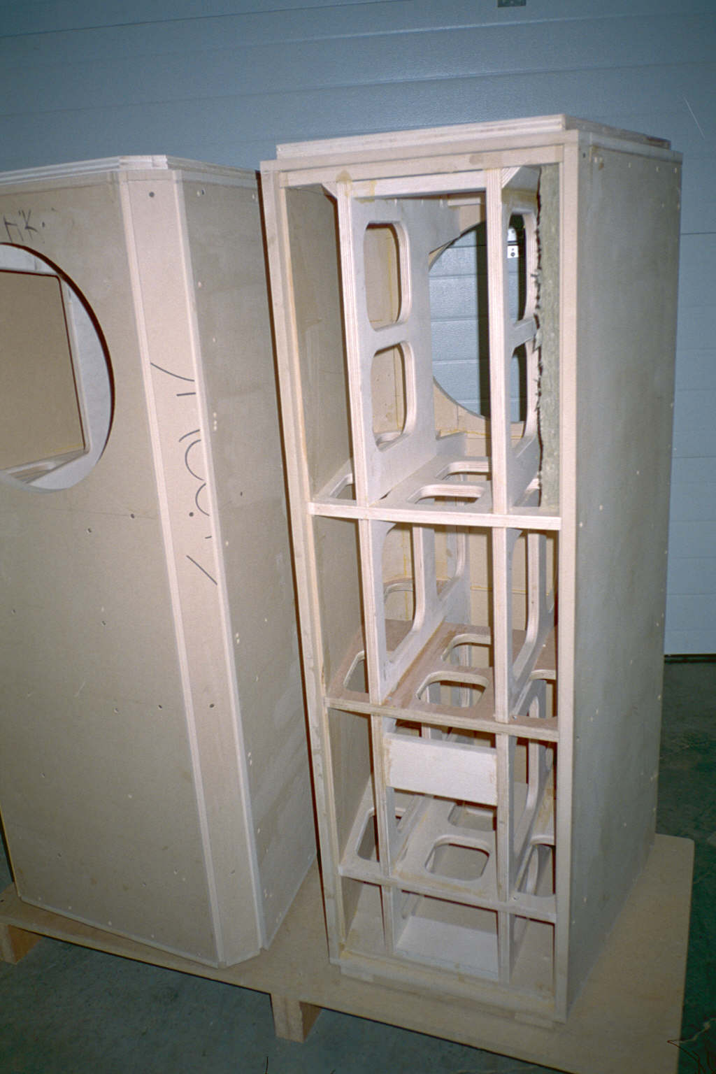

Jan - yup pretty much - the cross braces don't necessarily need to interlock - that can be a pain on really large enclosures - as long as they fit tight
the left hand enclosures were for Tannoy 15" DC Gold monitors - braces all CNC machined, the right hand for floorstanders for Fostex FE167E - by hand
CNC wins every time
CNC wins every time
Holy crap! (pun intended) Very nice job, but that's a lot of work. How do you ensure the braces fit snugly (and are glued tightly) along their holey length?Jan - yup pretty much - the cross braces don't necessarily need to interlock - that can be a pain on really large enclosures - as long as they fit tight
CNC wins every time
~30-35% holes.
dave
