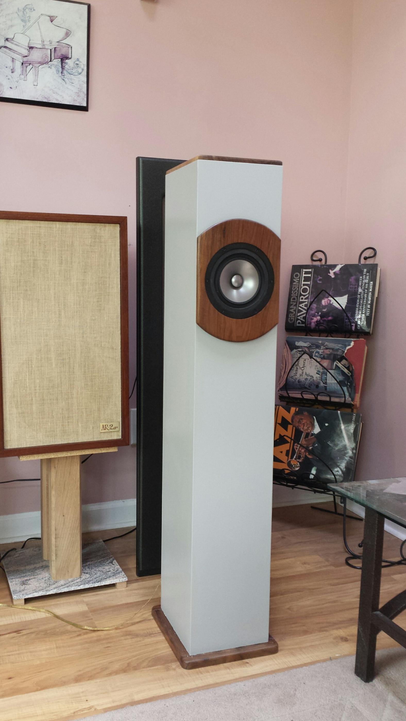

Now I should have pointed out that you can trade width of the cabinet for depth of the enclosure if you are concerned about internal reflections. I modeled internal dimensions of 6" width x 7.5" depth or a cross-sectional area (CSA) of 45 sq. in. You could just as well select a 7.5" width and a 6" depth and have the same internal CSA.
With this in mind, could you also build a square speaker box as long as the CSA remained at 45 sq in.? ie. internal measurements of 6.7" x 6.7" (or 170mm x 170mm).
As mentioned in another current thread - unless sealed, the overall shape - i.e. the third dimension of an enclosure -and location of driver / ports can be very significant.
You'll probably note that many of the popular designs discussed have aspect ratios to their CSA that are not square.
As long as you maintain the CSA you can vary the depth or width dimensions for this design. Now you do have specific limits--baffle width is a function of the outside diameter of the driver or the internal clearance for the driver--and such to consider.
Hence, a square internal CSA (6.7 x 6.7 inches) would be OK.
Tyler, I did not specify the aspect ratio in this design. I wanted to give the builder latitude to build per his needs/desires. Given the size of the driver, you have some ability to make your own choice of baffle width vs. cabinet width.
A specified baffle width would have locked down the cabinet depth. But some people like the looks of a wide cabinet and would trade width for depth while others prefer a squarer look.
Thanks for your interest in this design.

My design is a MLTL per Martin King's spread sheets. It uses the T/S parameters of the MA Alpair 10.3 and the simulation iterates the position of the driver and port within the enclosure to optimize the bass frequency response.
Thus, while a MLTL may appear to be just an ordinary vented design, the location of the driver and port, the length between the two, the port diameter, cross-section of the box and the stuffing are design elements which enhance the bass.

My mltl 10.3 are now well broken in, I assume, but they seem to have developed a harshness when playing complex passages. The bass performance is superior for a driver this size and single acoustic instruments, small combo jazz, for example are great.
But on more than one occasion I find I have to turn the volume down due to being quite irritating, edgy, harsh.
My long term reference for all my speaker building adventures has been my Apogee Centaurs, bought in 1991 and known for their silky smoothness and overstuffed bass(less) performance.
Now, I don't expect any speaker that I build to be the equal of the Centaur, pro or con, but I do like them to be highly musical and listenable, and I have achieved these goals with most of my builds, but not these mltl, yet.
Andrew bee, or anyone else have experience, pro or con with this driver or this cabinet?
Comments will be most welcome.
Peter

Well, I have added another 100 hours or so of realistic listening level to the speakers and the harshness seems to be mitigating. I also found that, whereas previously I had the speakers positioned into the room about 3 ft from the front wall, I tried different locations and found that about 4 to 6" from the wall gives a much better balance. My mltl are rear ported.
My other speakers include Finalists and Apogee Centaurs, both of which require a good distance behind them to sound remotely acceptable, in my room.
Thanks again, Jim.
Peter
