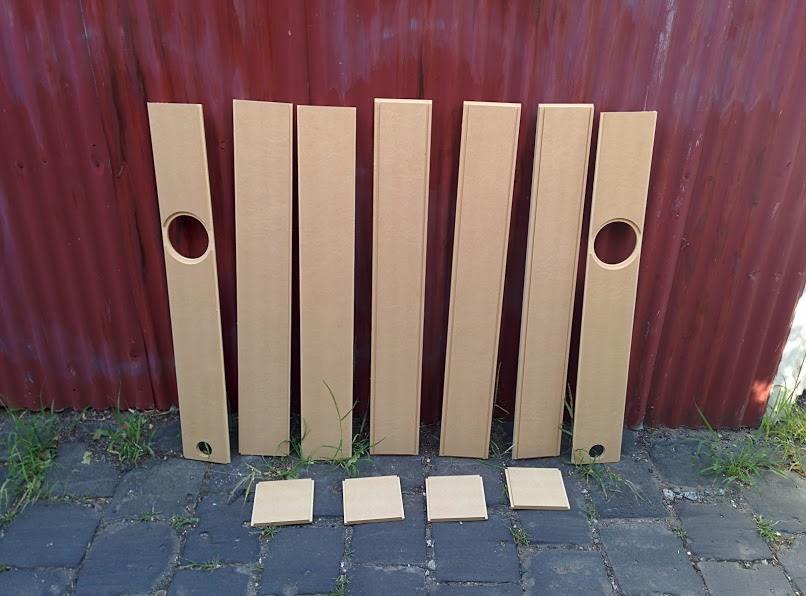

Sorry I forgot to post this.
I created a pair of these speakers based on Jim's design.
This was my first speaker build!

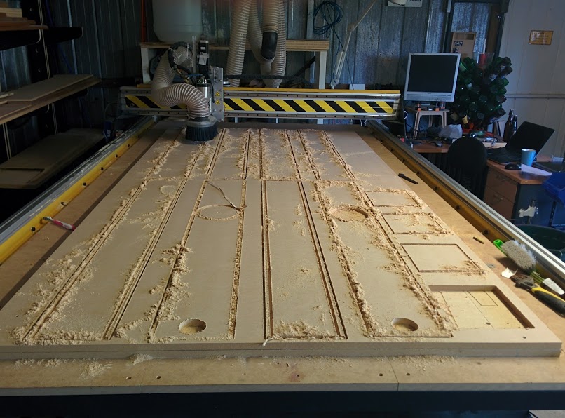

I used a CNC router to machine the parts out of 12mm mdf.
I included a tongue and groove style so they fitted neatly together.
The final cuts are a consequence of the internal dimensions of Jim's plans.
I used dacron for the stuffing, packed tight in the top, looser in the bottom.
I used Alpair 10.2 because I had some laying around from a previous failed project.
I have some nice Jarrah to face the next pair with....might get to that someday.

Have you put a stethoscope to the cabinet walls? 12mm mdf is like using 9mm quality ply and i'd think that might be a bit thin for such a large cabinet.

Understood...It was my first speaker build so I was lacking such knowledge.

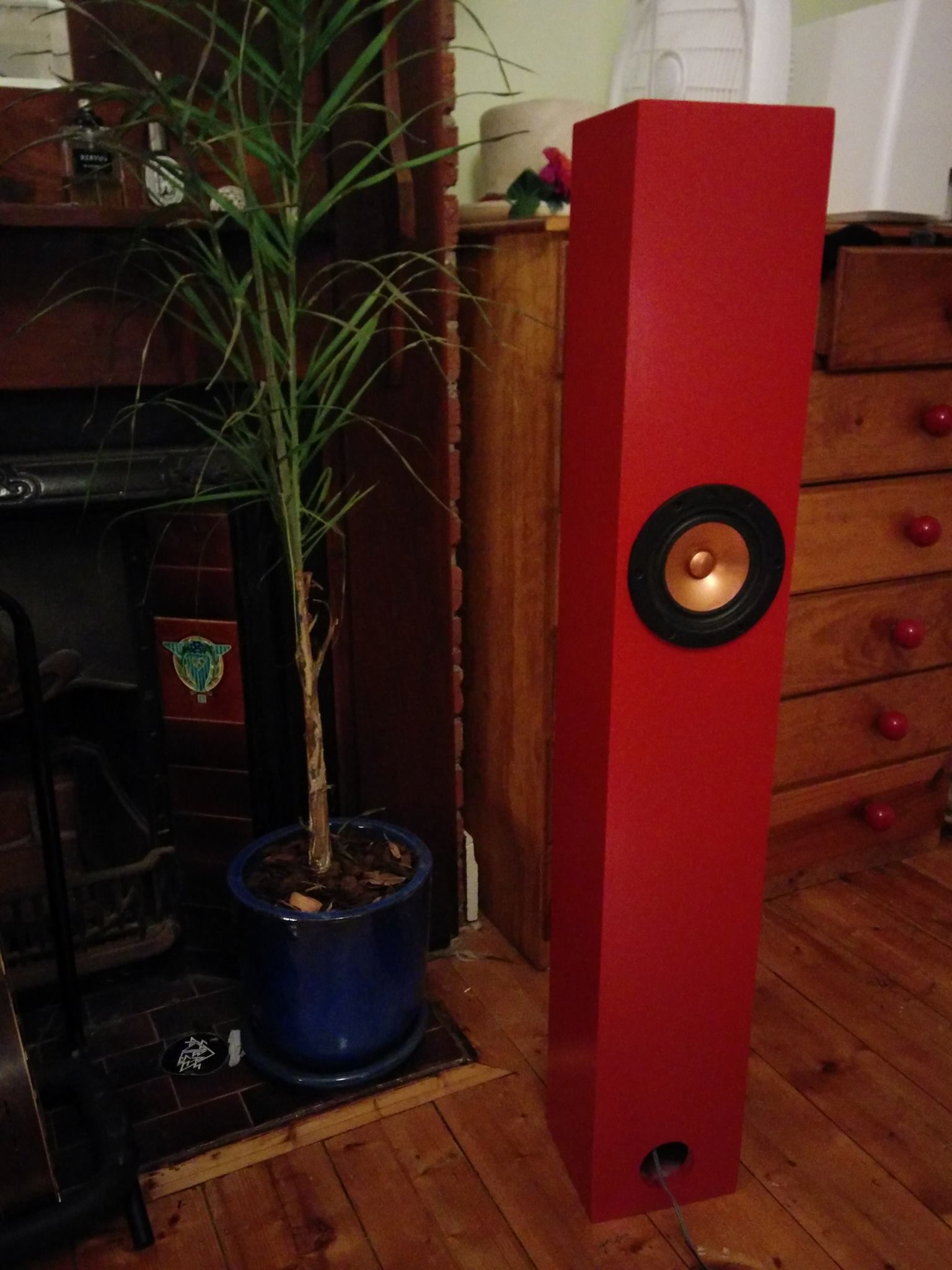

Subjectively, they are awesome. Deep bass. I used a 25 watt Class d amp.
You do have to sit in front of them as the alpairs have a tendancy to beam the tops. I have them in my bedroom pointing at the bed from the opposite corners of the room. Nice.

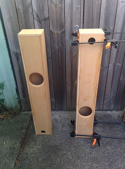

Hi Jim, I have gone ahead and ordered wood for the project. I am trying to source a port tube over here in Spain and having difficulties.
I am able to get a 2" flared port, 5 3/4" long. Is this acceptable or will it change the alignment too much?
Thanks!
Thanks!
Your 2" diameter flared tube is close so you could give it a try. Listen to the performance ascertain if you like the sound.
Other port tubes could be created from mailing tubes (typically cardboard) or pvc pipe. It don't have to be an expensive part from a supplier.
Rigid PVC plumbing pipe should also work fine.
For port diameter changes, the formula shared by P10 in the following link can help you with determining the length:
http://www.diyaudio.com/forums/full-range/282804-bass-reflex-port-shape.html#post4525003
Thanks Jim and Zman. Using the calculator from Planet10's post I get an adjusted length of 3,83" for the 2"diameter.
Up to what point can the ports be changed without affecting the performance that Jim has achieved? For example is converting port length to baffle thickness or 2xbaffle thickness too drastic? It would allow for a very convenient and quite small hole.
I will look around a few plumbing supply shops in the city but I'm not sure they have much in the way of inches. The closest may be 50mm or 60mm.
I have finally built the first cabinet (still waiting for a port tube). I bought some 1cm thick ceiling insulation tiles. Would top, back and one side (in the top half only) be a good starting point?
Thanks!
Thanks!

I'm sorry but you will have to experiment with the ceiling tiles. I have never used them and can not give you much help on thickness and such.
I really suggest the polyfill or Dacron filling (pillow stuffing) as it is similar to what I use. You need a volume filler for typical MLTL operation vs. a surface damping material like those ceiling tiles. l
