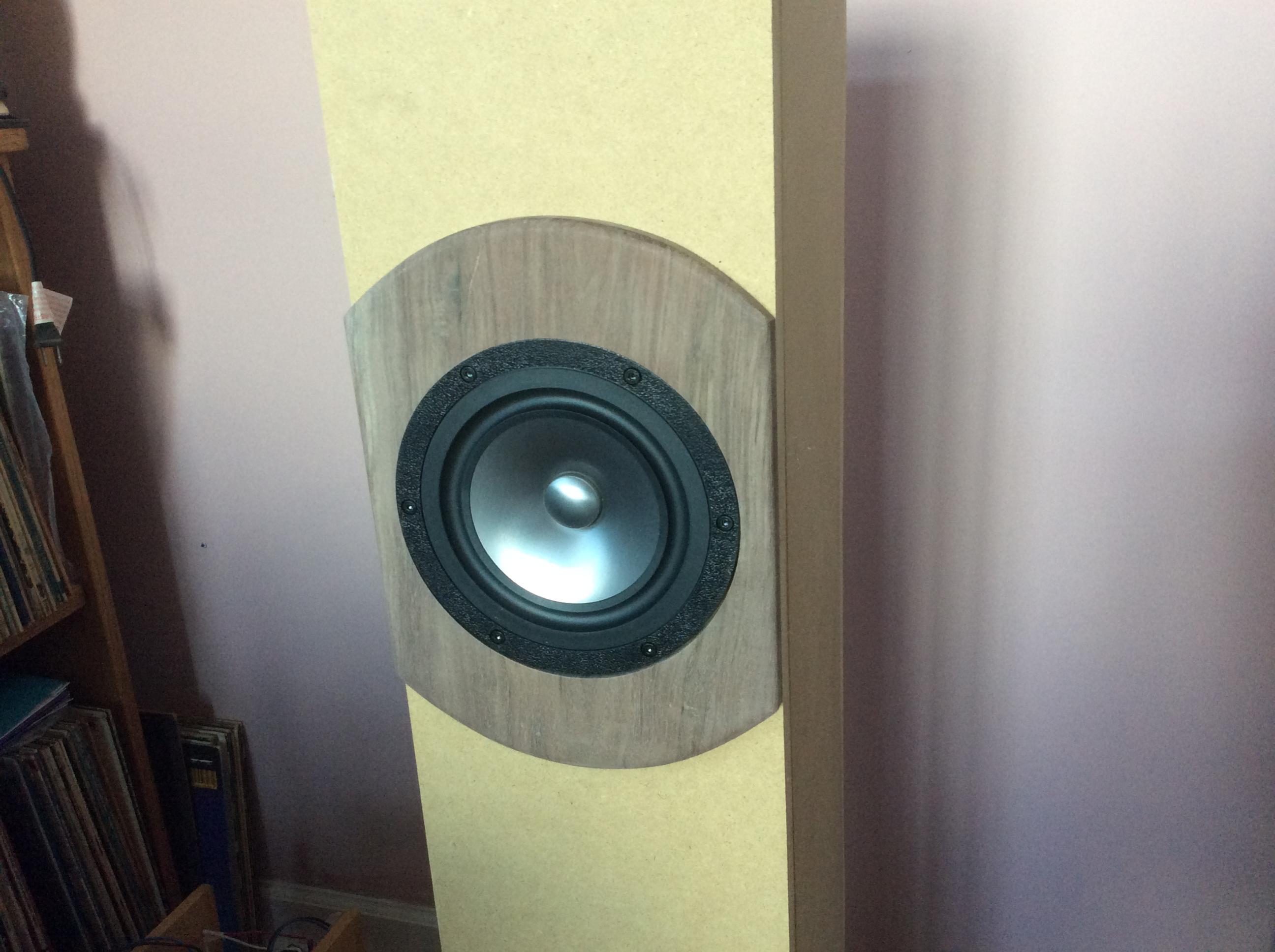

Musical heaven
I have just put together mdf cabinets for this mltl, and with 200-300 hours on the drivers, the results are quite stunning.
The 10.3s are surface mounted while they run in and I am about to make a couple of walnut "collars" to effectively flush mount the drivers. In the current configuration, these provide the flattest fr down to 40hz that I have experienced in my room.
There is a 2-3db bump above 2.5khz but not too troublesome.
The only bracing I used were two hardwood dowels across the longer sides 3" and 14" below the driver.
Thanks, Jim for making this available.
Cheers
Peter
Looking good Peter !
I like the "collar"
Is it Walnut?
You are well ahead of me. I just glued the front panel on my box yesterday.
I have only been at mine for a few months😀
Hopefully will get back to it this coming Saturday or Sunday.
Andrew

Andrew....
Thanks.
Yes. Walnut. I have them just sitting in place right now. When I get over the initial euphoria, I will paint or veneer the cabinets. Haven't decided which, yet.
When your's are finished they are sure to put a huge smile on your face.
Peter
Thanks.
Peter
Thanks, zman01.
Maybe it's wishful thinking, but I believe the focus and highs are improved with the collars in place.
These things really sing.

PJ,
Great to hear about your build and the excellent results. Those cabinets are outstanding.
Jim
