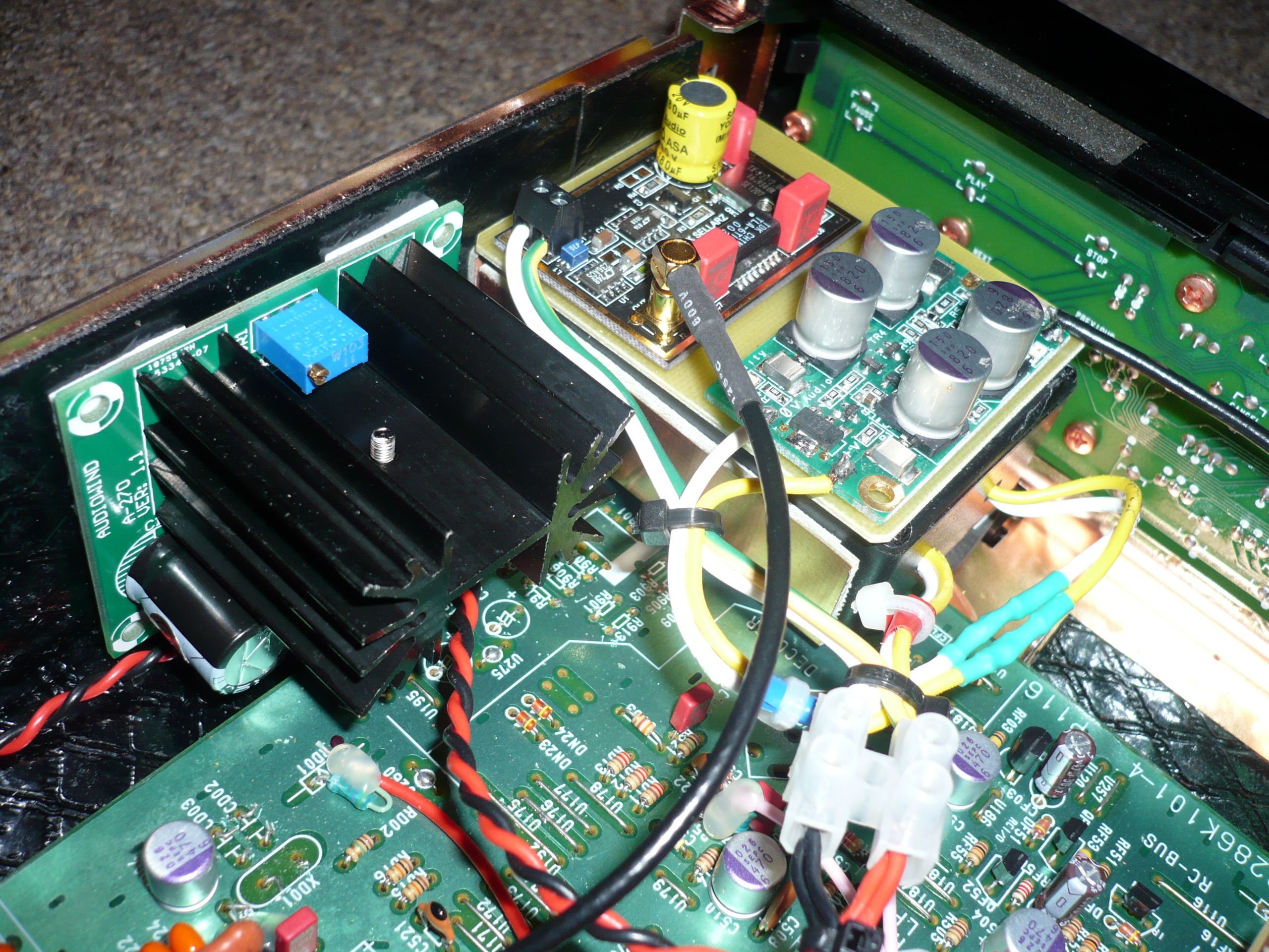

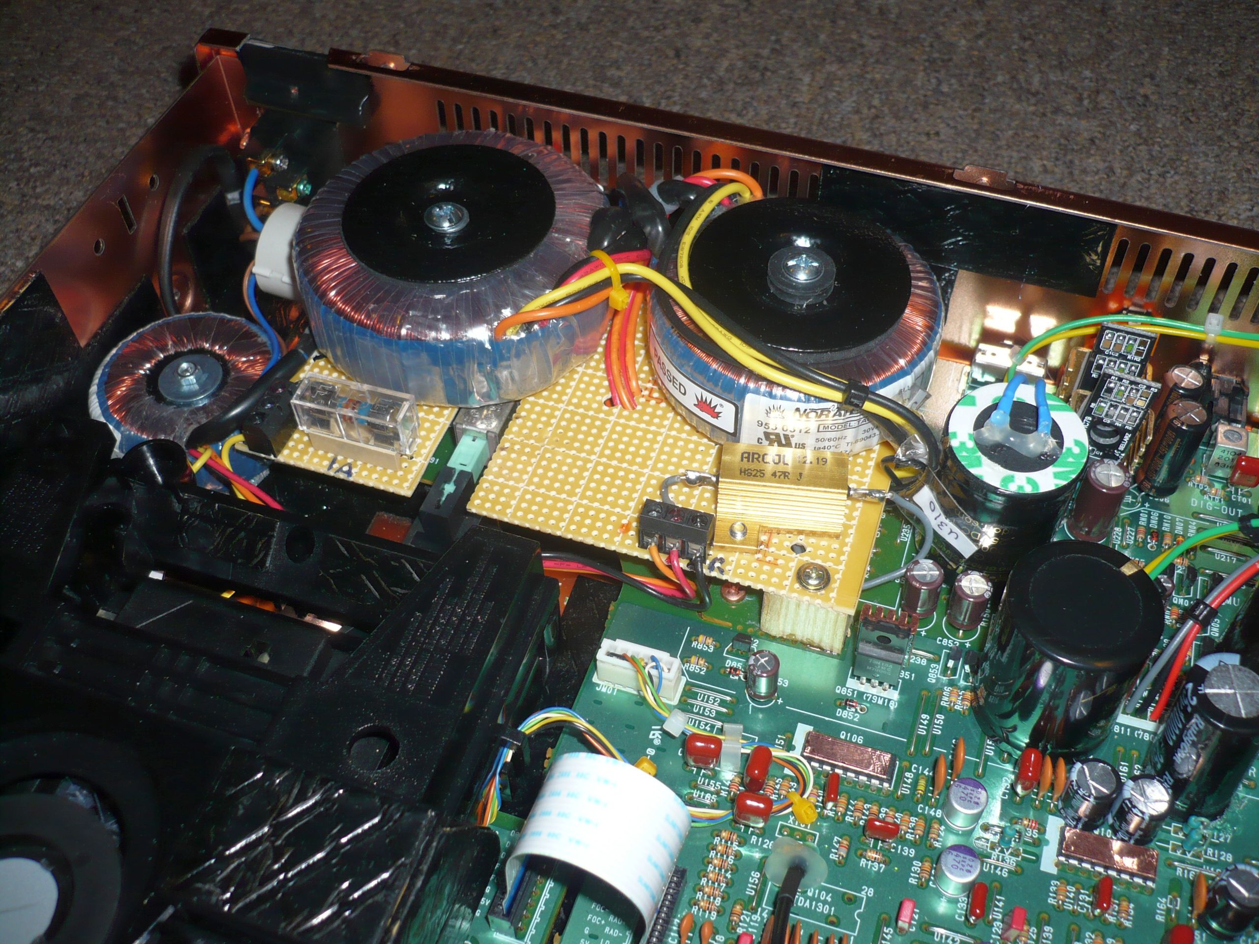

another successful CD63 mod
Have been away from this forum for some time busy in carrying out modding my CD63 MKII KI. Now the project has been completed with great success and here are a few photos showing the work that I have done.
My next project will be modding another CD63 SE :p
