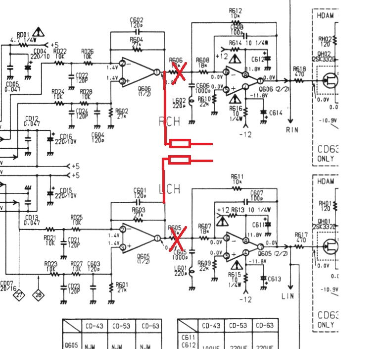

I have an idea in mind to simplify the flow of audio signal. I plan to test and just use the output from the first half of the opamp and connect it to the RCA out. I hope with such a simple circuit the music will have less coloration. Any comment on this approach, please ? I have an un-modded 63SE on my bench and I will have a try and see the difference.
Basically, you are bypassing a large section of the analog low-pass filter with this mod. That means lots of high-frequency noise from the DAC can enter your system. This is not a good thing, but the effect of it may vary from system to system. Some have reported a better sound because the extra opamp stage is bypassed, but it can also get worse and cause more distortion. So YMMV... and watch your tweeters!
Ray
