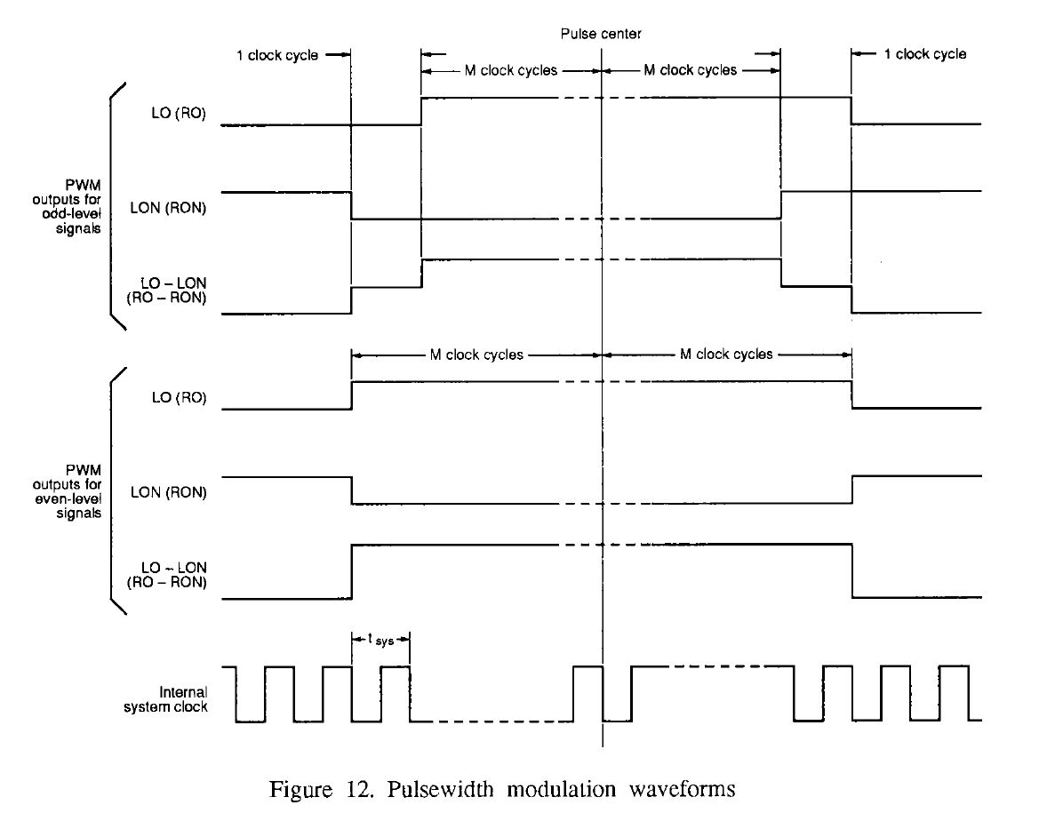

All those low-noise regulators will not help against the high-frequency square wave that is output by the DAC itself... it's the nature of the beast, so to speak.
The analog filter is needed to create a sinewave shaped signal out of this pulse-width modulated output, because it's nowhere near analog. If you bypass the filter, all kinds of higher-order harmonics will enter the system and this will create all sorts of distortion and intermodulation products. Not good...
But, depending on the system, you may or may not hear the negative side-effects of this.
