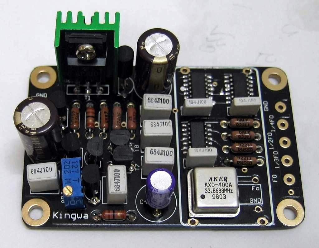

Hi boys,
remeber my sold CD53 went back home faulty?
remeber there was no focus, then replaced the factory Xtal to servo and fixed it, the error 10?
Guess what, I've totally removed the AudioGD clock and the 16mHz clock got in its place: music!
I'll report the anwser of AudioGD about this issue...

Nice one, to have a pissed-off seller because of this...
It looks cheap, and probably sounds cheap too. I bet it's just a standard oscillator can.
Matthieu, you can have my last Flea PCB for free, to get you out of this misery!
Hi Ray,
the good point, beside price, is that it can -when it works- drive the Servo also... but when it works...
And I welcome your offer very much, I have spare parts from my ... 4th Flea! OMG for a guy who was asking "what's resistors few years ago I think you gave me that kind of DIY plague
I'm a bit ashamed I have nothing I can think of to offer to you guys
Simon, defo better with that twin reclock than standard, I thought it was... efficient!
