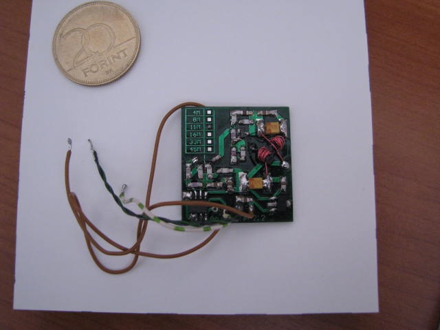

Please help me! For my previous question you recommend me a servo clock for my CD63SE. I try to find this forum what is it, but don't found assessed info for me. Can anyone write me some info about servo clocking? Need stay the normal external master clock in my unit and to the side need a servo clock? have you some schematic where need connect?
Thanks for help, and sorry for bad english...

Remove X101 and R126 from the servo. Feed 8.46 Mhz into the right hand hole of X101 (looking from the front of pcb). That should be it

Yes best is to find another clock, more simple. What is your current clock, in case it has onboard /2 ?
Similar to this, hungarian product, made about 12 years ago.
Work with original crystall, not to difficult, but works fine. I want use my CD63SE as CD transport with Behringer SRC2496.
