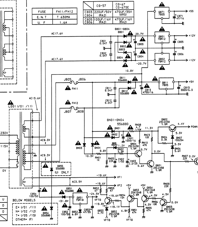

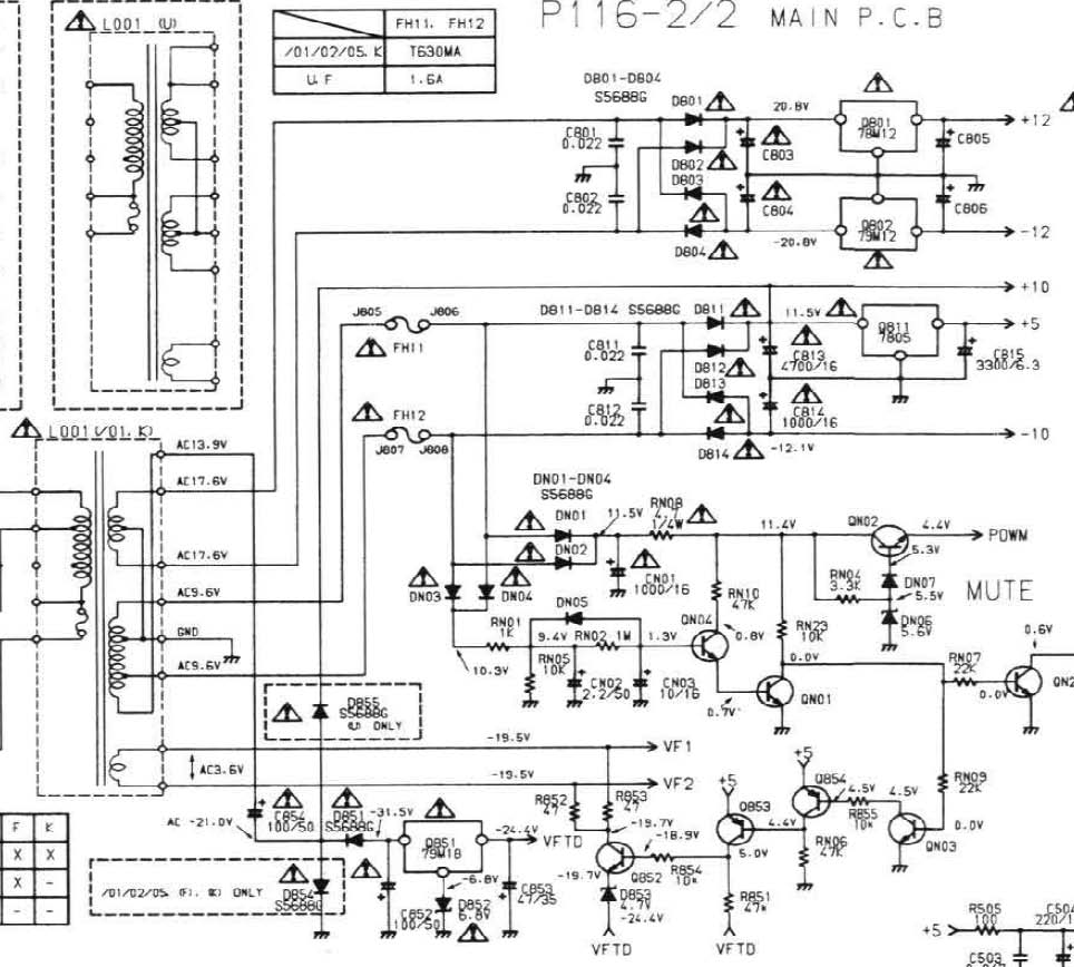

I am trying to modify the power supply of my CD transport Audiomeca Mephisto 1 but I have no schematics. It is Philips CDM 9/44 based CD transport. It has Philips CD850 like power supply. I am trying to understand the schematic. Can somebody explain me the function of C854, D854 and D855 of Maranzt CD63/67?

These parts act as a voltage doubler. You may have noticed the input voltage is 13.6VAC, and from that the -31.8V for the display is created.

That voltage doubler works by the same principle, it's only a different setup. Two capacitors are charged, each one on one half of the sinewave cycle. By connecting them in series, double output voltage is obtained. The doubler in the player used one cap in series with the AC winding (C854) that is charged during one half of the cycle, and during the other half it appears in series with the AC winding and the voltage is lifted by the DC value present at that cap. The second cap C852 doesn't really take part in the doubling process, but is only charged with the resulting voltage, and diode D851 prevents it from flowing back into the doubler.
As for the servo supply, in a CD63 the servo voltages are unregulated, so serious gains can be made here. In a CD67, the supply is regulated with a 7805. Most of the standard regulators have fairly good load regulation (only 2...15mV voltage change for full load ON/OFF) and should be able to deal with the PWM driven motor current. The step response is improved drastically by adding a few uF of output capacity, so the 100uF or more in the player should provide plenty buffering.
I can imagine that in some cases the regulator can become unstable with large output caps, I have seen this several times now with the new ONSemi regulators (MC78xxCT series), the ones with the thin metal tab on the housing. An output cap over 100/220uF will make these things oscillate for sure. I have stopped using them and use the ones from ST or NSC now. In the race for smaller and smaller output caps they probably changed the circuit.
I never tried a passive supply based on a choke here, but it has the advantage that it is a very effective barrier for noise, and won't go berserk with large output caps. You should make sure that the output impedance is low enough when using a passive circuit (something that can be easily realized by feedback) or the cure may be worse than the problem.
